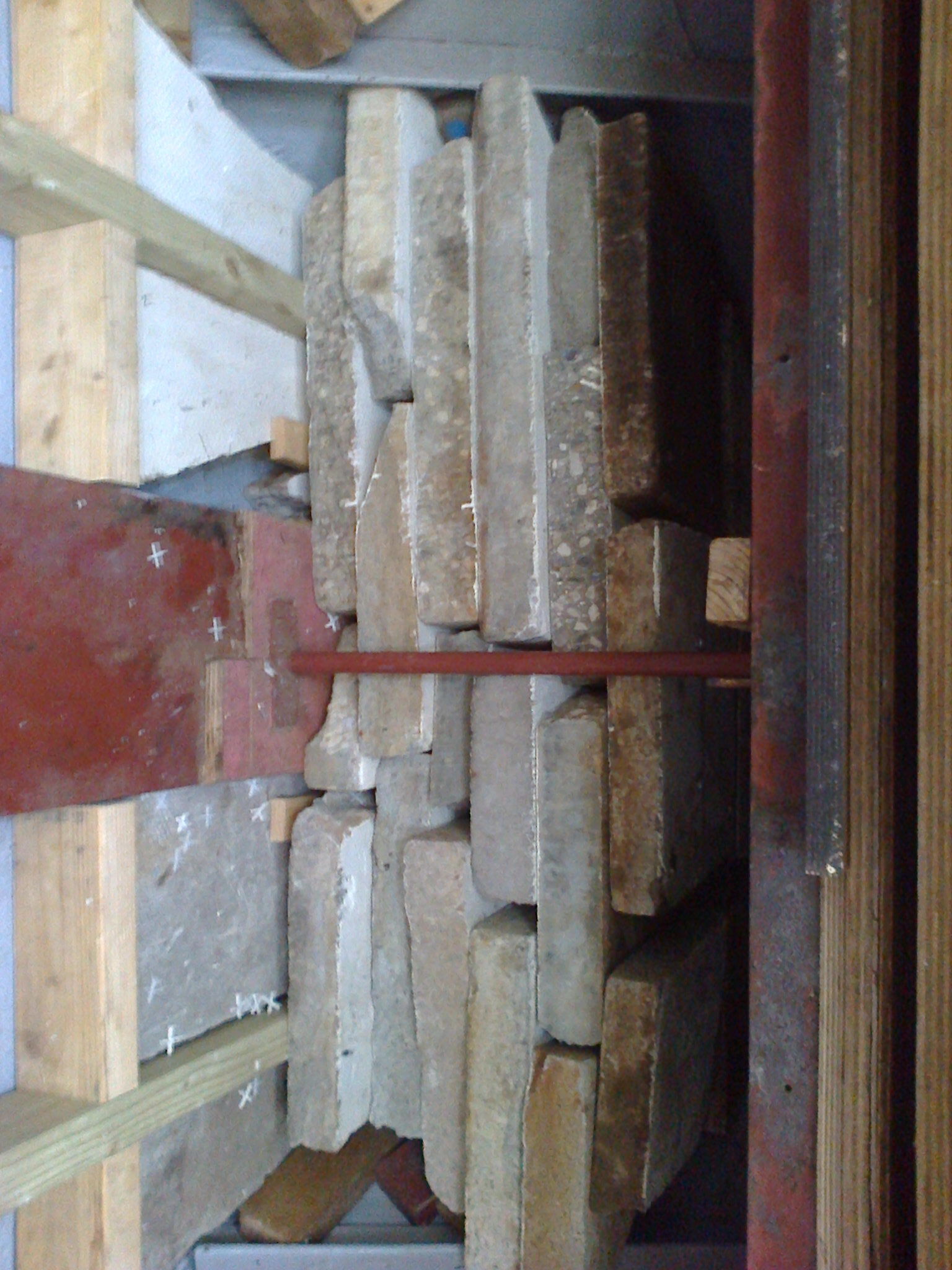

  2. The new ballast is all down on the baseplate. A lot of the pavers have been removed, and whats left has been taken up an shifted to fore and aft extremities of the boat - however, piled up to six layers high (on the baseplate). So I'll see how removing it changes things.
  3. Boats are going to rock, there's not too much you can do about that...it's just that mine feels more reactive to my weight than before, which was unexpected. Have you recently installed anything of significant mass above the waterline?
  4. Removing remnants of old pavers which now don't fit into the spaces between the new bearers, and added steel block ballast.
  5. Sorry, I was thinking of screws.
  6. I still have some of the old ballast (pavers) on board which I haven't yet removed, but...too much ballast? I'll see how it behaves when it's removed.
  7. I've just added ~1.47 metric tonnes of ballast to my boat, and while it's all nice and level, it feels more prone to rocking when i step on/off the gunwale. What should I do?

  14. I was really just wondering about the hull strength the ability to withstand uneven forces. My particular boat does have a steel hull and a keelson, and is only 40' in length so I do think it would withstand a fair load. No plans to destruction test it, though!
  15. ...and by 'unsupported', I mean when the boat is being craned out of the water. I was moving some old paving slabs out of the way for new ballast, and tucked a lot of it (about six layers) away under the foredeck. That's a fair old lump of weight. I was just wondering if anyone has a similar load in an extreme point of the boat (Aga? Extra large water tank?) and whether this is a concern when lifting out?

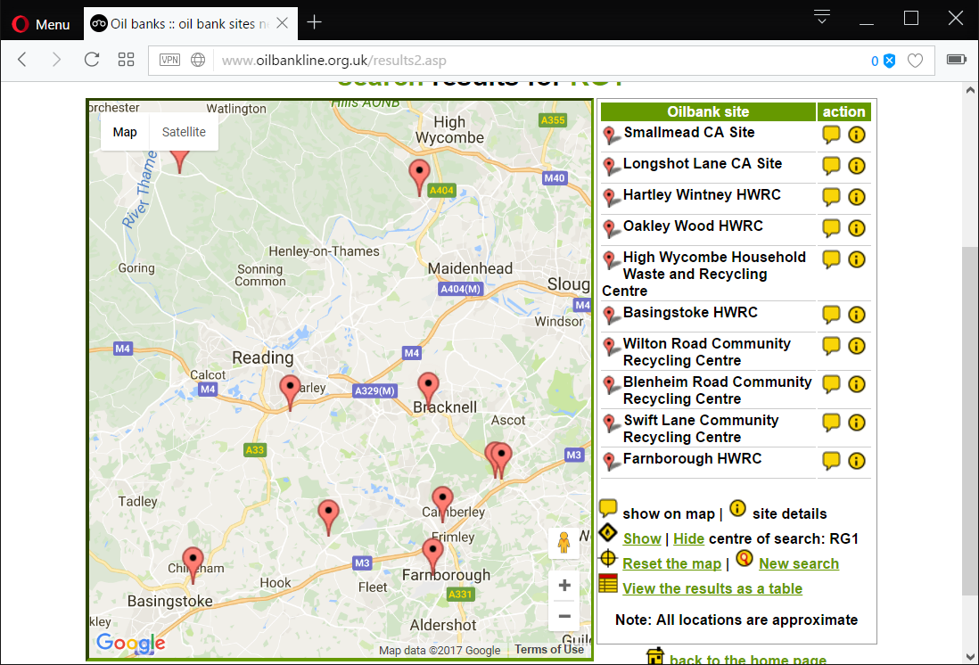

  22. near Reading...
  23. google 'oilbank'
