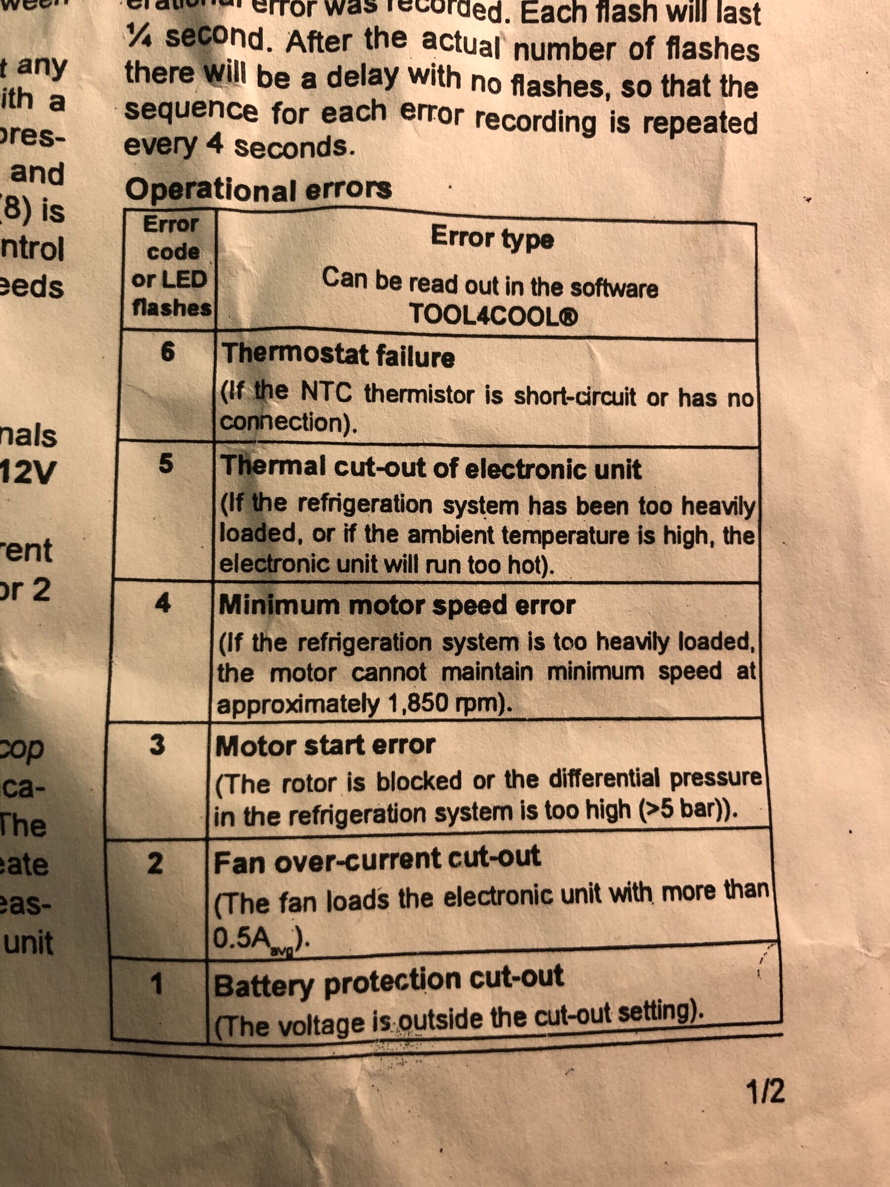

Thanks for the suggestions. I’ve taken out the fridge and put it directly next to the batteries and held the bare newly stripped wire against the terminals whilst it gets 30a of solar power at 13.5v going in and it still flashes. I’ve left it off for an hour and no luck. Was working fine overnight. Many thanks.
Hi all, long time no see. Been far too busy on other projects. Our 12v inlander fridge is flashing twice which according to the manual means the “fan is over current.” Yet we have no fan installed and there is nothing touching the fan terminal on the back of the fridge. No loose connections either and it’s getting a good voltage to the back. Any ideas? I’ve tried turning it off and on but no luck. many thanks.
