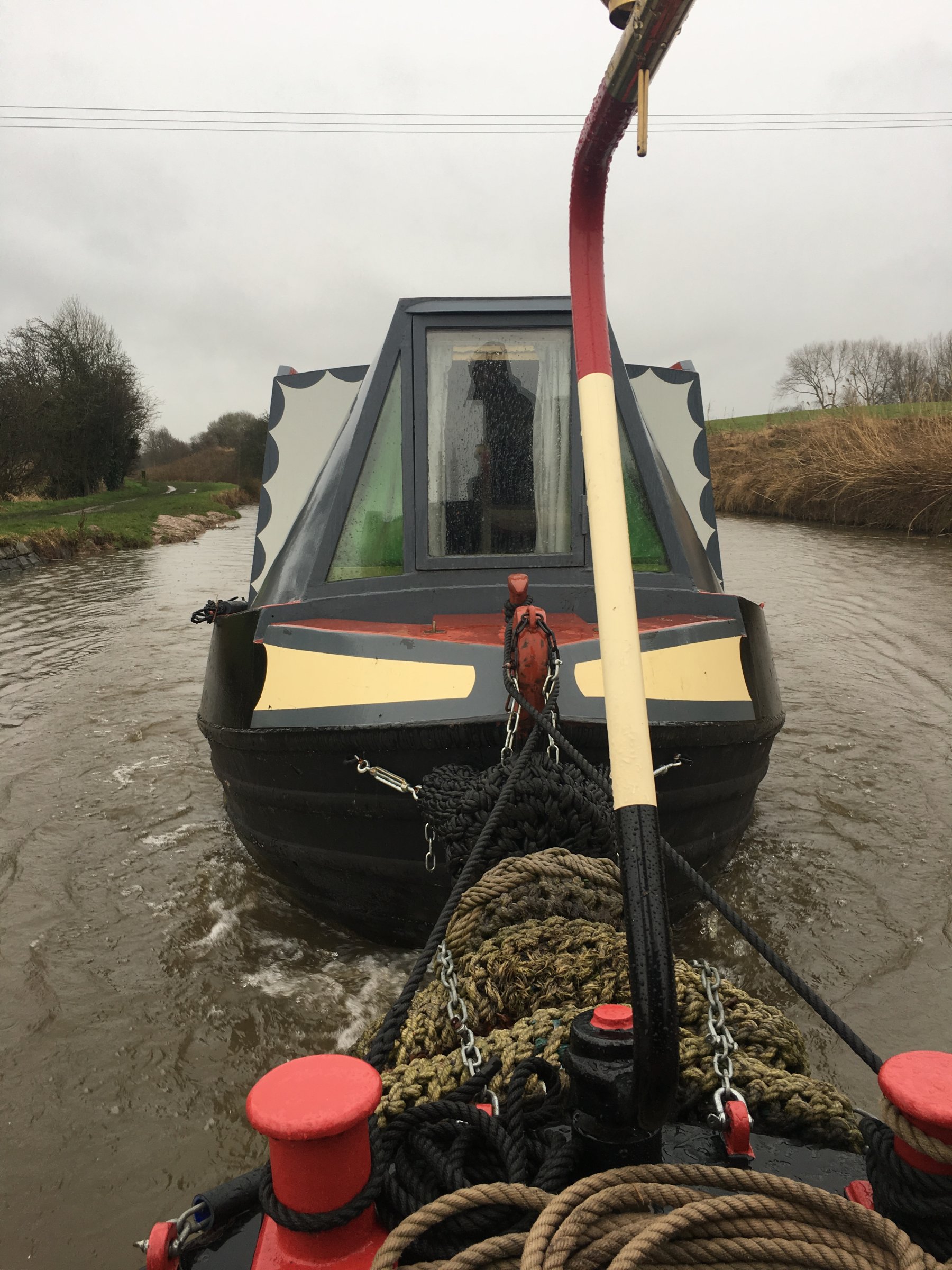

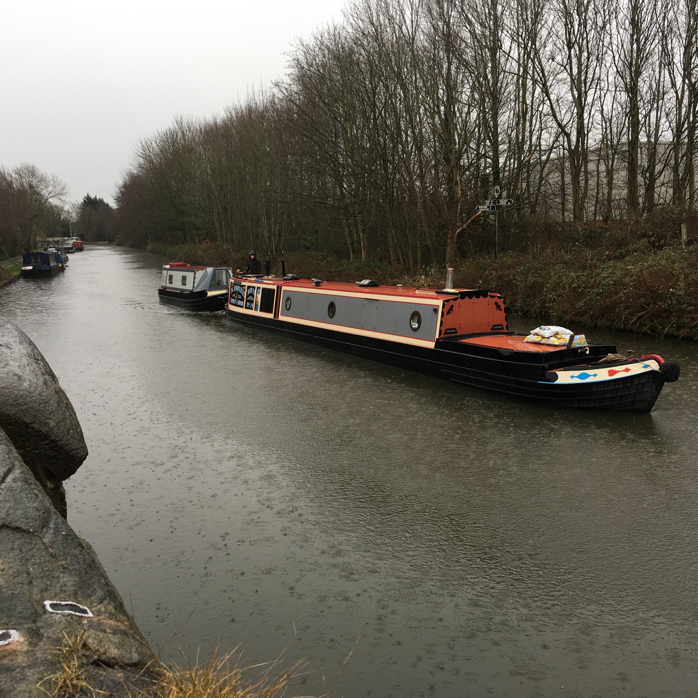

  18. We have a 30ft butty towed behind a 62ft motor. I use short cross straps and get them nice and tight. The tiller is tied straight with rope and she follows really well.
