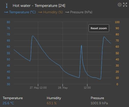

  2. My (horizontal, well-insulated) calorifier takes about 4 hours to drop by 10C starting from hot (70C), so it's usually warm enough in the morning -- depending on when the last genny/boiler run was, obviously...
