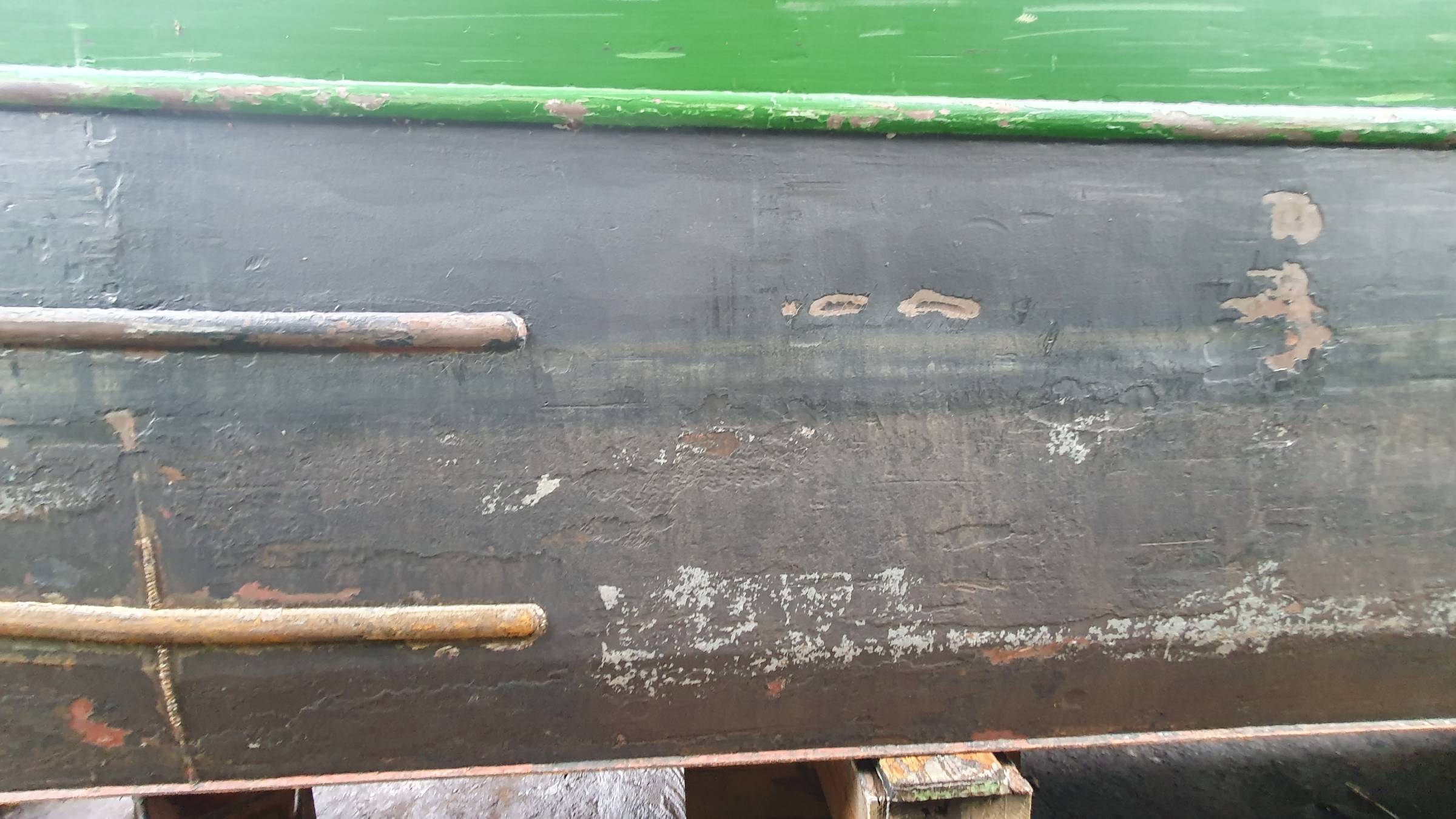

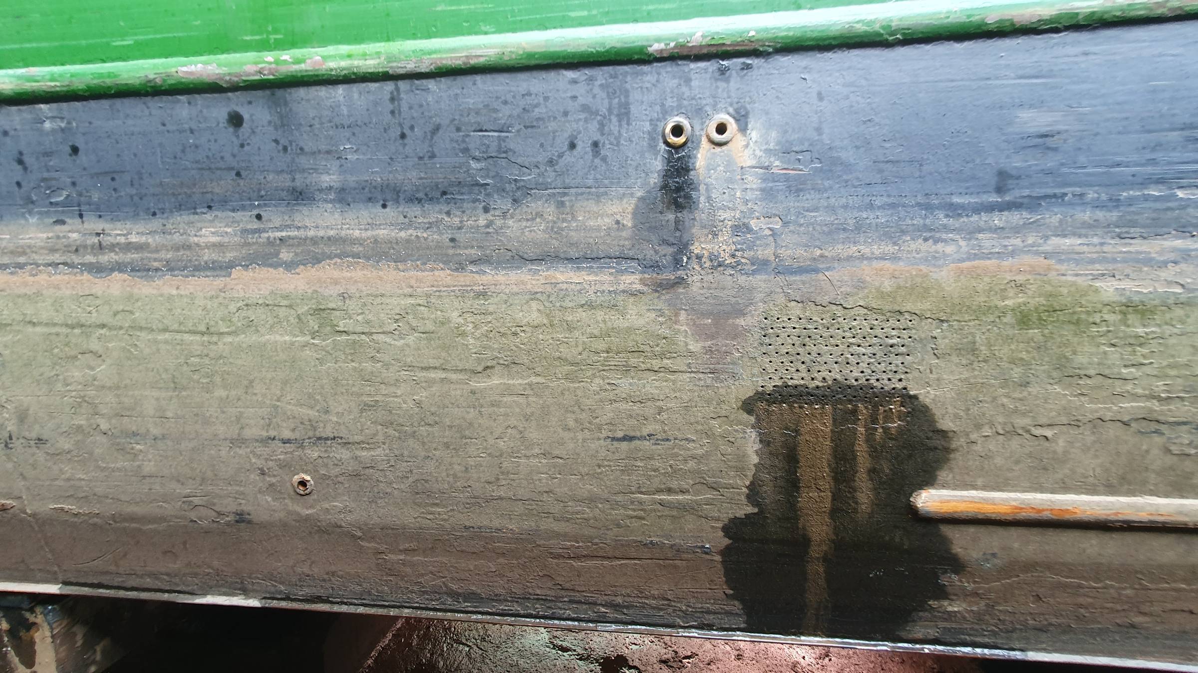

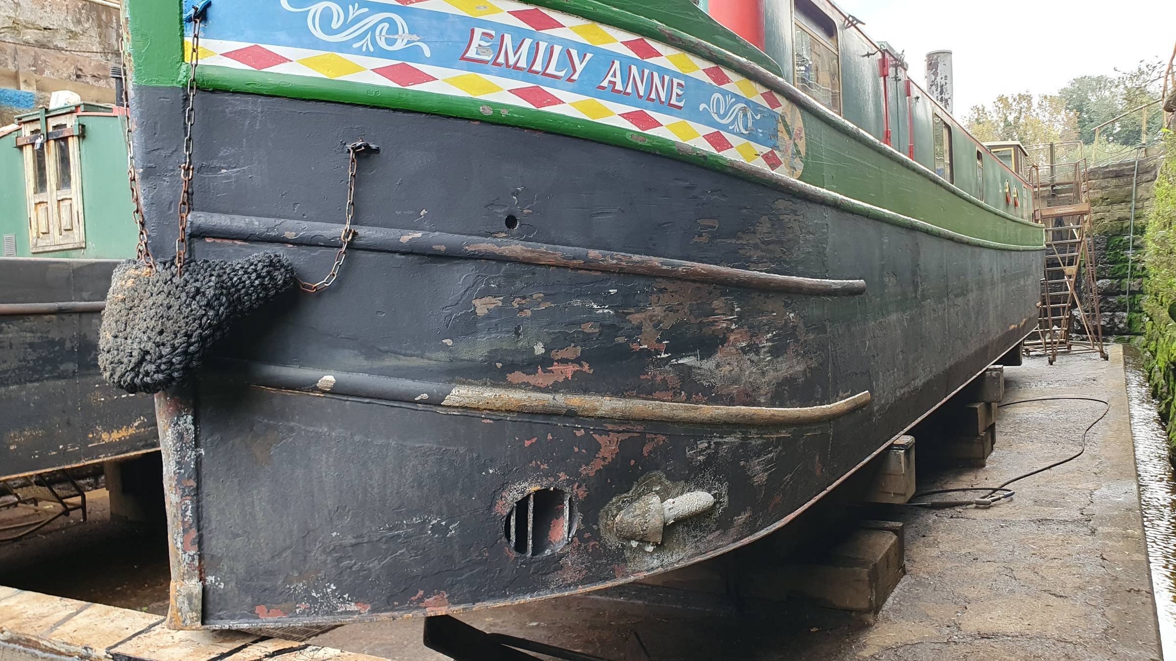

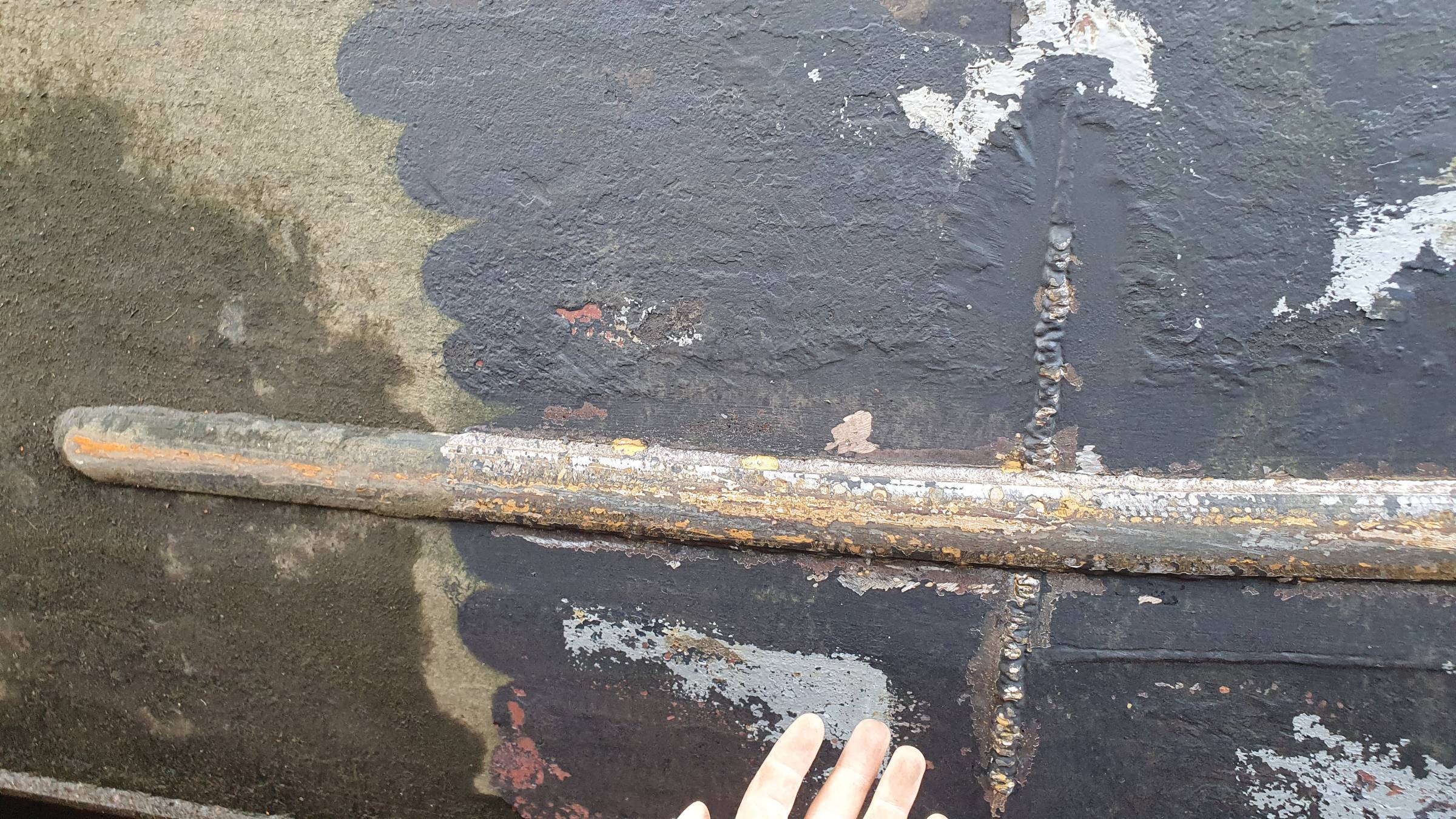

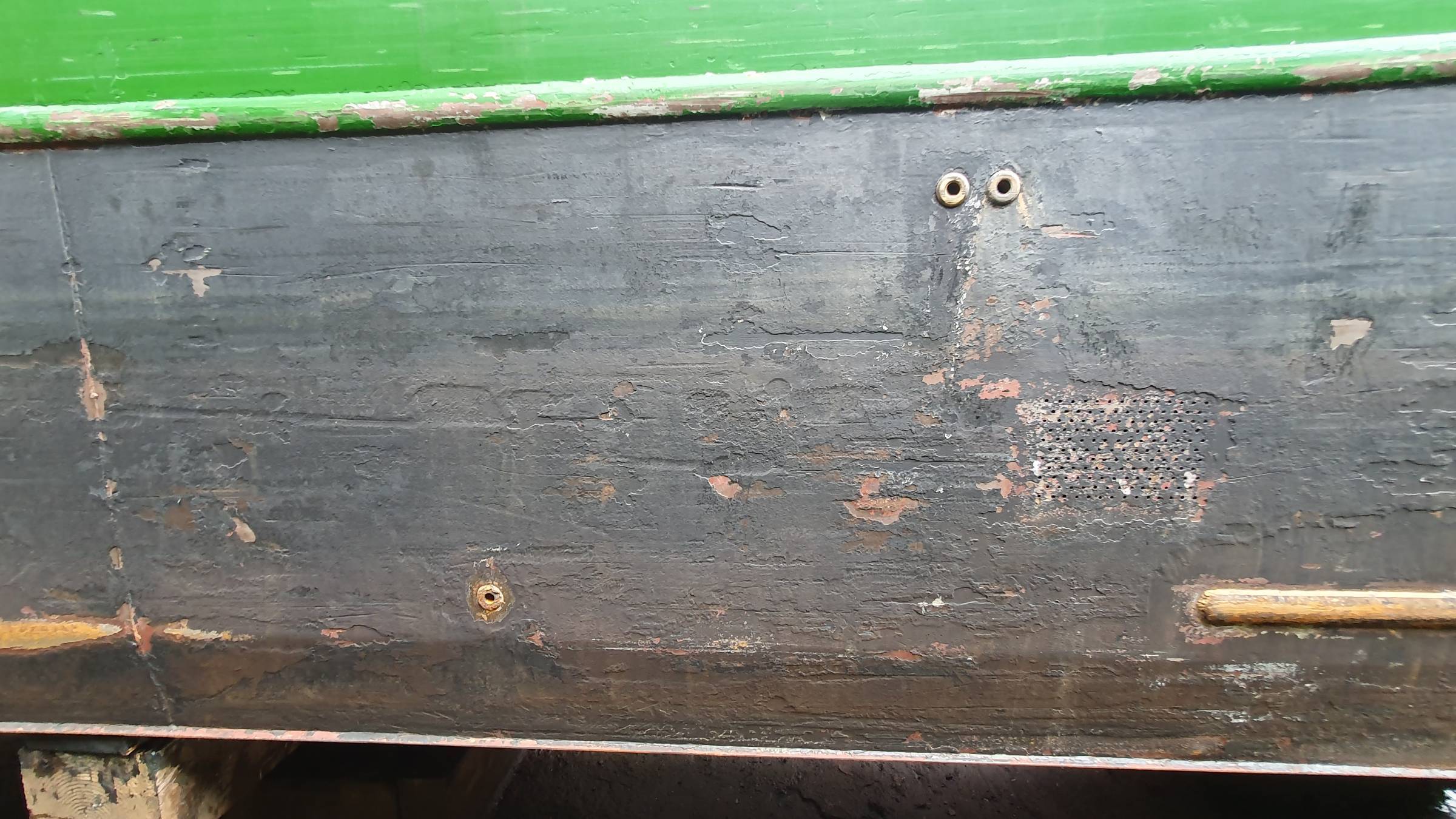

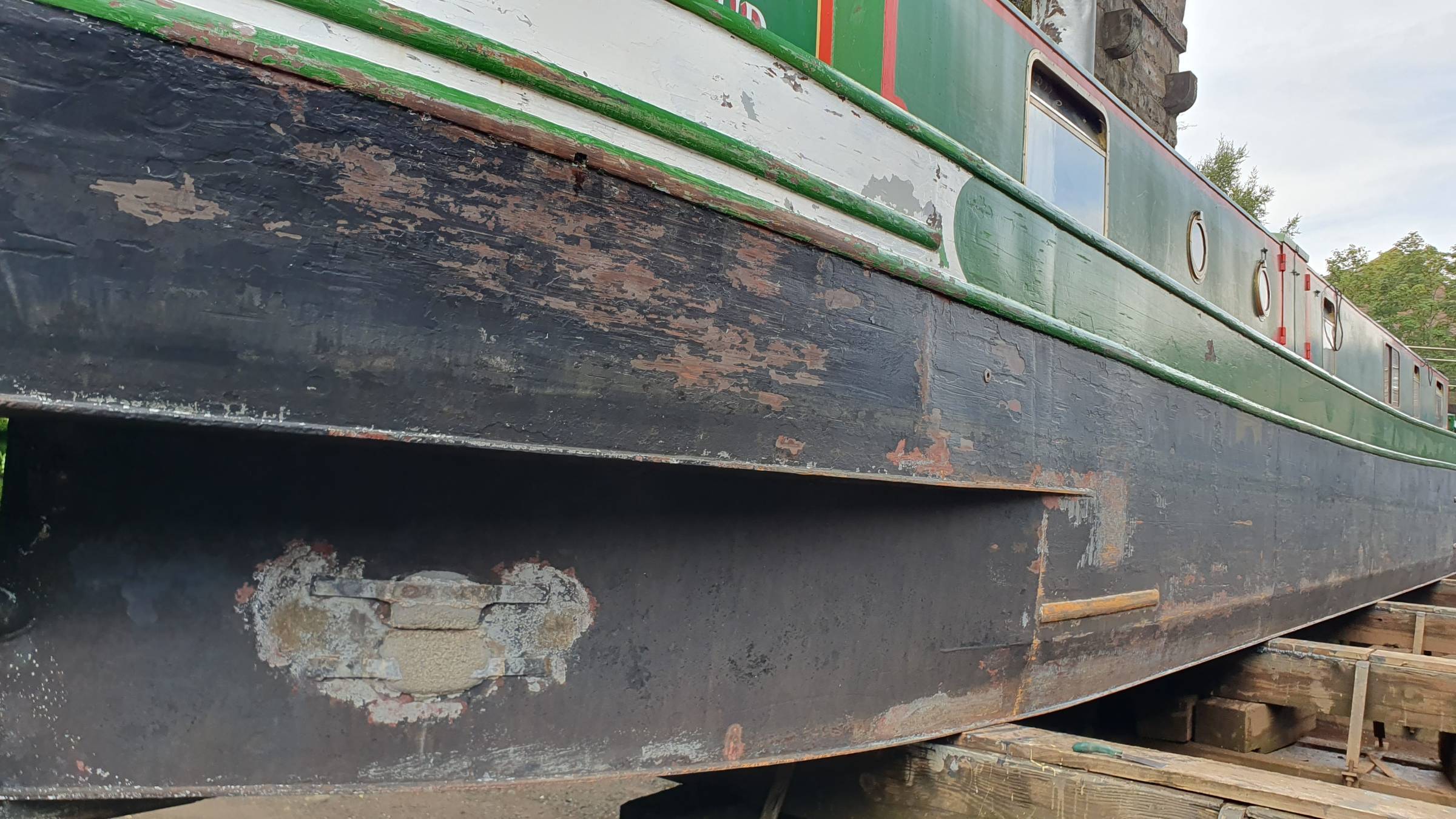

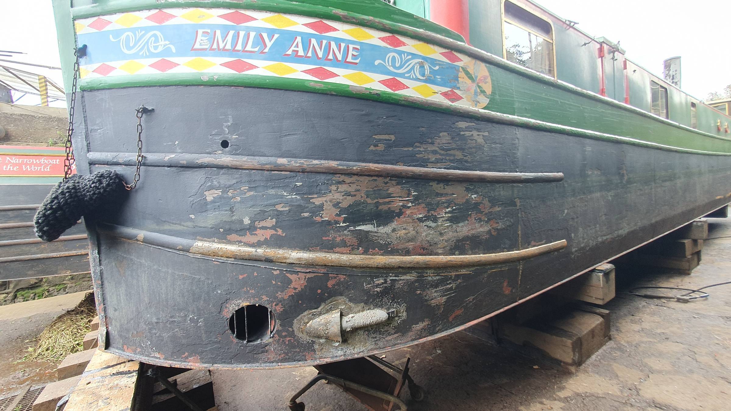

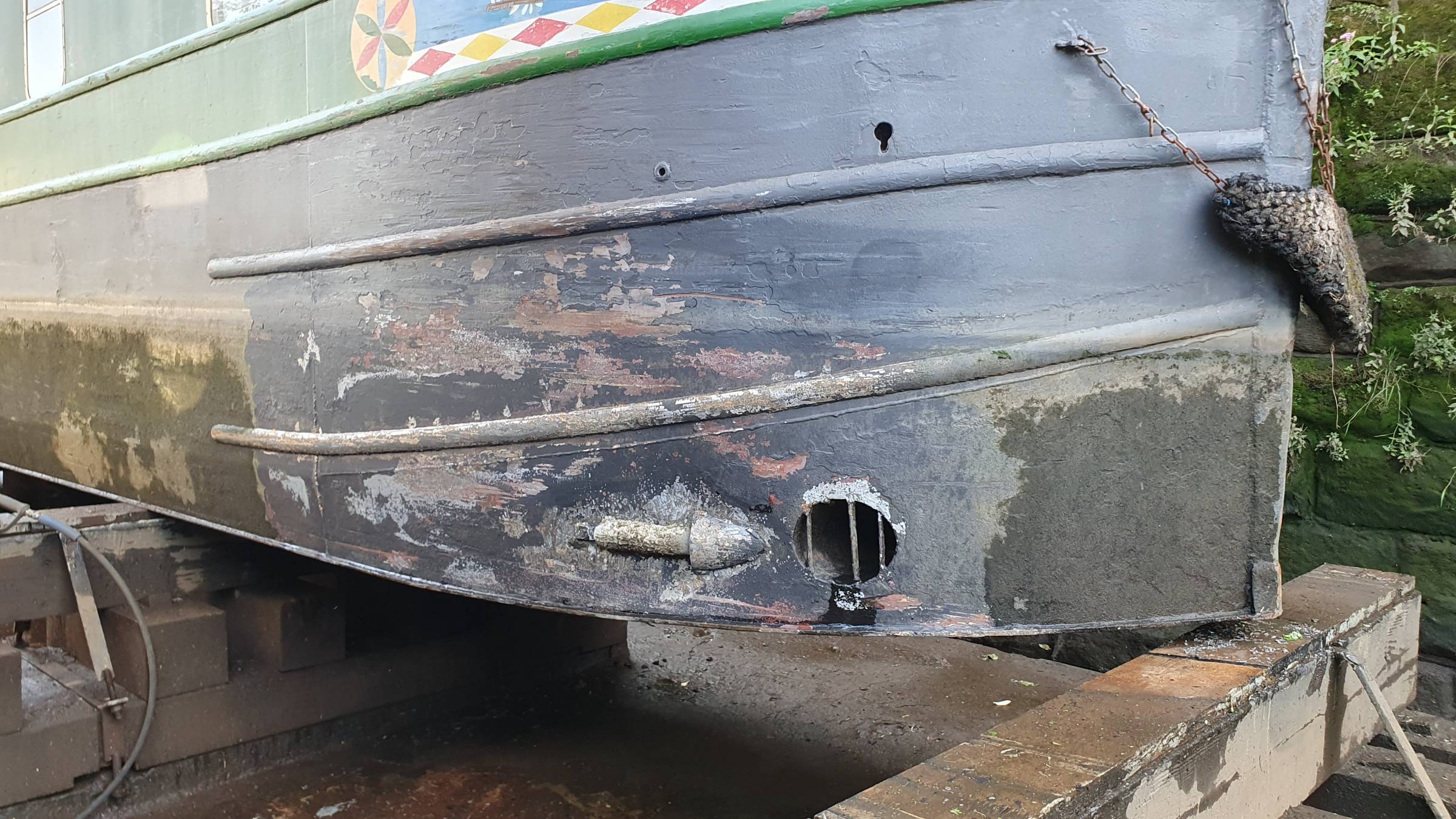

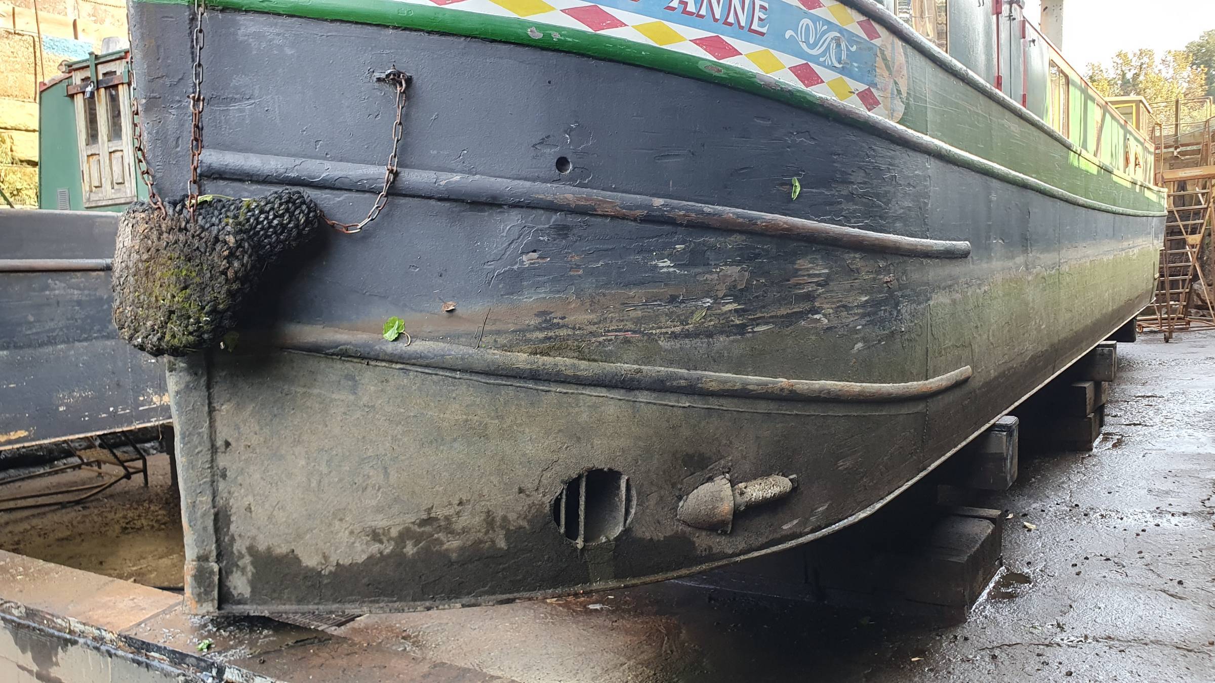

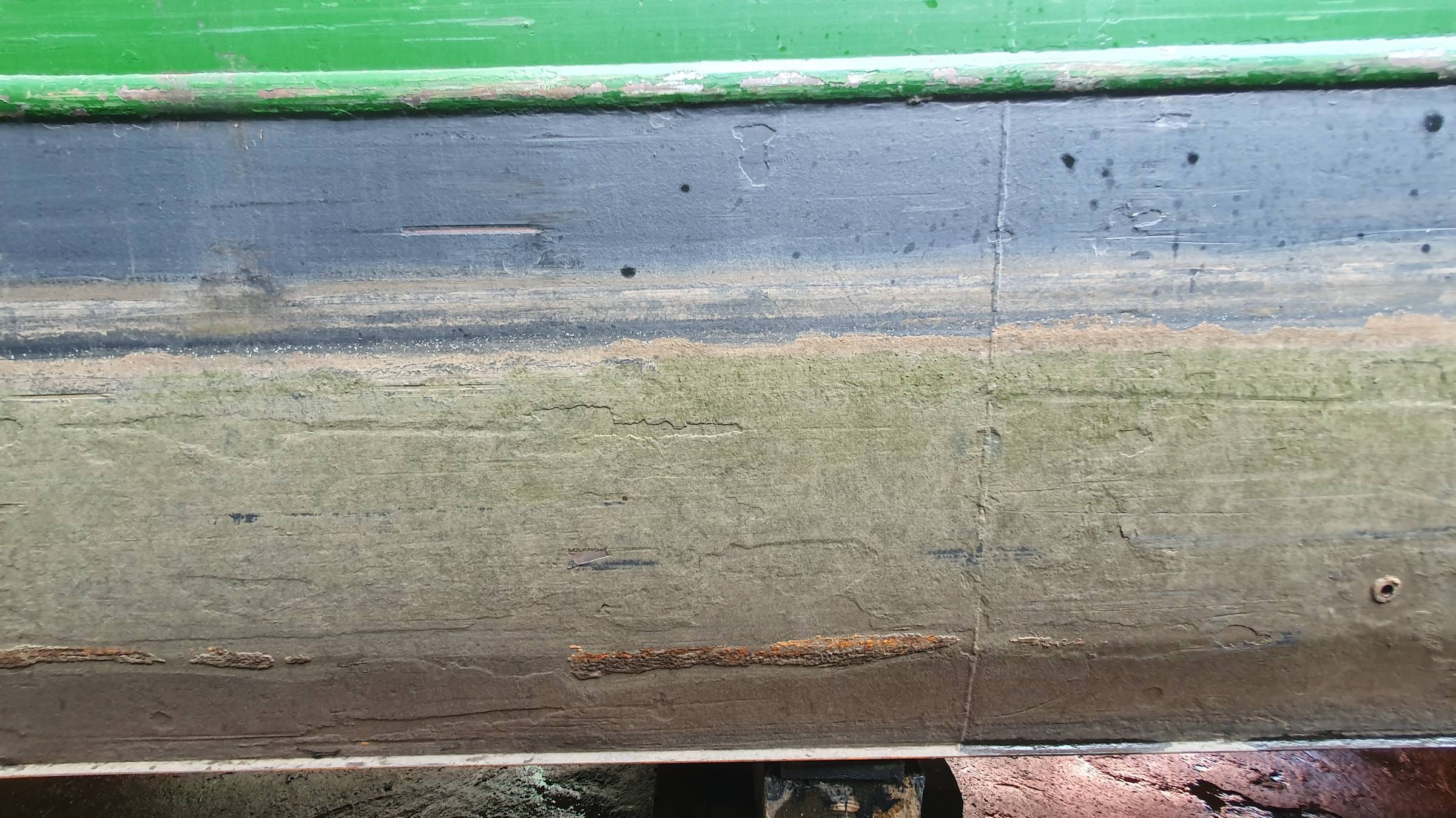

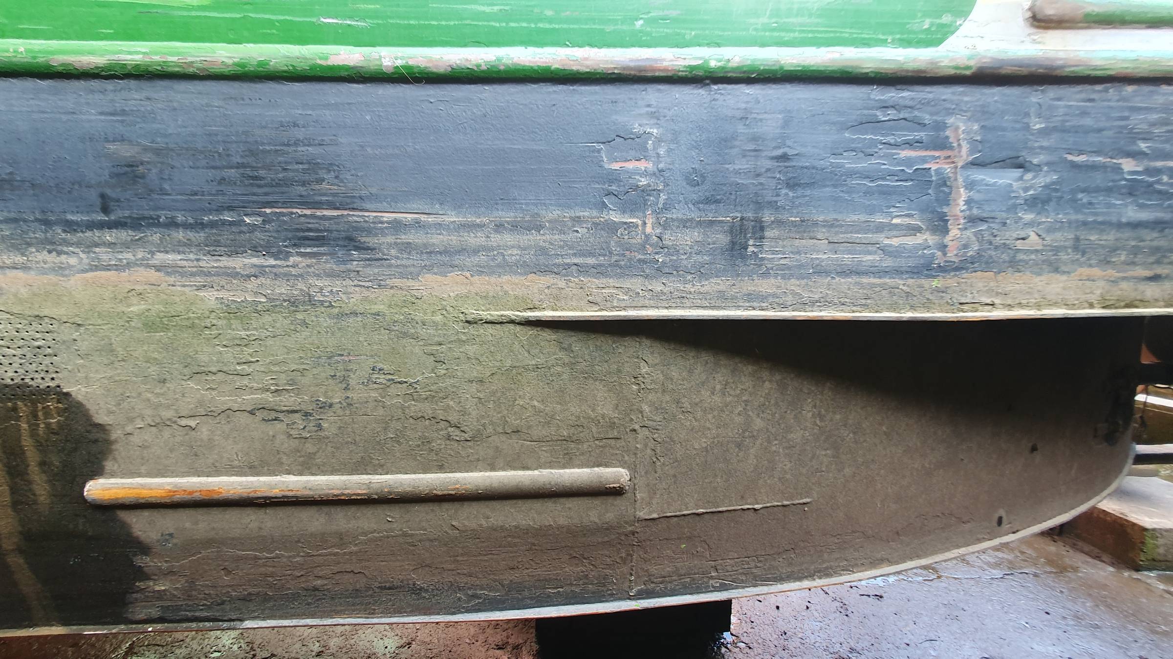

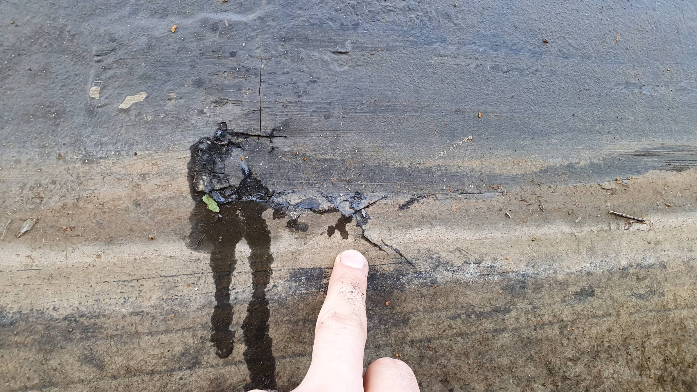

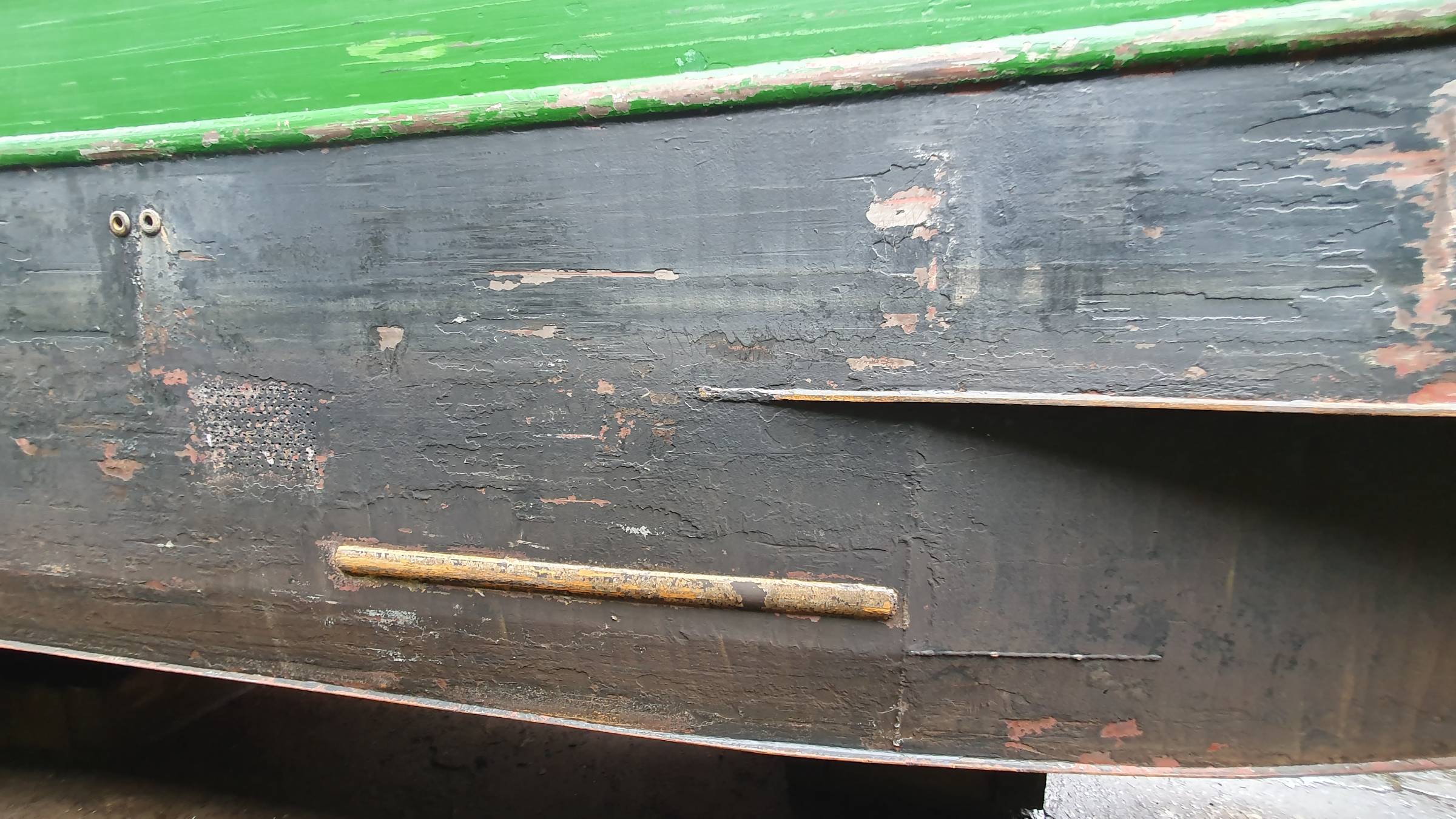

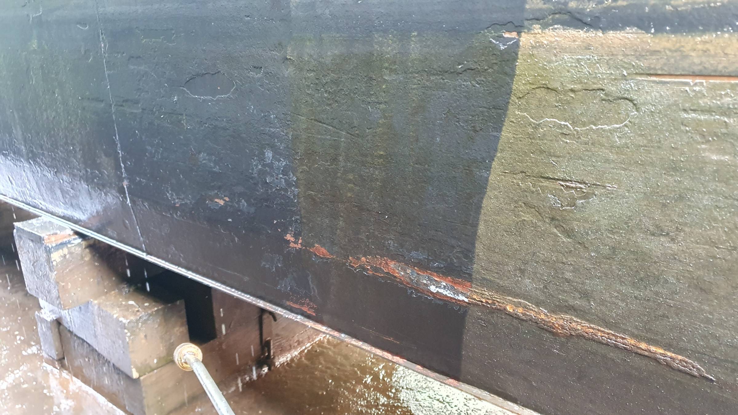

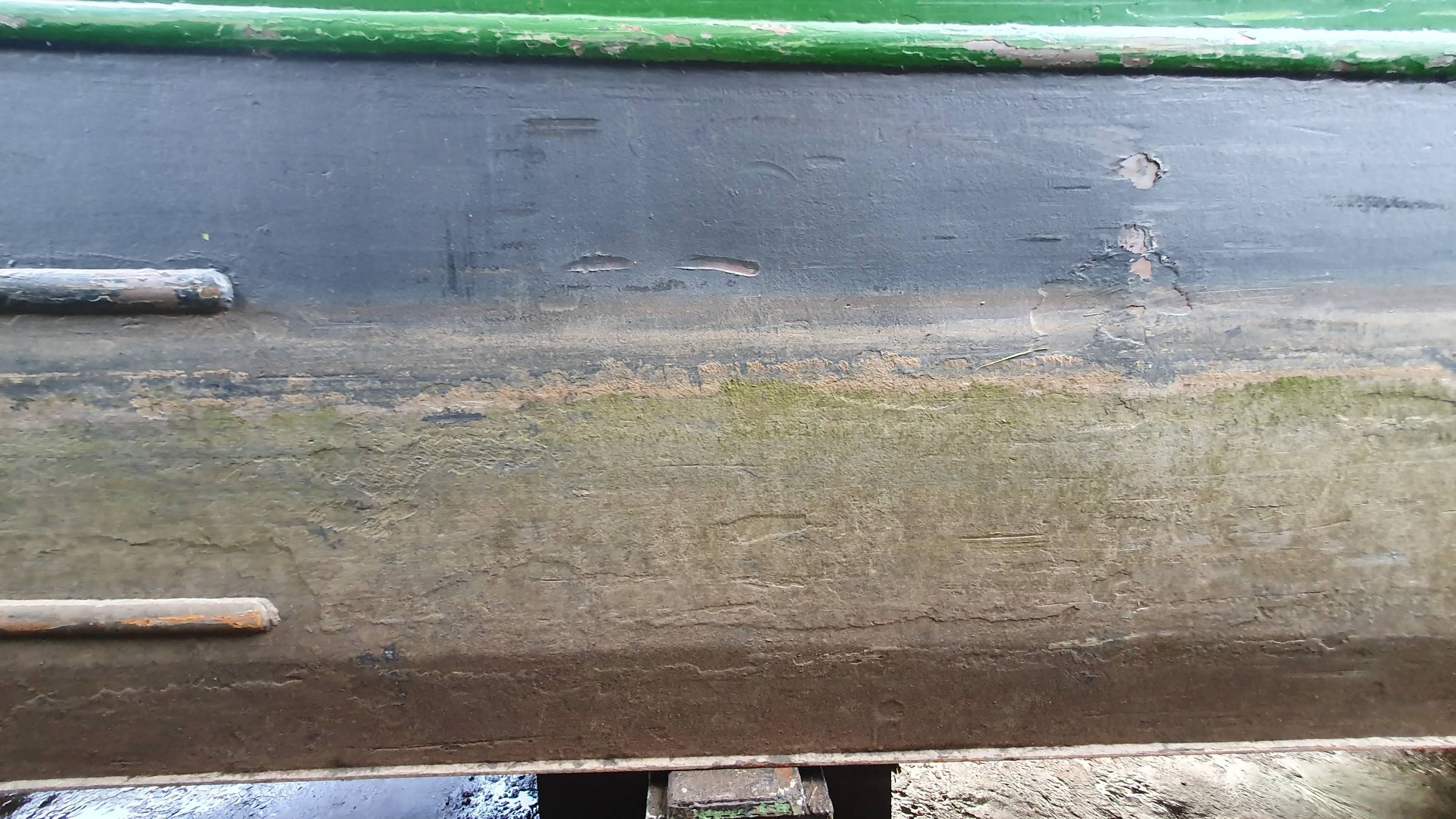

That's excellent really isn't it, I thought I had replied at the time, but have just been checking back to remind myself what we got upto this time last year. Fair play for consistently keeping a good coating on the boat for 30 years, not many manage that. Probably a thread in its own right, but if I get organised one day I will do a decent write up. In the meantime, here is smattering of the photos of the boat, both as it came out of the water, and just before we put the ali epoxy on last year, after hitting it with Northwich drydocks 15hp pressure washer, which will take even reasonably paint off, leaving the hull ready to directly recoat with little or no further prep. The boat is dry docked every four years which is the only time it comes out of the waterr, and covers a lot of miles and time on towpath moorings between dockings.

We're on a tangent, but I would be slightly interested in what paint you are using, as our two pack polyurethane is absolutely fantasticly durable in terms of covering the boat and stopping rust, but does fade, or more accurate bloom and go white fairly quickly. Nothing a wash down with cream cleaner won't solve but they're big old things these narrowboats so it's not a quick job. Much longer than they are wide! I'll PM you.

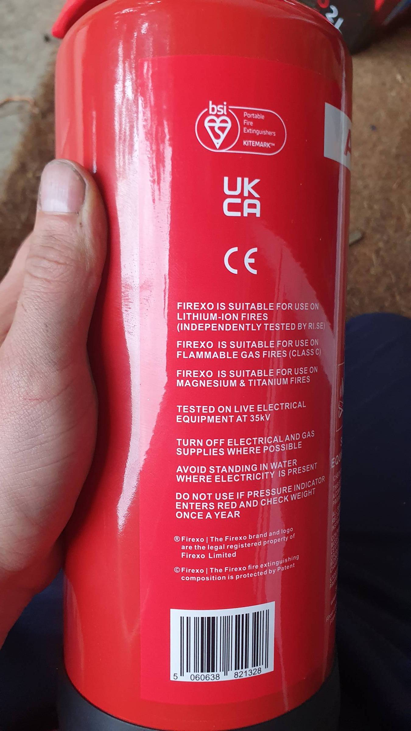

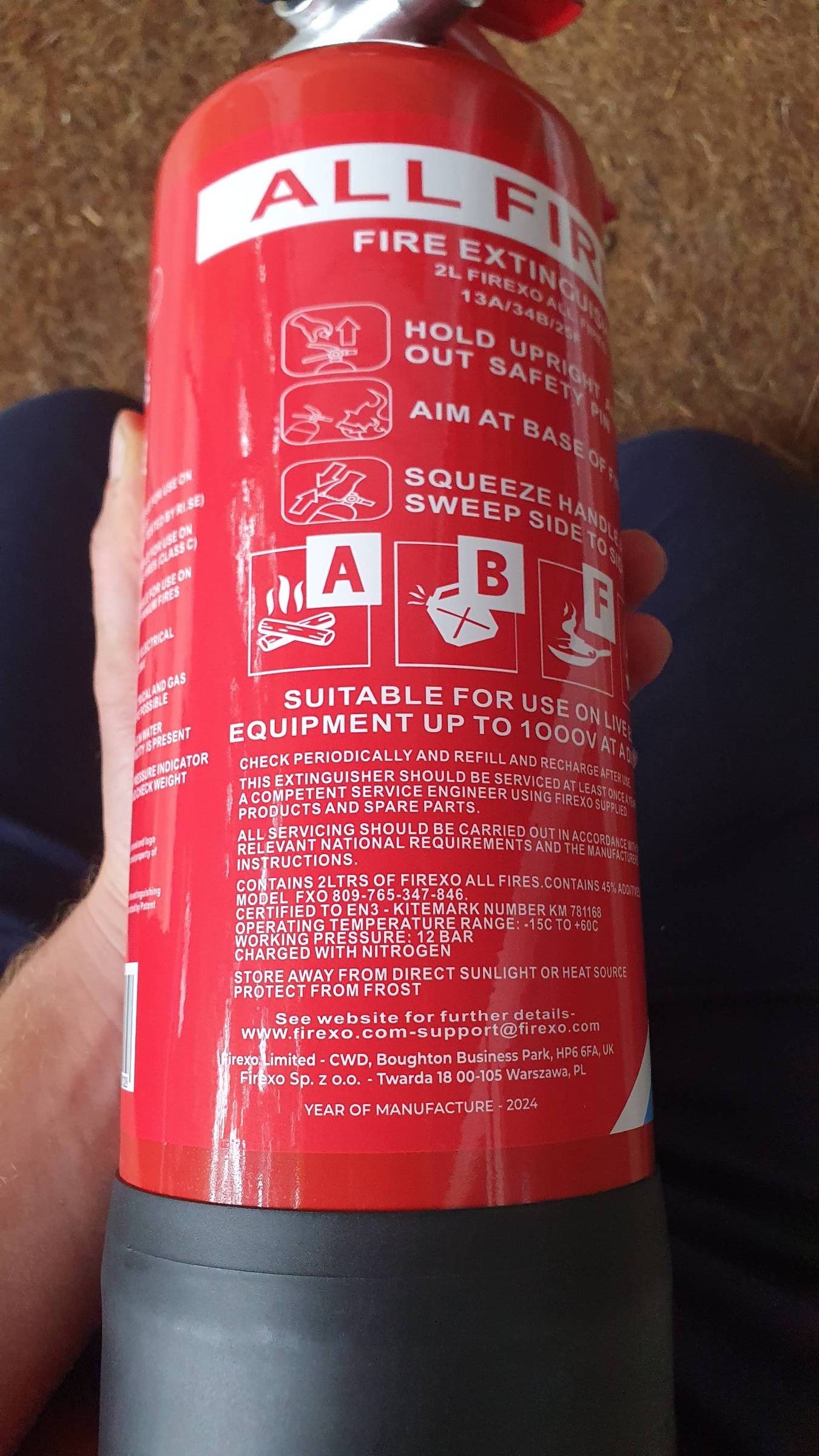

Yeah it looks good. Personally I have never understood the push to spend the absolute minimum on safety equipment to be BSS compliant, even beforehand we always has 3x2kg dry powder as the 1kg seem so tiny and never come with a flexible nozzle. Then we added a AFFF foam unit in the middle of the boat (close by the engine room/steam plant, 24vdc batteries and electrical distribution and kitchen) and have very happily spent the £36 its cost to get at Firexo unit. I have a 6l Foam extinguisher and a fire blanket in the house too, along with multiple interlinked mains powered fire alarms, non of which are required as such, but might well save the lives of our family. I am going to drop a line to Firexo to suggest they could make the website a little more clear in this respect. I also notice that CPC list the product as 'drypower' type, and detail the A B rating for the 2L for both the 2L and 6L model, and not at all for the 9L. Attached datasheets are however correct, and they are listed as being 'kitemarked' and 'for all fires'. https://www.farnell.com/datasheets/4314689.pdf Daniel
I have just opened, and the item itself claims certification. So it might well just be the website that's poorly worded, and or out of date?
Ahh. Well that as you say, does appear to render it technically not acceptable. I've bought one anyway, and shall put it on the boat along side the 2x 2kg Dry Power and 1x 2L Foam already onboard. Indeed.
For over 11m/36ft: Minimum qty x3 Minimum each 5A/34B Minimum total 21A/144B Firexo 2L 13A 34B Firexo 6L 34A 113B I make it 2x2L 1x6L if using Firexo alone to make up the A B rating. But you could also mix and match, and have two 13A 55B Dry powers and one 2L Firexo. Or, four extinguisher, two of each or otherwise.

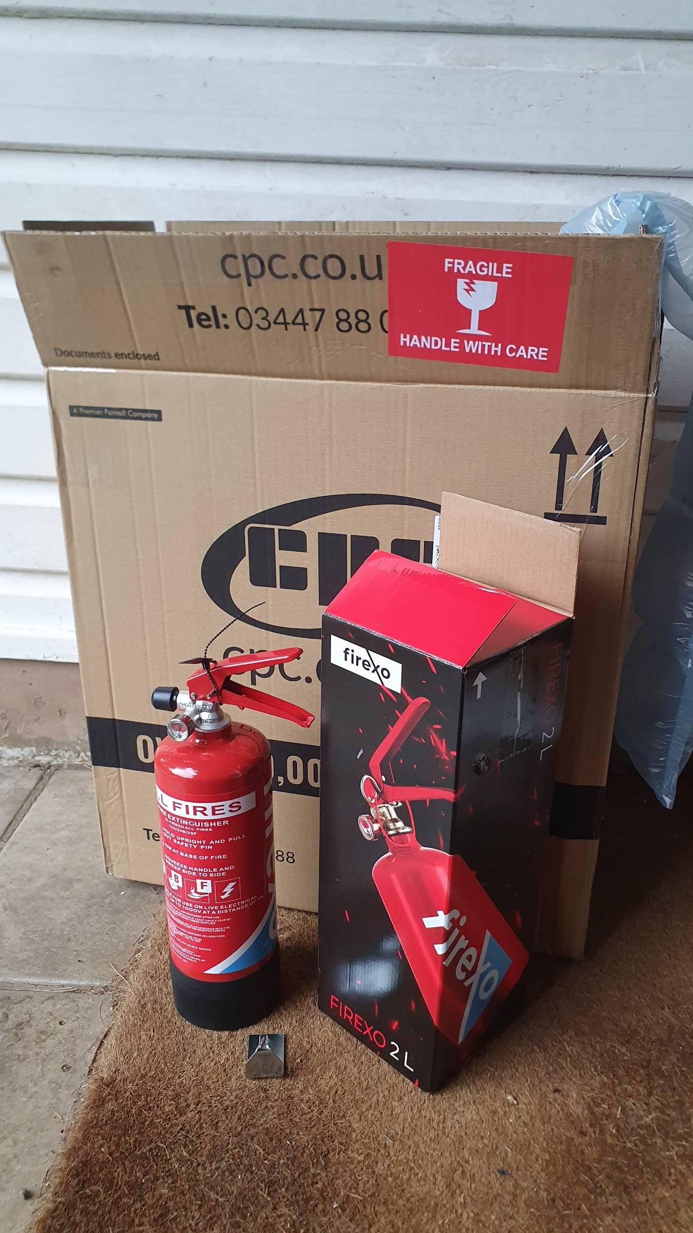

I good while ago I created a thread suggesting the Foam fire extinguishers might in be better than Dry Powder for a lot of narrowboat applications. Well it now appears not only that this view is gaining more traction, but also that there is a new technology of extinguisher that gives the best of both. They look good and I have just bought a 2l one! https://ydsa.co.uk/news/should-we-still-have-portable-dry-powder-extinguishers-on-our-boats/ Firexo 2L 13A 34B 4kg £36 inc VAT Firexo 6L 34A 113B 10.7kg £64 Firexo 9L 55A 183B 15kg £80 Discharge time is good to, at 25-30sec for a 2L, where most 2kg powder are 9-10sec. They have an online shop, but the cheapest place I have found is CPC who offer free shipping. https://shop.firexo.com/products/firexo-all-fires-2-litre-fire-extinguisher-red? https://cpc.farnell.com/firexo/5060638821328/kitemarked-all-fires-fire-extinguisher-2l/dp/sr11990
