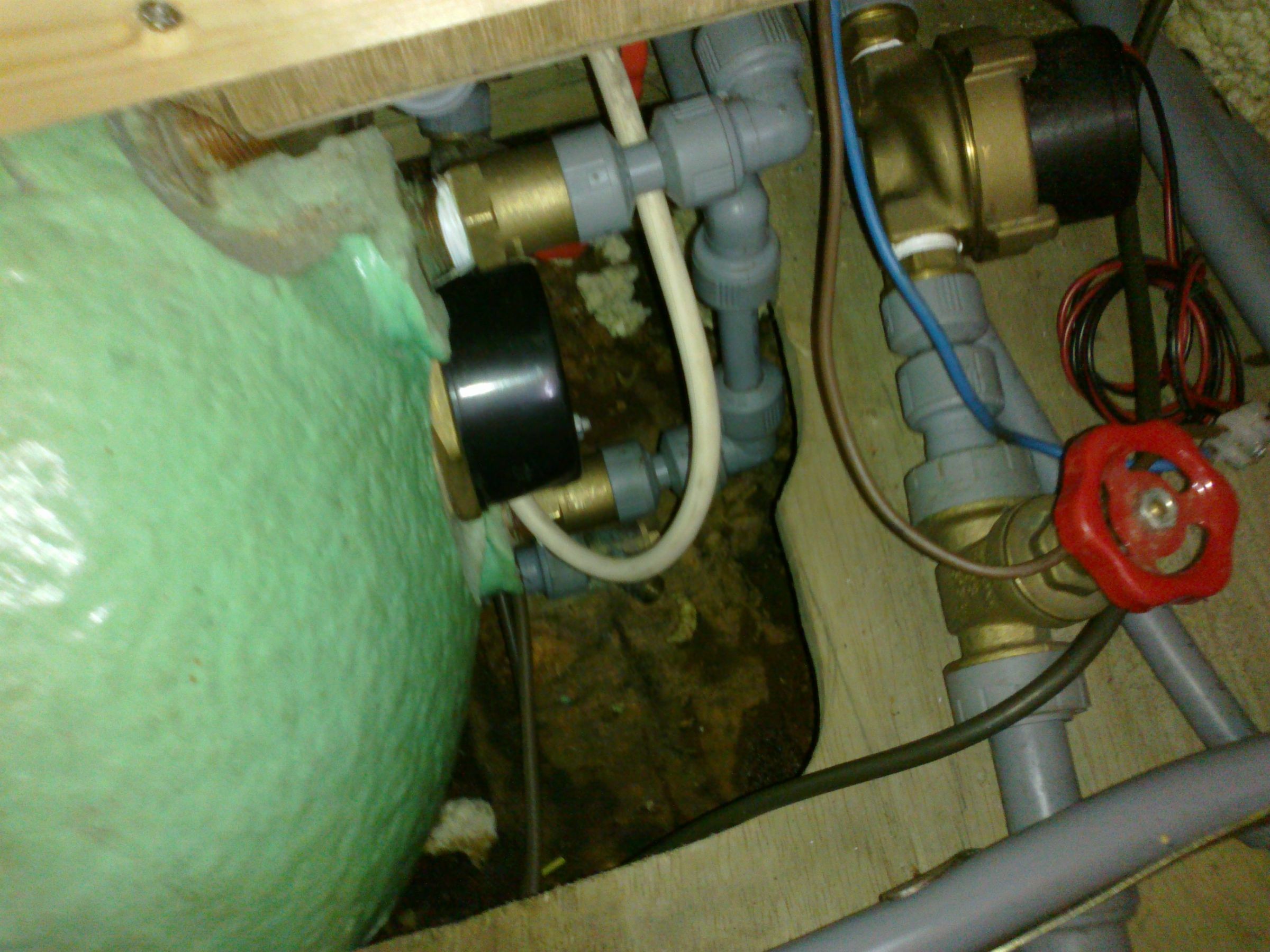

Boatingbiker replied to baldlimey's topic in Boat Building & Maintenance
Since my original post in response to MtB comments, I have now obtained access to the Building Regulation documents and would amend / clarify my original post as fpllows: a) Building house standards for unvented hot water systems in excess of 500 litres PRV are covered by Building Regulations document G3 and do not apply to boat installations and I agree with MtB do not disagree that the PRV should be located as close as possible to the item being protected. This document also states that PRV should be mounted directly on the calorifier and that discharge pipes may be made with Polybutane, Polyethylene or Polypropylene materials. -
South West Durham Castle Class
The photos published were intended to show the location of the PRV on a boat we previously owned. In response to MtB comments I would say a) house standards for PRV are covered by Building Regulations and do not apply to boat installations and I do not disagree that the PRV should be located as close as possible to the item being protected. b) the pipe used was Wavin Hep2O, which according to manufacturers data sheet is intended for installation on boats and can be used for short (duration) malfunction at 114 deg C and 3 bar pressure. The pipe in question is also fully enclosed behind side panels throughout it's length. Therefore IF in the event of the PRV operating AND the pipe failing due to prolong temperature /pressure the escape of water / steam would not cause risk to personnel. with is the purpose of PRV's c) I also strongly agree that an isolation valve should NOT be installed between the calorifier and PRV, and was surprise to find one installed. However, in this instance the valve was in a concealed location and could only be operated by use of a dumpy screwdriver, the valve head being rotated to almost face the side of the boat. Certainly not ideal but normally not found by Joe Public -

Hi, our shower pump and PRV was accessible behind a small (24" high x 18" wide approx) panel with 6 screws located at floor level and between bath and cupboard with basin on top. Panel had towel ring attached on outside of panel. Photo attached has been auto rotated by computer. Rotate anticlockwise to correct with pump at lower level. -
