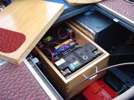

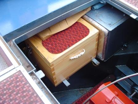

post-5311-0-62801900-1442682349_thumb.jpgpost-5311-0-62801900-1442682349_thumb.jpgpost-5311-0-34907400-1442682383_thumb.jpgI have done something similar on a number of cruiser stern steel boats. The batteries fit into a box which is mounted on two pieces of steel angle welded to the uxter plate and allow the box to be withdrawn for battery servicing. Hardwood runners fit round the steel angle and a pin is used to secure the box in place. The cables are welding type multi strand of adequate size and the system has passed inspection many times. Although you cant weld anything to a Dawncraft, it should be possible to use a similar arrangement perhaps using extending drawer runners of the right weight capacity. I can't see the sliding seat runners you mention being able to move the batteries very far.
