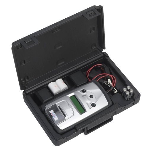

It'll measure things like battery internal resistance, ability to accept a charge, etc to see that in the first place it is healthy. I guess we have all seen a battery declared as faulty but showing 12v+ on it but under lid it drops off to say 7v or less. So although a battery using a Volt meter may show a reasonable reading it may not be in good health. After telling it what type of battery and what the battery SAE, CCA, Ah is it'll then give you a percentage score at the end. Plus a print out so the customer can easily see what the gadget is reporting back. Sealey do a cheaper version.
Specific gravity reading of electrolyte is also useful if this can be obtained. If all else fails, buy a battery analyser. I use one like this with a printer but there are slightly cheaper ones. Basic print out shows state of health and state of charge.
