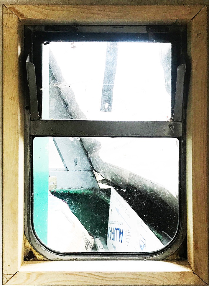

  1. Yesterday saw me take a couple of hours away from the usual stuff to have a go at the from windows. Halfway there with this one done, now just need to do the small windows in the loo are (which are frames but need the surrounds done. Then it's the question of fillets for the corner or something that works (what have others done with this I wonder?)

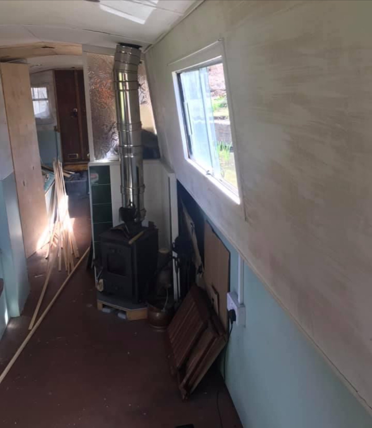

  3. It's taken all the money we got from the insures and more besides but the boat that has emerged is so very different in that it's lighter and airier (the glass behind the fire is a help) and the losing of the pump put loo and so many other changes have left us with a boat that still has six berths but now it's two doubles and two singles of one double and four singles and the addition of the cratch and a clarifier (so gas only used for cooking now) has transformed it. I reckon there's about four months of finishing things off proper and then with it painted inside and out I can start on sourcing an electric vehicle and working on a new greener form of propulsion. That said the original engine runs so well - temperature sits at 80 deg C and starts on first click of the key but I'm sure the day is coming when , like Amsterdam, the fleet will be electric. The wife wants to buy a horse!! I hope you have and much fun as we have had on your project (the bumps are what we climb on ? ) As for economic sense - working in my business it's about being and doing so has been cheap (where else would I have our kids sawing, planing and doing so much us both as we all designed, built and now use as a family and as individuals. And the value of the thing has increased so there's an offset there if we need a balance sheet. Look forward to seeing what you're doing and how it's going. V
  4. Thought of sending an update many times but life’s conspired to distract me. The rebuild has been hampered by COVID and a time away whilst we had bottom replayed (generally good but there was putting and it was decided that we’d bite the bullet and o it, transform the bilge into a dry place and change a few other ‘metal based’ things. fire was fitted and slowly we have found ourselves doing the things that make it look finished. Thanks to those who have sent the odd mail to ask what’s happened and sorry for not posting before this.
