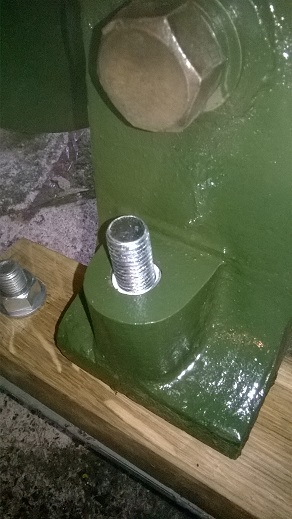

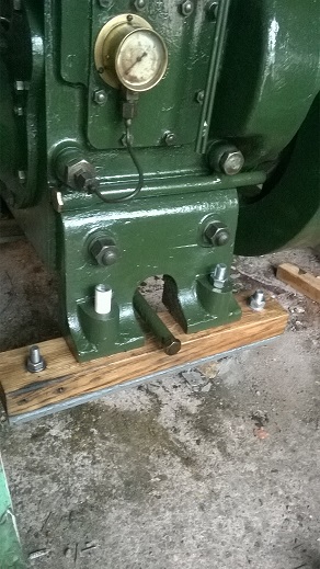

  3. Attaching the engine bearers.. Made a sleeve for the mount bolts as it wasn't easy to get coach bolts big enough, so I kept to m16, which is what I used before. The sleeve in place. On its bearers. Not really anything else to do now, but arrange to get it lifted into the boat.. Casp'

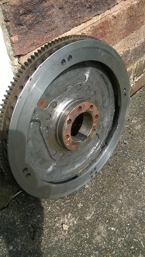

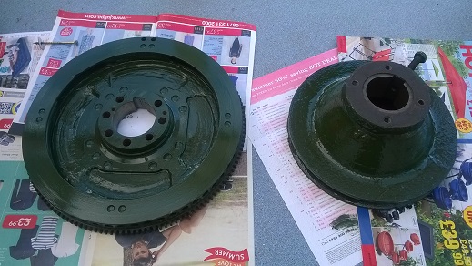

  4. Yes, I did try to do the keyway myself on a milling machine, but once I had it clamped on it was obvious it was going to be almost impossible without hours of filing.. I was pleased to find a company to do it for me for £15. The volvo flywheel looks a bit better with some matching paint. On the right is the Ruston pulley, which is a heavy cast piece. The tapped holes in it are where the little prop shaft is connected, so drive from the engine is taken off this pulley. Once on the shaft, the flywheel and the pulley will be held together, I may weld them, but one is mild steel and the other cast iron... or I may try that miracle metal putty. It's only to keep the flywheel against the pulley.. Casp'

  6. An old Volvo flywheel. I removed the back part of the duel mass flywheel, bored out the centre to fit the Ruston shaft, neatened up the back on the lathe and found a local engineering company to fit a keyway for me. Cost £20 in all. This will be used for the electric start system.. Casp'

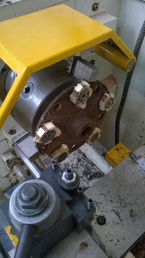

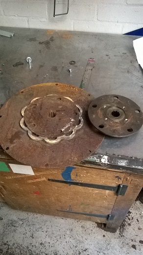

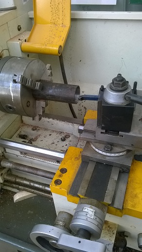

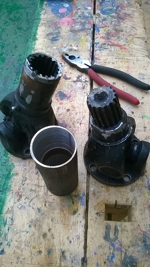

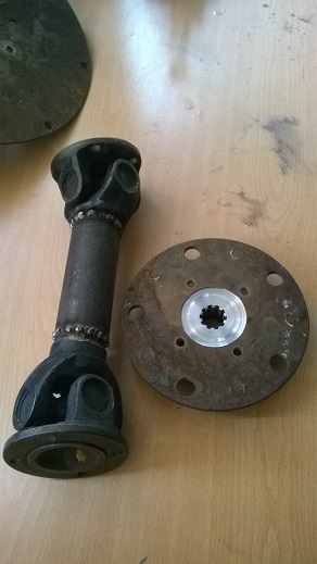

  7. A little bit more today. An extension piece for the little prop shaft. Increasing the inside diameter so it will fit over the shaft. Part made. I then heated the extension piece so it slid over the shaft and once it had cooled it was stuck, but I have, of course, still welded around it. Old drive plate, on right, was second hand and had worn splines when I fitted it, so i've sourced a new-ish one to replace it. It's never been used but has sat in someone's shed for a while.. I removed all the plastic parts and then turned down the steel lugs. I then needed to turn a bit to centre it accurately with the uj and drill the 4 holes to bolt it together. The finished parts ready to fit... Casp'
  8. I have a remote prm gearbox with a short Landy prop shaft between it and the engine. I just need to extend the prop shaft by 1.5", which i started on during mu lunch break today. Although it's a single cylinder it's a bigger engine so it wont make much difference and it will be fine with the propeller. This single actually weighs 50 lbs more than the twin I had.. Casp'

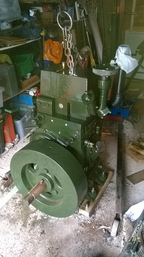

  9. The 2VTH being stripped down, hoping it would just need new rings and liners.. Being towed backwards to have the engine lifted out. Engine stripped, at which point it was found to be too bad and too expensive to repair, with many parts unobtainable. We found that the engine had different injectors, one being the right one and one being from a VSH which is a higher psi.. No idea what that means.. A 1VSH was purchased to replace it. This was originally a cement mixer engine, from a rather big mixer... All unnecessary parts removed to be sold.. The inside was cleaned, especially the sump under the oil strainer and all new gaskets made and fitted. The engine has already had a new liner and rings and has had the injector and pump serviced. Engine given some new paint. New engine bearers made as the others aren't the same size.. That's it so far... Don't like to work too hard... Casp'
