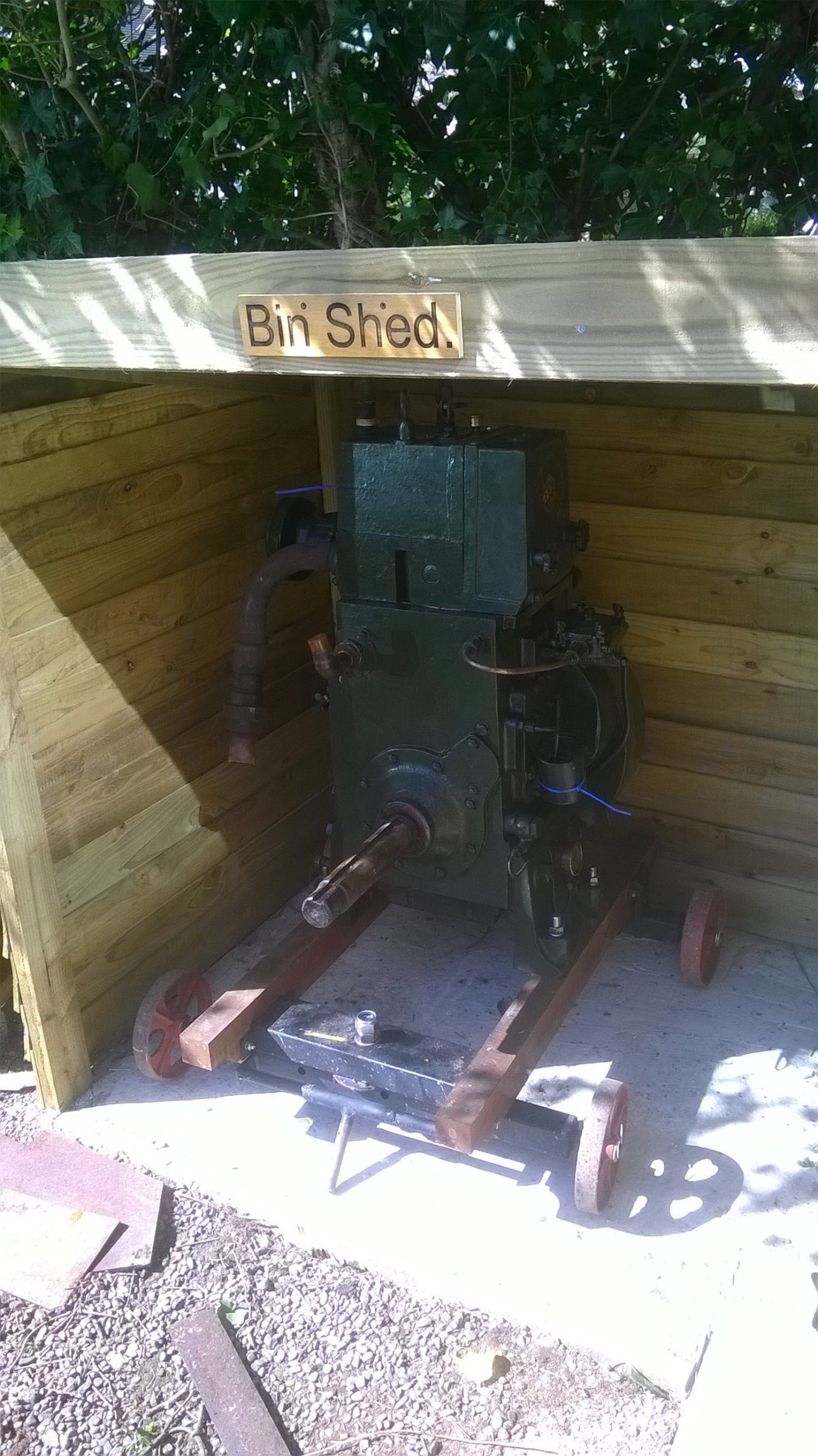

  14. I set off behind them but I got delayed as my Dad's boat was firmly stuck in its mooring as the water level was low.. I went passed them when they stopped for lunch, then they went passed me when I stopped at Welshampton, where I still am..

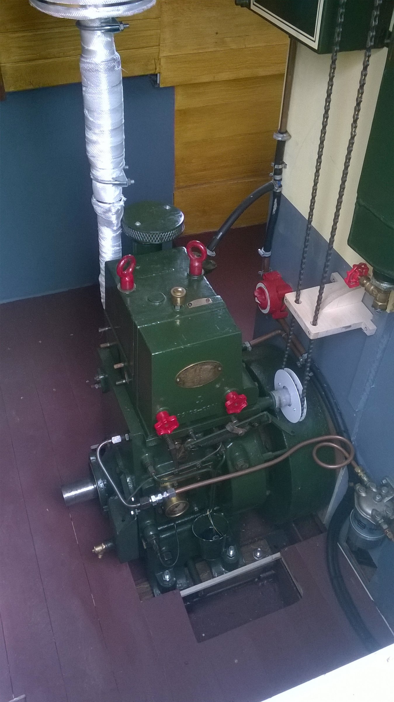

  15. Chugged for about 3 hours today.. The boat is really slow, the engine isn't revving much with this big propeller, and my chain throttle link isn't working; the chain is still coming off and then slipping..more work needed to sort it. The silencer I made, which makes the engine sound lovely at low revs, sounds deafening when the engine is working in gear so I think I will swap it for the Fordson Major silencer I had with the previous engine. Fitting a smaller propeller this week so I'll see how it goes with that, but probably won't be faster, just more smooth.. To gain more speed I may end up changing the governor weights so it revs to 1500 rpm, like the marine version did. It's all a bit trial and error, it'll either end up working or I'll end up fitting an HA2 instead...though I quite fancy an FR2...
  16. Finished the engine room floor, did a bit of painting, boxed in all the cables and mess in the back cabin and lagged the exhaust..

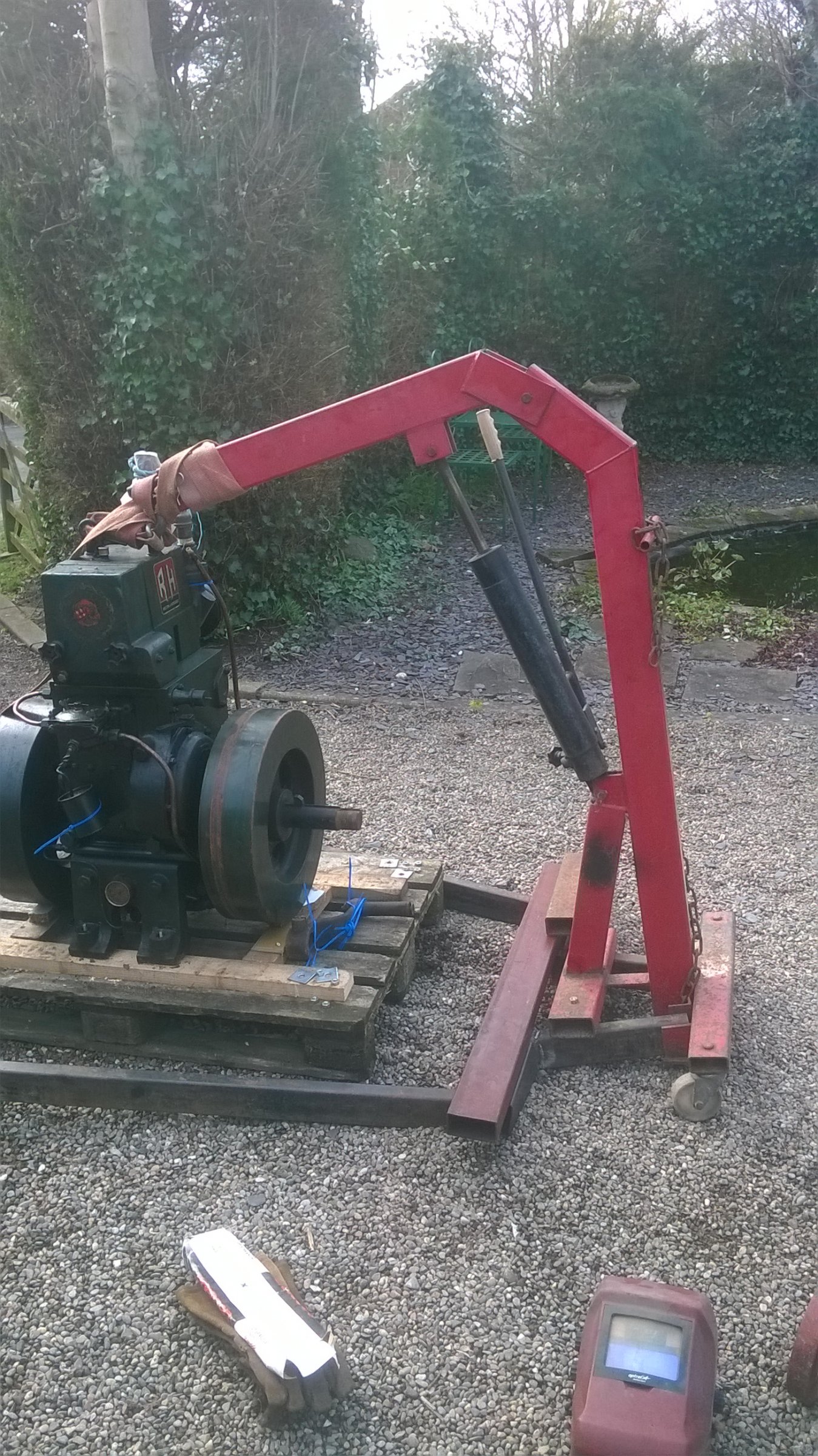

  17. I have also bought another Ruston 1VSH off someone, I had been nagging them to sell it me for years and they decided to sell it me only 6 months after I had bought another one. But I still bought it, it'll be handy as a spare or just for the parts, even though it is fully working.. WP_20170302_13_56_53_Pro by ghost.hut1, on Flickr I arrived like this, and the 990 pound engine promptly made a mess of my engine lift, bending the legs, which I had welded on to widen it! WP_20170304_12_08_20_Pro by ghost.hut1, on Flickr The offending parts cut off.. WP_20170304_14_34_40_Pro by ghost.hut1, on Flickr Much stronger steel welded back in.. WP_20170202_12_16_50_Pro by ghost.hut1, on Flickr To give me some chance of moving the engine about in the garage I made a steerable trolley for it, but on the gravel drive it just dug in and we had to push it with the car and use long poles to guide it. To lighten it, I removed one of the 135kg flywheels. Which wasn't too difficult. Just a flat bit of thick steel with two 12mm threads tapped into it and bolts which pulled/pushed the gib key off, then a puller, extended with some more steel bar, pulled the flywheel off easily.. WP_20170309_13_02_22_Pro by ghost.hut1, on Flickr WP_20170313_16_06_11_Pro by ghost.hut1, on Flickr Getting it into the garage seemed to hard, so I put it into the bin shed, the bins will have to live elsewhere... At some point I will make some steel channels the right width to act as a railway track which will enable me to easily pull the engine out over the gravel... This was a little diversion from actually doing any real boat work... Casp'

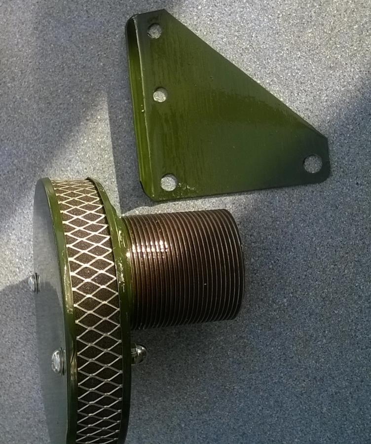

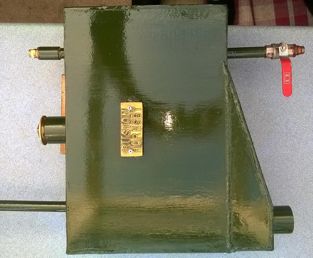

  22. And with a bit of paint.. I haven't bothered to grind the welds flush, I don't mind them showing and I've tested them with paraffin so I know they don't leak. I also made a simple bracket to hold the fuel return tank, and I had to move the thread on the air filter as it wouldn't fit on now I've altered the exhaust manifold. I just made a new bottom for the filter housing. Casp'

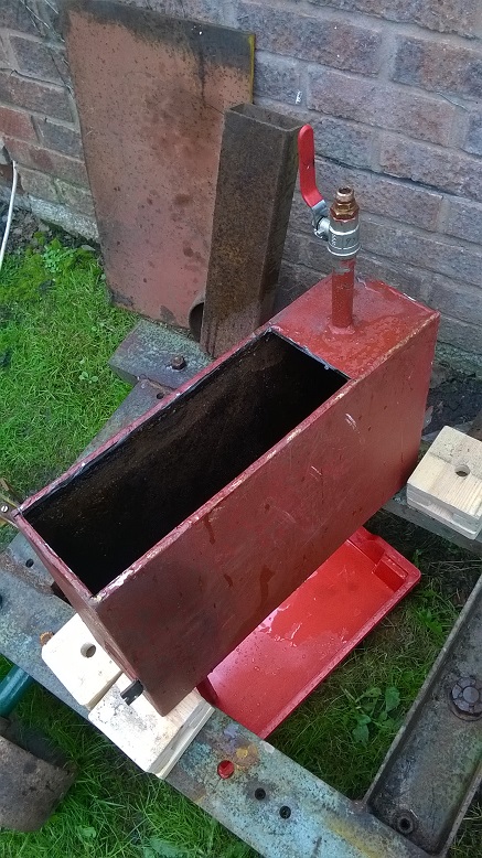

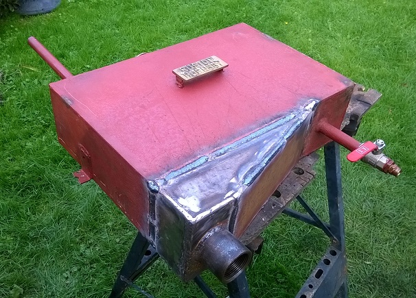

  23. I cut the bottom from the day tank and gave it a good clean out.. I didn't realise that when I made the tank I only put the take off pipe about half an inch into the tank, I thought I had allowed about 3" for crud.. Then made a new bottom with a lower section and a drain plug. Casp'
  24. My stuff is brown, think it's just the photo makes it look pink. I guess we will all end up using some sort of additive before long. he low drain i'll fit should help..
