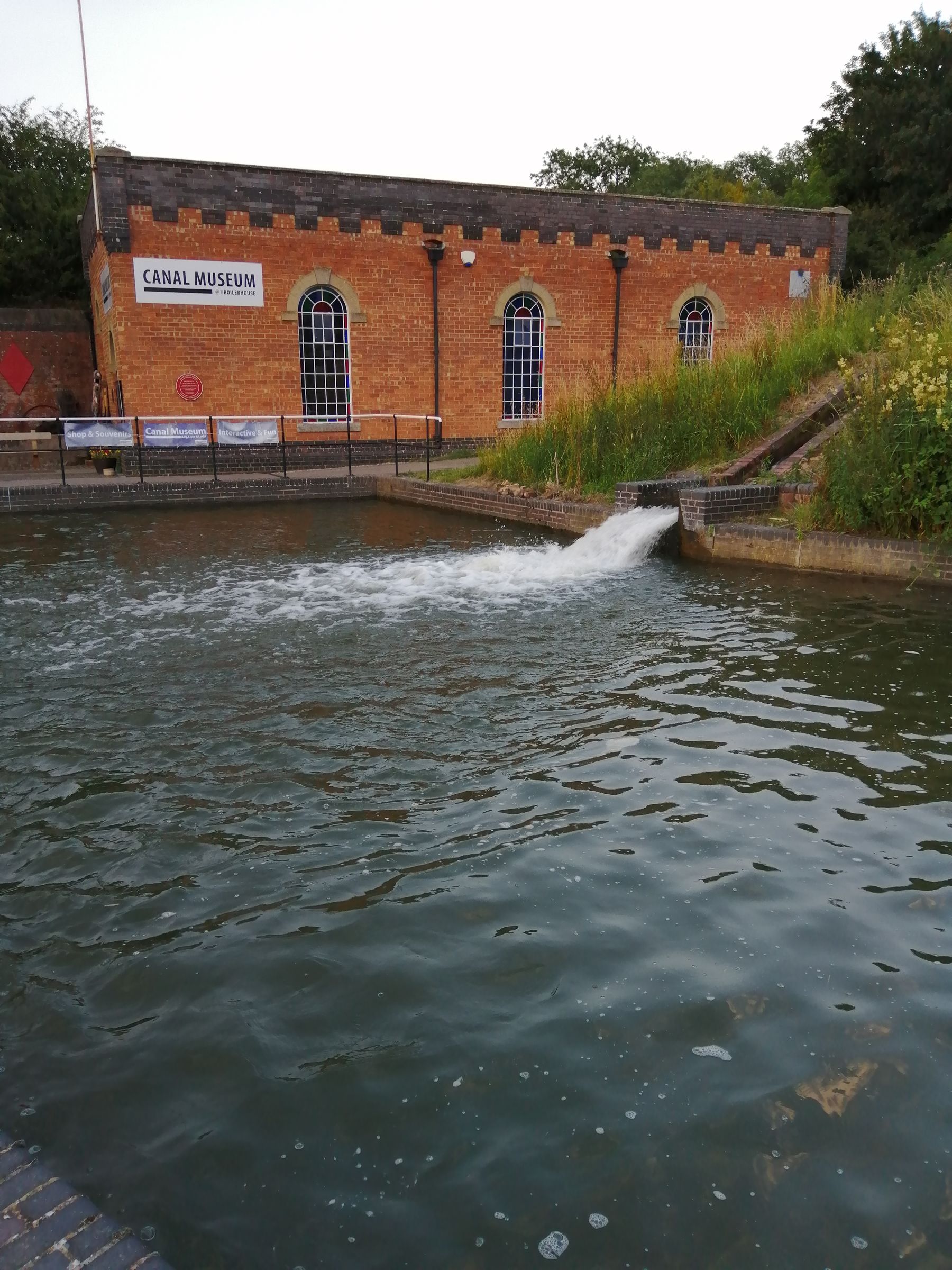

Bit more info - water still running down the locks at 08:00. Moved along the summit and the levels are topping the side weir about 1/2 mile along. So if the paddles where closed the water would be still waisted. There must be an explanation for this action. Just can't think of one.
This is Foxton this evening 20:34hrs. The flight was locked at 16:00hrs as restricted boat movement times still in operation, supposedly to assist with back pumping. If there is a need to run water down towards the Soar could they not extend boat movement times to the benifit of all?
