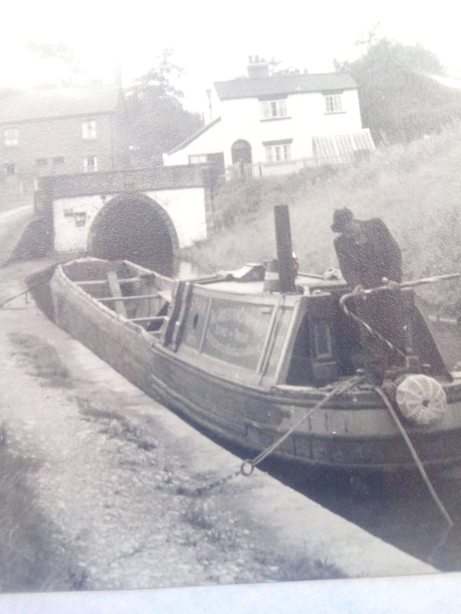

I believe it was thought the boat which is the Bedford was first thought to be the Spain.
as you are probably finding, the records of the Anderton Company are somewhat scant. I have spent hours in the waterways archives to no avail and pretty much checked all the local Stoke history pages looking for photos of the knobsticks.
the only photos we have of the Norway are ones we have been sent. we can't find any in the public domain. I'm not sure who owns the model but the colours match those of the Denmark in 'Colours of the Cut' by Edward Paget Tomlinson. I have. page on Facebook if you have a profile detailing our work, and also what little history of the Anderton Co I can find. if you search for NB Norway you'll find it. if I find anything else I'll pass it on!
Does Ian have any photo records of the fleet?
kind regards
Dan
hi! At one time it was thought the motor Spain was dragged from the flashes and rebuilt by Ian Riley. I believe that has been disproved and that is the Bedford, although Spain was definitely in the Flashes I believe.
have you seen this one?
to add, the photo of the model was on my page detailing rebuild of the Norway, here:

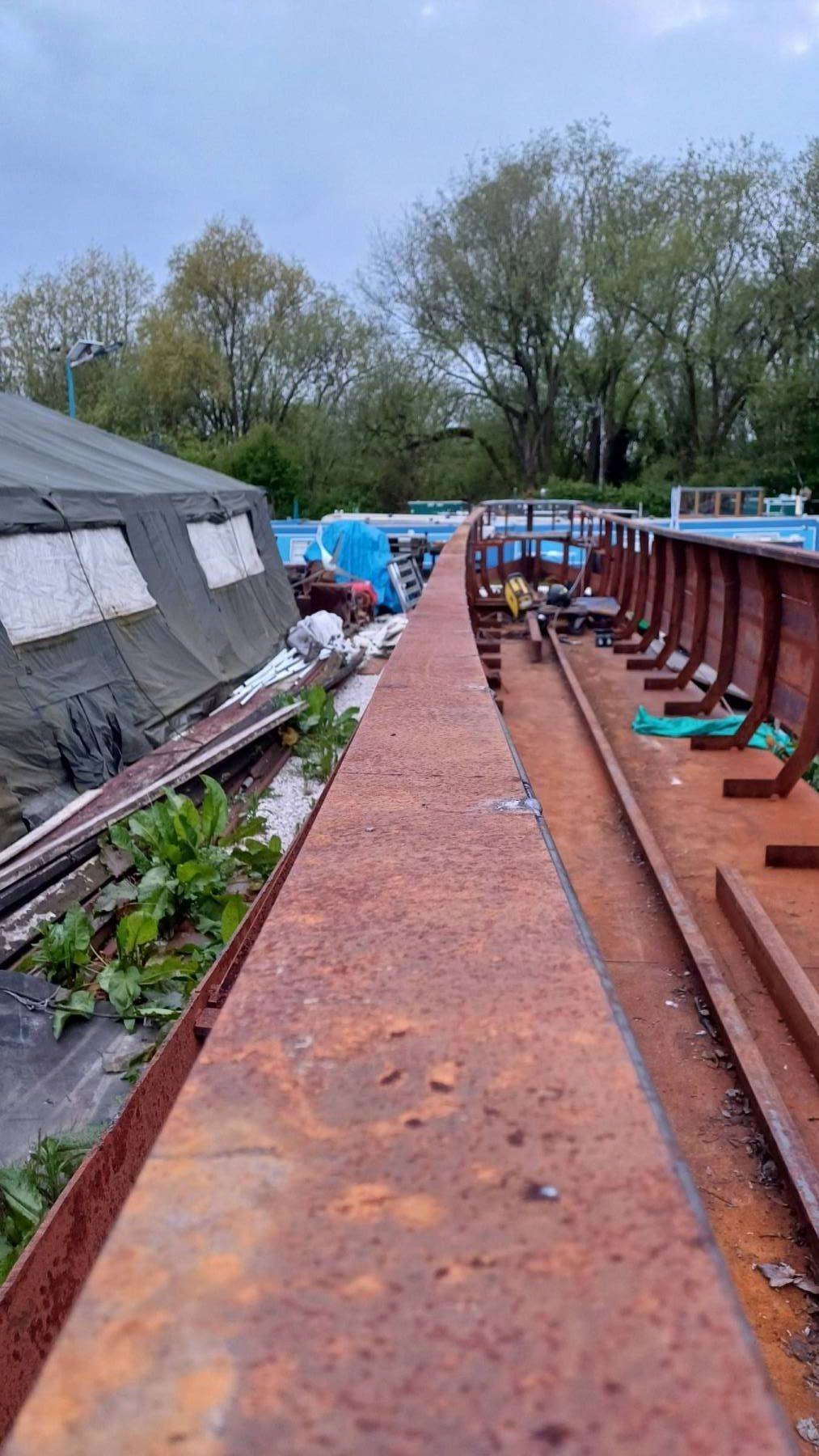

Onwards and upwards, we had a few quiter, sunny days at the yard so decided to get on with a few more bits of steel , the second chine plank at the stern has gone in and we have also got the counter on, as well as a length of 3" guard iron, which was donated by a local boater. We are once again, battling the gaps in the weather to complete further templates etc as its all just a bit too wet!
2
On 28/04/2024 at 19:10, ditchcrawler said:
How many yards of weld do you thing there will be in that hull?
I think about 700 yards in total.
On 29/04/2024 at 03:44, DandV said:Lovely to see the intricacies of such craftsmanship.
She really is going to be such a beautiful boat.
thanks, it's not going to be finished any time soon, but it's been a fun project this far!

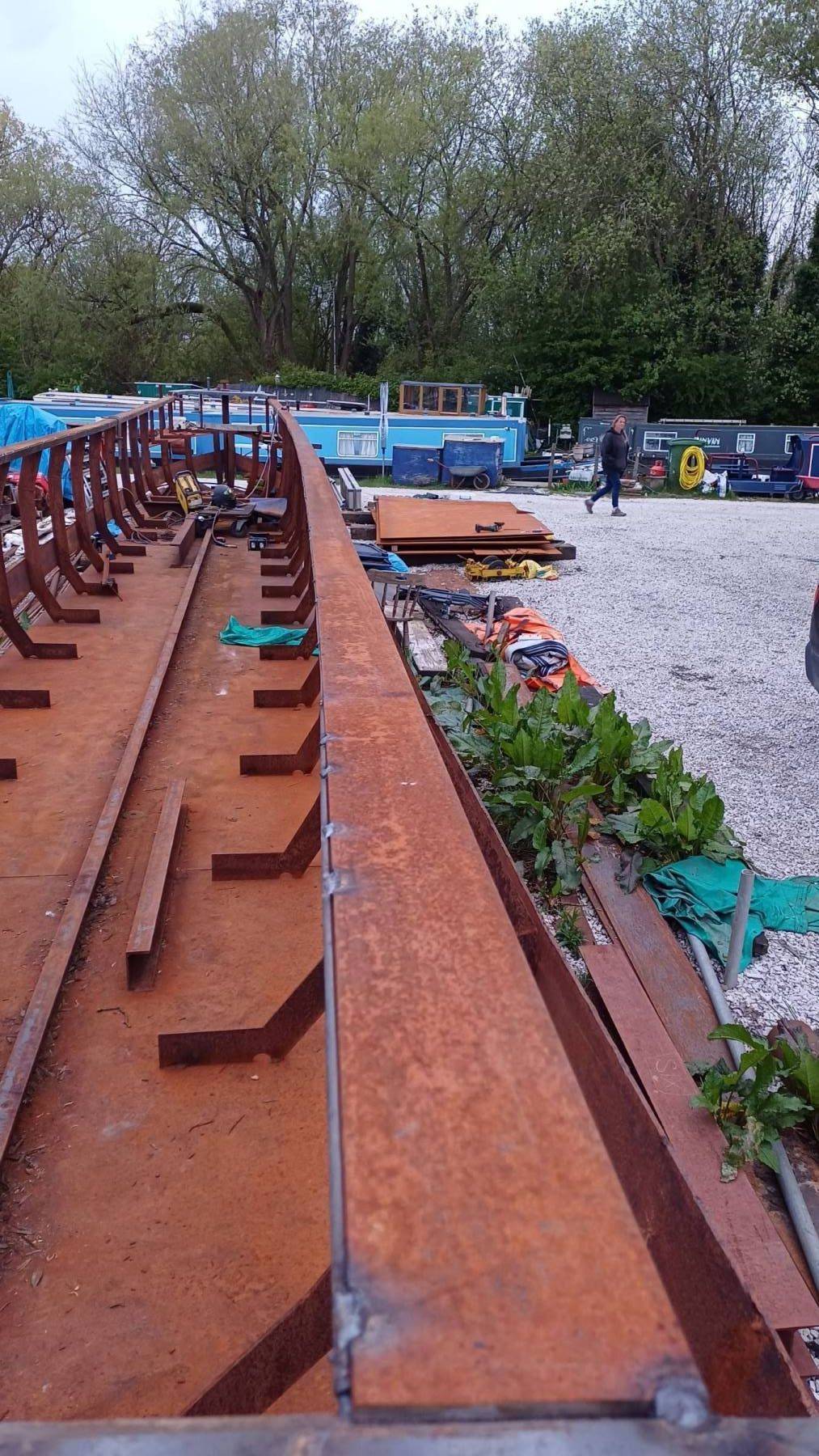

As a special treat, here's todays efforts, tackwelding the rest of the gunwhales and the internal upstand into position, its great to be able to see the curvy shape of the hull finally appearing..... enjoy!
4
exactly, and the beauty of a barrel sided boat built in planked steel is half the weld prep is already done for you!
1 minute ago, jacko264 said:
As a matter of interest what type of welder are you going to. Use for the planks ?
ark / or mig
you are making a wonderful job of this build. You should be proud of your self
Graham
Thanks for your kind words Graham, we're using a combination of mig and stick, weather dependent obviously, we plan to use 7024 iron powders on the outer chine weld, where we can we will mig but i've also got a load of 4mm rods which will be used in places. The tricky bit will be reducing heat deflection, but we have a plan for that.......

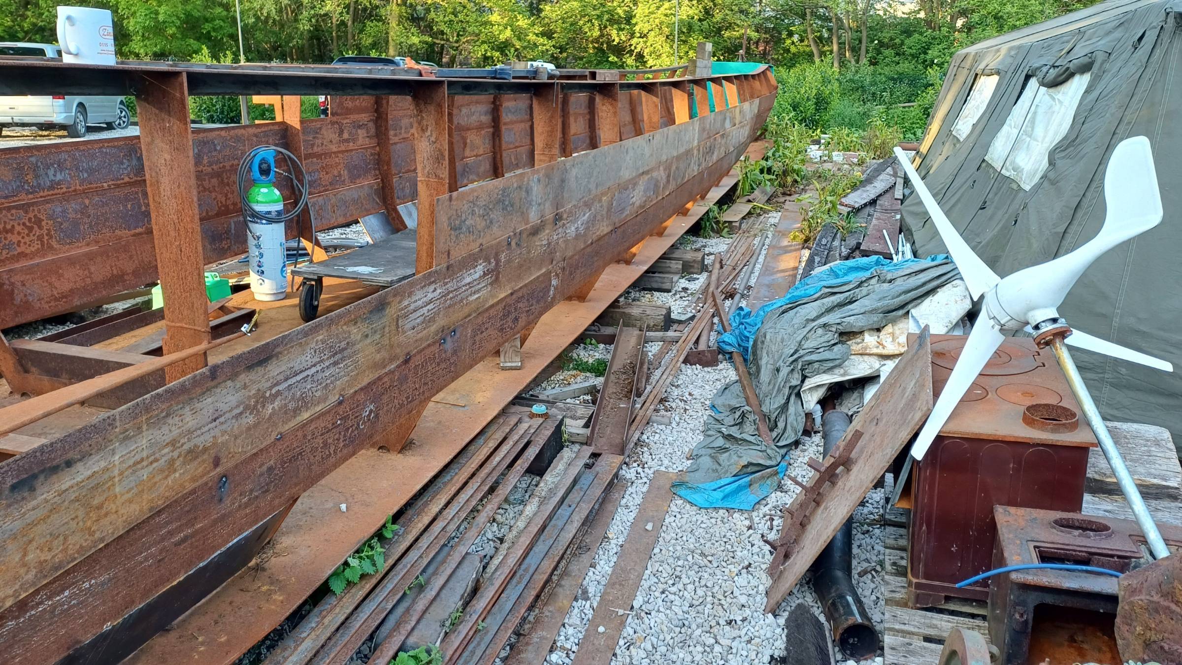

its 1 year ago today we laid the baseplate and whilst the first 6 months produced quick results, the last half of the year have been thwarted by rain, wind, floods and generally pretty poor weather. So what to report..... Well, we found her original stern dollies and rudder. Sadly they're on a bota on the K and A, made from the stern of the GUCCCo butty Satellite, called Adrastea, so they won't be reunited, and the unique Anderton profiling on the rudder top has been reprofiled to a more standard semicircle. So, we have machined an unmatched pair of dollies as they originally were, and also made a new T stud as the location of that is also unknown. We've also fabricated the majority of the deck beam on the bench, to weld into the deck beam frame which is where the first large wooden knees would have been under the deck board. The other job we squeezed in between rain clouds is starting to make the templates for sections of the hull we can't achieve with parallel planking.
We can but hope the weather will somewhat improve over the coming weeks....... we're not holding our breath.
Photos showing progress as of today
2

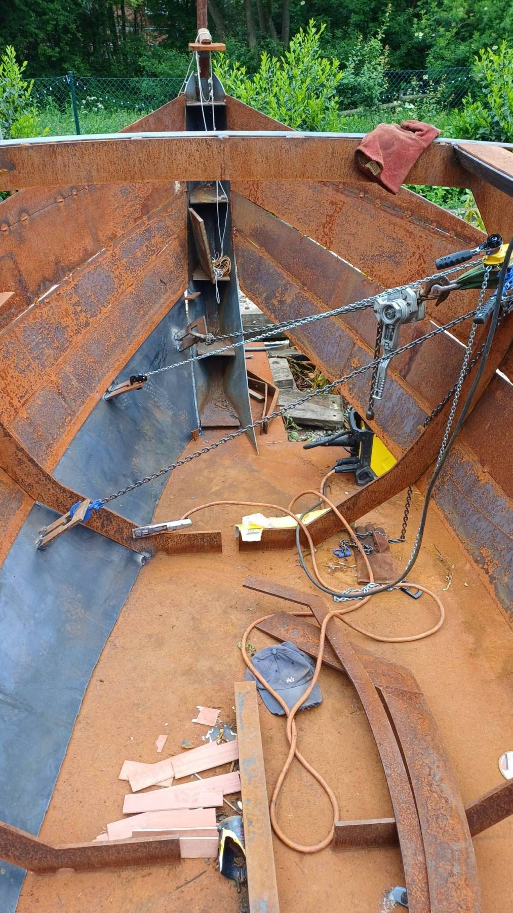

inevitably the weather has stopped work for a while outside, but the planning still continues.....
Just before the weather turned we managed to get one of the chine planks on running into the stem post which threw up a few issues with the knees, which I have got slightly wrong when i drew them. We've also had a steel delivery so we can start looking at sticking the cabin frames on to add some strength into the back end of the hull.......
