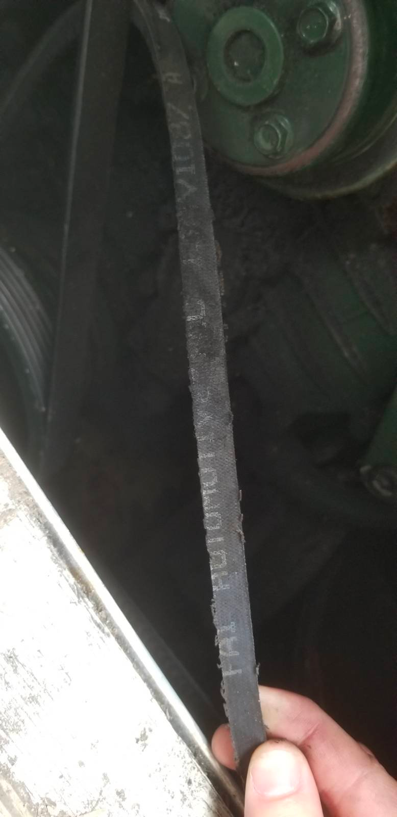

  1. Heya, The belt for our leisure battery alternator is knackered so we need a replacement, and I'm struggling to identify the belt so I can get a new one online It's a beta 43 engine, and the belt is 10mm wide. There's a few codes and numbers on it that are a bit worn, but from what I can make out they're 3108, 13AY1087, 661 1130 54940 161 and FA1 AUTOMOTIVE <something> - pic below I've found this one at midland chandlers, but it doesn't match any of the codes on the belt so I'm not sure it's the one... Any ideas? Cheers, J

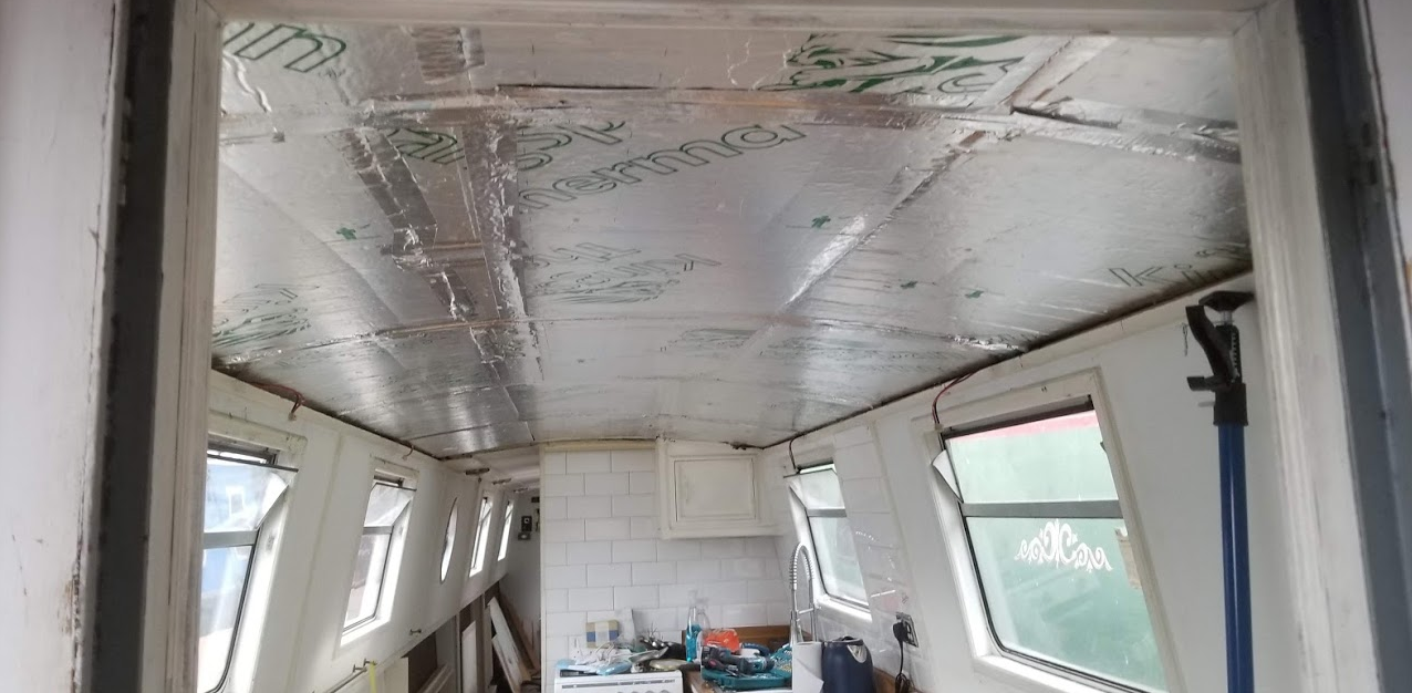

  4. Heya - I recently replaced my deckhead too Essentially get rid of as much loose rust as you can, paint the rust with vactan, add a layer of primer to seal everything in and then replace the insulation

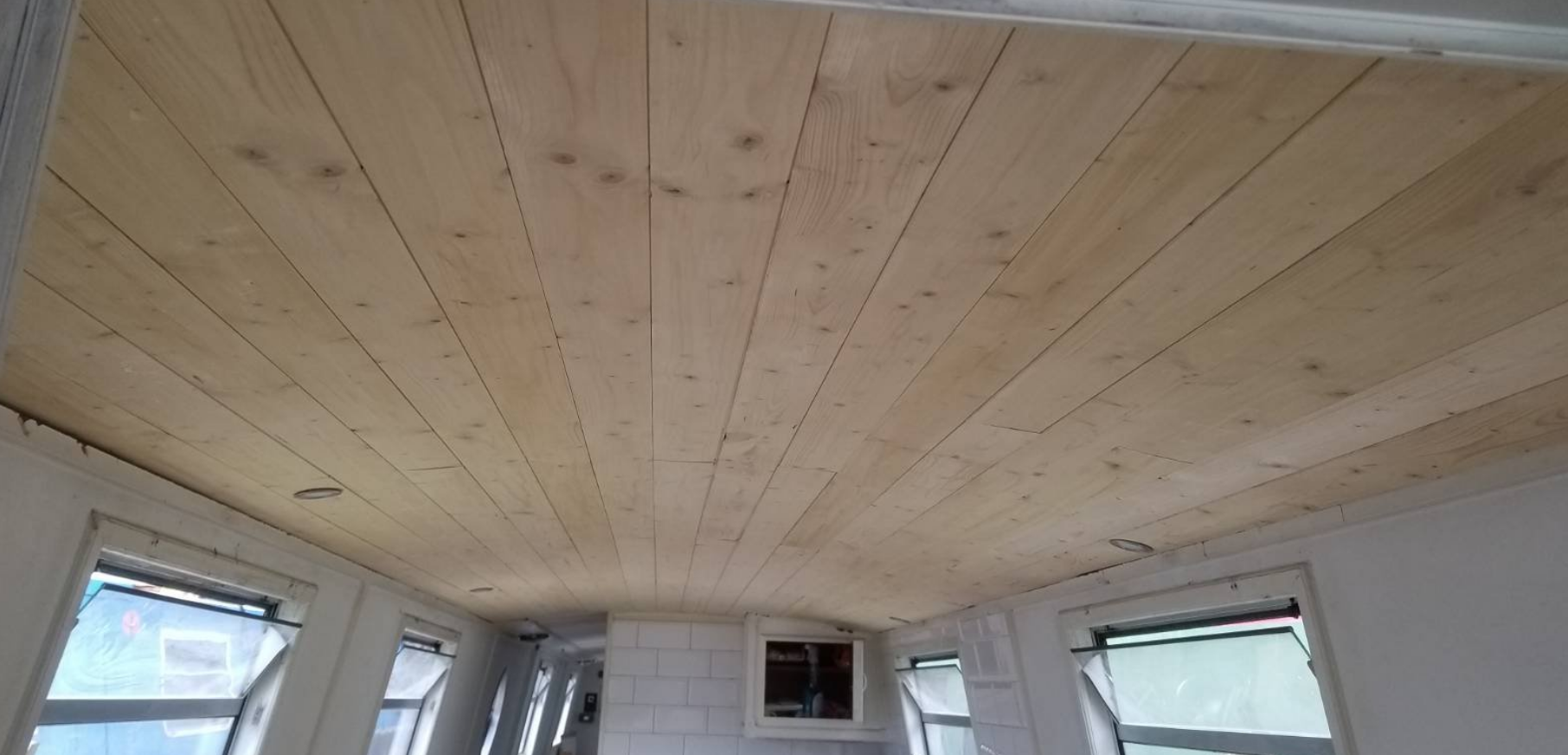

  15. bish bash bosh needs a trim round the edges and I'll put the vents back in, but I'm pretty happy with how it came out
