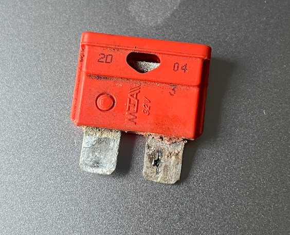

  3. Thanks again all, I reckon it's fixed now. The 40A fuse leading into the engine hadn't blown, but it's legs are pretty scuffed up, so I reckon it wasn't making a good connection, pic below. I replaced it with a new one (30A was the largest I had, will that cause an issue?) and the engine started first go without issue. Thanks again all - as always you've been massively helpful in narrowing things down and helping solve the issue, would most likely have caved and called an engineer otherwise

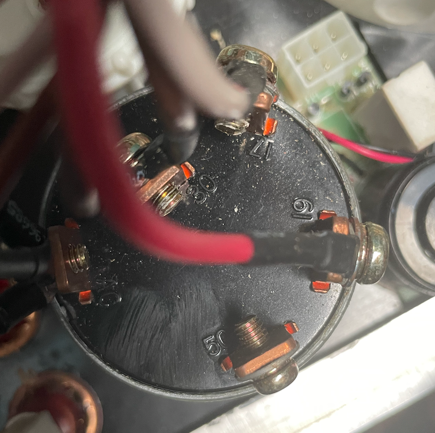

  4. Thanks again all for your ideas I followed a red herring for a bit - tested continuity across the isolator and it appeared broken, so popped into Roydon marina (convienently moored 5mins away) and got another, but on replacing it it looks like the old isolator worked fine, and I just hadn't made a good enough connection with my multimeter because of the awkward angle. Paul - interested in this line of thought - measuring across 30 and the other terminals on the back of the ignition shows 12V, so power is certainly getting this far. However, shorting 30 and 50 does nothing. Also, there's nothing connected to 50 (pic attached), should there be?

  6. Hullo all, Happy sunday.... Tried to start up the engine today (Beta 43), ran into a bit of an issue. I turned the key to heat, and the lights + gauges came to life as normal, but after 5secs they faded out. I tried turning it to run, the lights lit for maybe a second, engine made a very feeble attempt at turning over, and then nothing. Now when I turn the key either way, there's no response at all. At first I thought it was a dead starter battery, but measuring the voltage across it gives a healthy 12.7V. I tried switching over to our domestic batteries (measuring 12.4V), but still no luck, so I don't think it's a battery problem... It also doesn't feel like a loose wire problem, or a problem with the engine itself - fading lights suggest a decrease of power, but as the batt's alright I've got no clue Any ideas? Cheers, Jacob

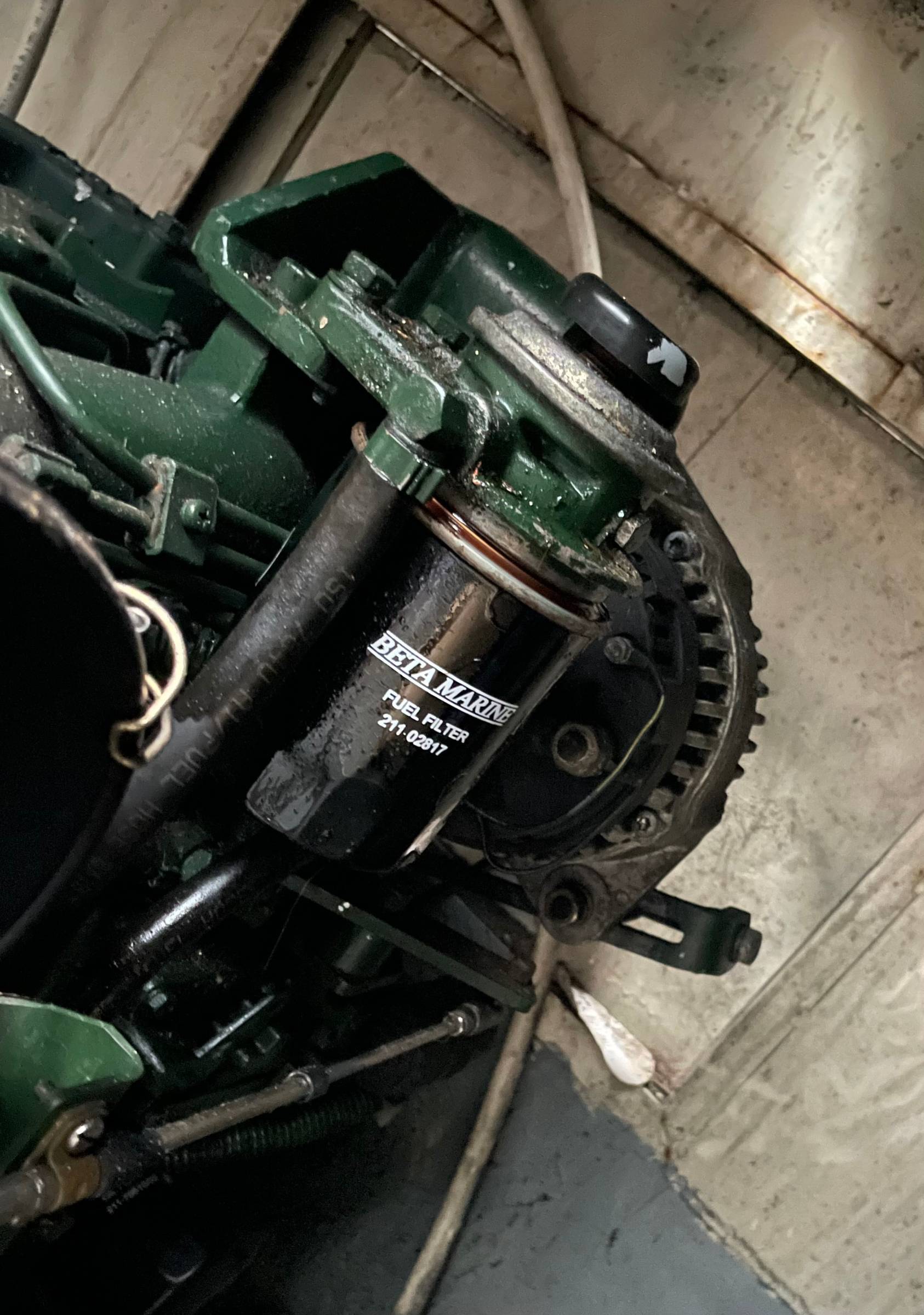

  12. Think I've fixed it - took the fuel filter off, only 1 o-ring to be seen. However, the bleed bolt just above was pretty loose, I think the fuel was coming out of there. Tightened the filter back on, bled it, nipped of the bolt, and it looks like it's fixed (fingers crossed) Thanks all!
  13. Not me! Had someone who came well recommended, seemed to know his stuff. I will have a look to see if there's another o ring up there and tighten it up at the same time
  14. Hullo, Hopefully just a quick fix, but wanted to double check as I know little about engines Our fuel filter is leaking - there's diesel around the rim of it that reappears when wiped clean, and the engine bay smells more of diesel than usual. Also noting that it's a bit slower to start. Pic below. Not too sure why this is happening - we had a full service of the engine a few months ago as we've just started CCing, and the filter was replaced as part of that. Is it a case of just getting another new filter? Or is there a seal or an o-ring kind of thing that needs replacing? The engine's a Beta 43 Thanks very much in advance - Jacob

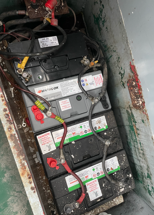

  16. Cheers both, have removed the two old batteries from the circuit

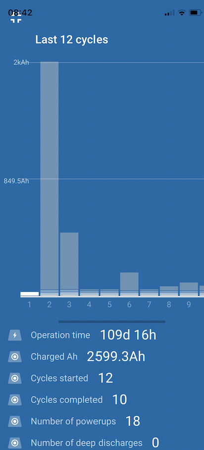

  17. Morning all, I'm having a bit of a headache with my batteries, wondering if you could help me diagnose the issue. For context, we're liveaboards at a marina, so we're almost always plugged in to a shoreline Around 3 months ago one of our batteries started offgassing pretty badly - I assumed it was just a knackered battery, so took it out the circuit. Then a second battery started offgassing a day later. I did some fault finding and reckoned that the old dusty battery charger was the issue. I got another new battery and a shiny 12V 30A Victron blue smart charger. I set that all up and everything was working flawlessly... ...until last night - at around midnight I noticed the smell again and another battery was offgassing. I disconnected everything from the circuit and this morning inspected everything. The dead battery is another of the old ones that came with the boat. Looking at the victron app (pictures attached) it seems the last cycle lasted 50 days and the vast amount of this was in storage mode. I've also attached a picture of the batteries, the duff one is the second from the bottom (although the bottom one has also lost its green 'healthy' indicator) Any ideas what's going on? My plans for temporarily fixing this is to either remove the old battery from the circuit, or to go all the way and set up the charger as a power source, with no batteries connected. A long term fix would be much appreciated as I don't have the funds to replace my battery setup every 3months... Thanks
  18. Cheers both, I'll try tracing it back and see where that gets me
  19. Hmm, I've given that a go but the problem is still there no matter which of the three are connected (and even when they are all disconnected) The only other thing I could think of is something else being connected, but the only other things that are remotely near are the horn and the water pump, both of which are on seperate circuits.
