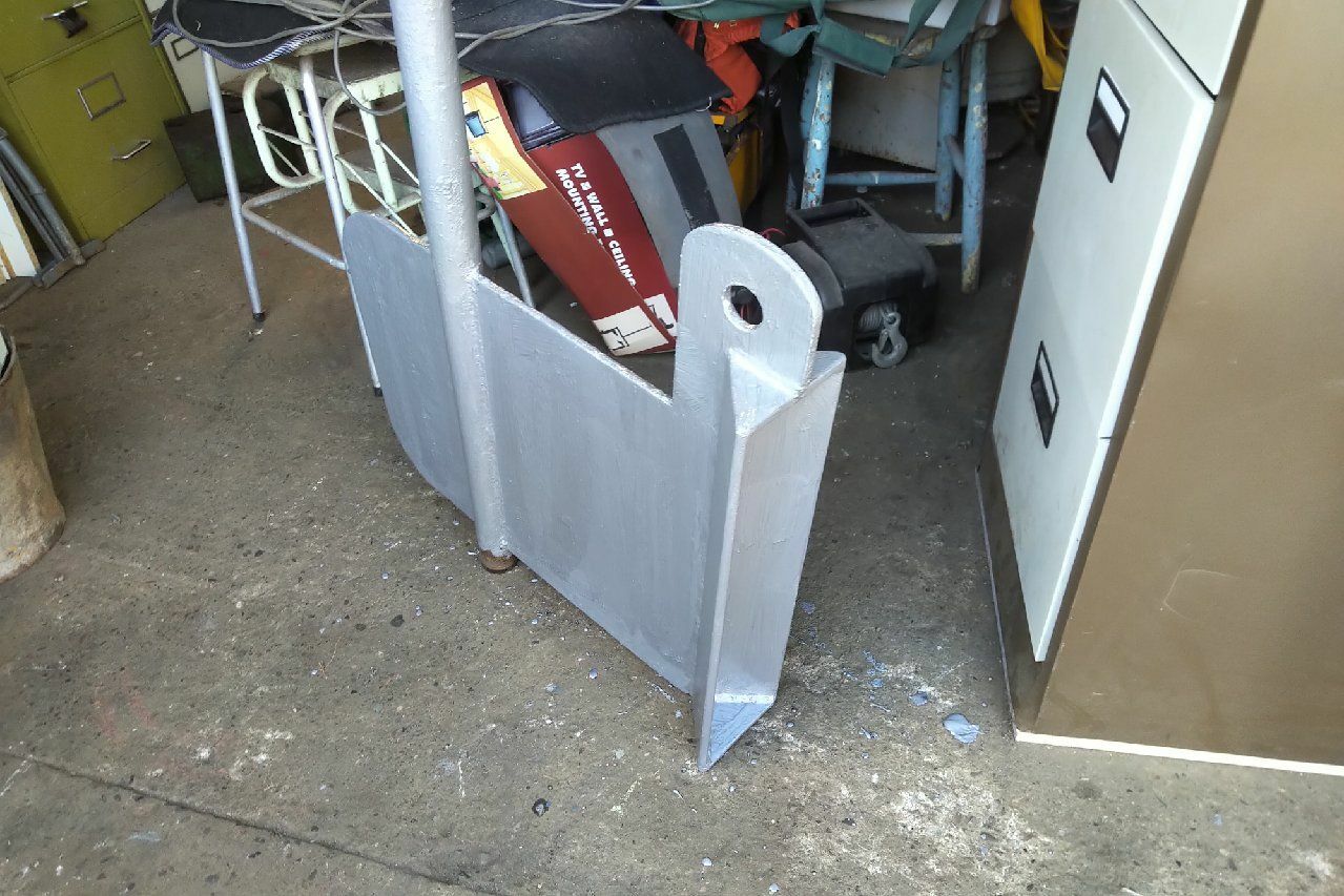

Well I have just returned to my marina and done a tight 180 degree turn in 25 knots of beam wind in one go- something I could never have done without either bow thruster or going astern a few times before I modified my rudder. So I am very happy. Ian D I would be very interested to know how your rudder performs when you get your boat finished- please let me know- I may well go the whole hog and fabricate a proper Schilling. Everybody else can stick to their flat plate rudders! -

It really has made a huge difference. Normal rudders (on ships at least) start to stall at angles much over 30 degrees and yet I have seen Schilling rudders go to 70 degrees and act just like stern thrusters. How much part the 'aerofoil' section plays in this I don't know, it certainly smooths the flow. It just needs a few more people to tinker about with their rudders and report back! Im sure the standard narrowboat rudder can be much improved on with a few tweaks. It is very rare that you see modern ships (at least smaller ones designed for coastal use) built without some kind of high lift rudder these days and I notice the continental river barges have gone for at least 2 schilling rudders per propeller. My first experience of a Schilling rudder was watching a 55,000 tonne bulk carrier go perfectly sideways in conjunction with bowthruster. Awesome sight and thought then I would fit one if ever I got a boat. Be interested to hear if anyone else has had a tinker! -

That is a lovely looking rudder Ian! Did you have a conventional rudder on the same boat previously to compare with? I wish now I had done some measurements with a strain gauge or something to quantify the lift. I also wish I had added the balance and wedge one by one to see how much effect each has. You are right about the balance for a tiller narrowboat. I will grind a bit off. I have a drawing of a real one on a ship I sailed on and it was about 40 percent balance but as you say 30 percent would probably be better. -
Hello, Just posting this on here if anyone is interested. I tried doing some research and not a lot available RE narrowboats and high lift rudders and none (I could find) with any follow up on performance. Background- I hired a few narrowboats before I bought my own. The hired ones varied in steering response when maneuvering- one in particular was excellent with very little forward movement and maximum turning effect at full helm and dead slow ahead. The others were okay. My own boat was pretty rubbish in comparison. Large angles of helm resulted in mainly forward movement and very little turning moment. I know the shape of the swim can affect handling but there is not much you can do about that once a boat is built! Mine has a fairly full swim. All the boats have a conventional narrowboat flat plate rudder and the only difference I can see is that my own boat is a bit bigger and has an Axiom prop (okay let's not start on that..). Whilst not being experienced in narrowboats I have an extensive experience on sea boats, and a career manoeuvring ships. "High lift" rudders on ships increase the maneuverability immensely. For those who are not aware "high lift" rudders fall into two main categories- ones with a moveable flap that articulate through a mechanical linkage- known as 'flap rudders' (also known as Becker rudders- trade name- others are available- eg Barke, Hinze). The other type is the 'Schilling' type which is a solid rudder with no moving parts and features a trailing fish tail section. They tend to be well balanced with approx 40 percent area forward of the stock. From a pure ship handling point of view they are equally as good (in my humble opinion) so I opted for the 'no moving parts' experiment and armed with my welder and angle grinder decided to try to make a simple Schilling rudder and see if it made any difference. I didn't want to go mad and make something that weighed a ton so I decided to cherry pick the features of the Schilling that (I assumed) would make the most difference and I could quickly and easily replicate. Schilling rudders have an 'aerofoil section' which I decided not to bother with- I would retain the flat plate rudder as much as possible. They also have quite large plates top and bottom to help direct the flow- again I didn't want to add too much weight to something I was going to have to lift back on with a wetsuit! So I decided that increasing the area of the rudder forward of the stock to balance it as much as possible and adding a trailing wedge was going to be my limit. I will attach photos of my simple mod which was simply grinding 3 inches off the back of the rudder and welding it on the front and replacing the 3 inches missing from the back with a piece of 4 inch angle iron. I had previously checked that there was loads of distance between the prop and the rudder. The improvement in manoeuvring is absolutely immense and handles far better than any of the hired narrowboats. Hard over and dead slow ahead there is no forward movement, only turning moment- possibly even a tiny bit of sternway. Normal running on the canal is not adversely affected in any way, no vibration. The only thing is with the extra balance the steering is very light and won't automatically centre if I let go of the tiller. When I lift her out for blacking I may grind half an inch off the balance to try to improve on that. just thought it might be of interest to someone. Cheers, Andy
