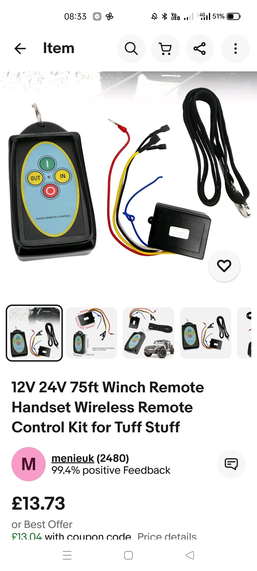

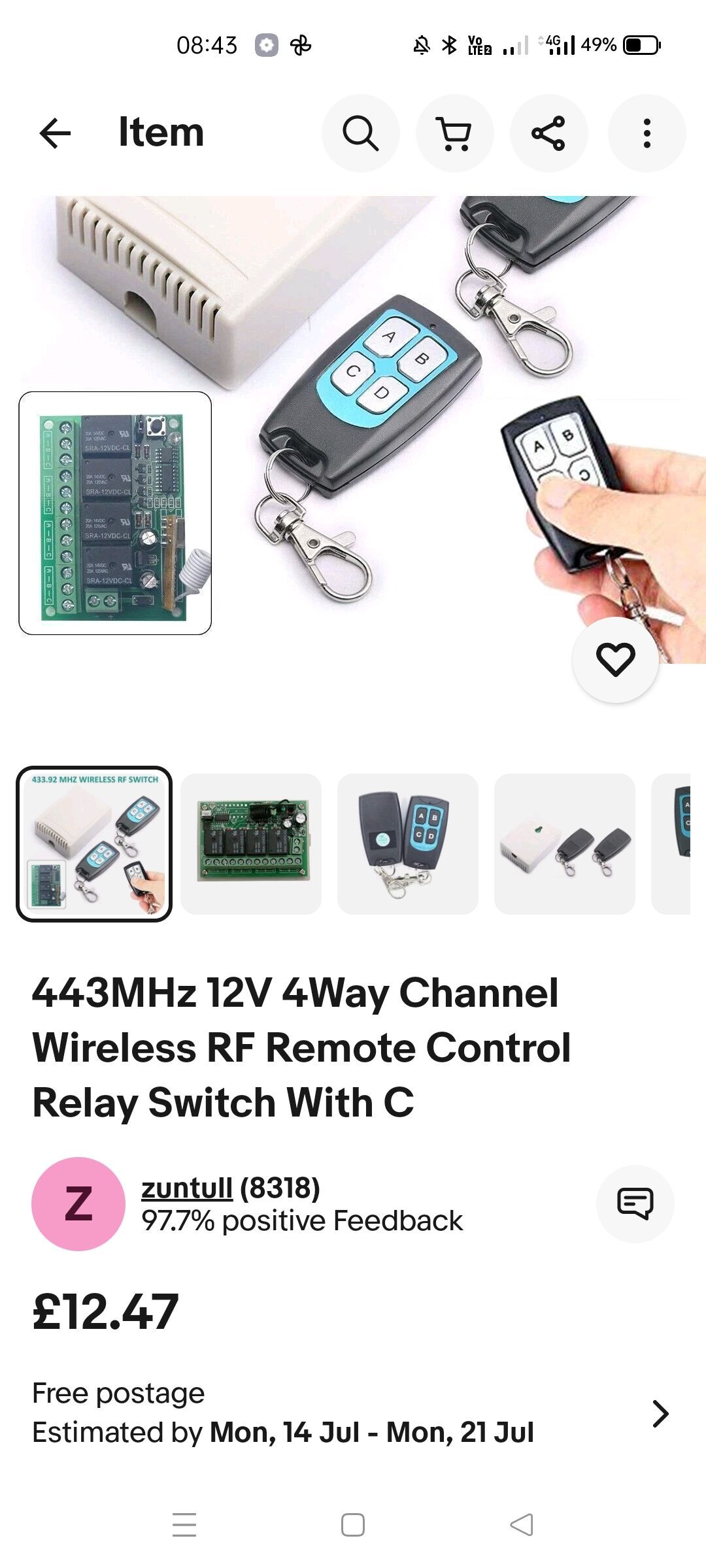

  1. I have two of them on different boats for many years and they have proved to be 100% reliable. I have also recommended their use to sailing friends who have also fitted them, been delighted and saved a fortune. One of my friends who has one on his yacht is currently sailing around Iceland, and he isn't concerned about reliability! But if you want to pay original manufacturers prices then that's fine too.
  2. Anyone who's bought a manufacturers own, or specific marine radio controlled thruster switch has wasted hundreds of pounds. I paid a bit over £10 for mine and it works a treat. I can even operate the thruster from the bank to draw the bow closer. On my lumpy water boat, I've used one of these to control both my bow thruster and my anchor windlass remotely. Easy to fit and has proved reliable for at least 6 years.
