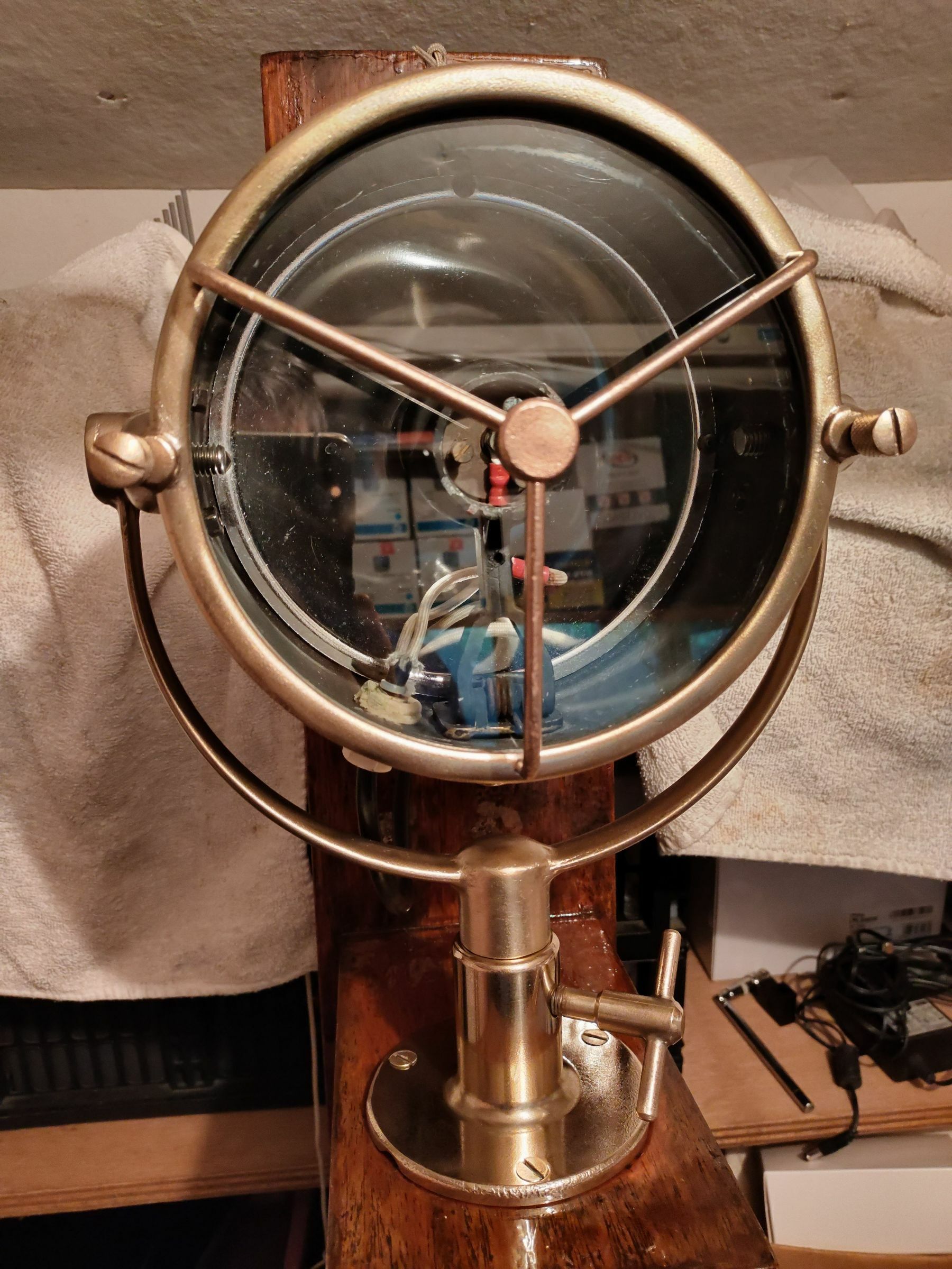

  2. I have been cleaning up the brasswork on my cratch frame. The brass is now lovely and bright and I would love to keep it this way BUT I am not a brass-polisher by nature. Should I varnish it (with yacht varnish)? Or should I lacquer it with something like in the photo?
