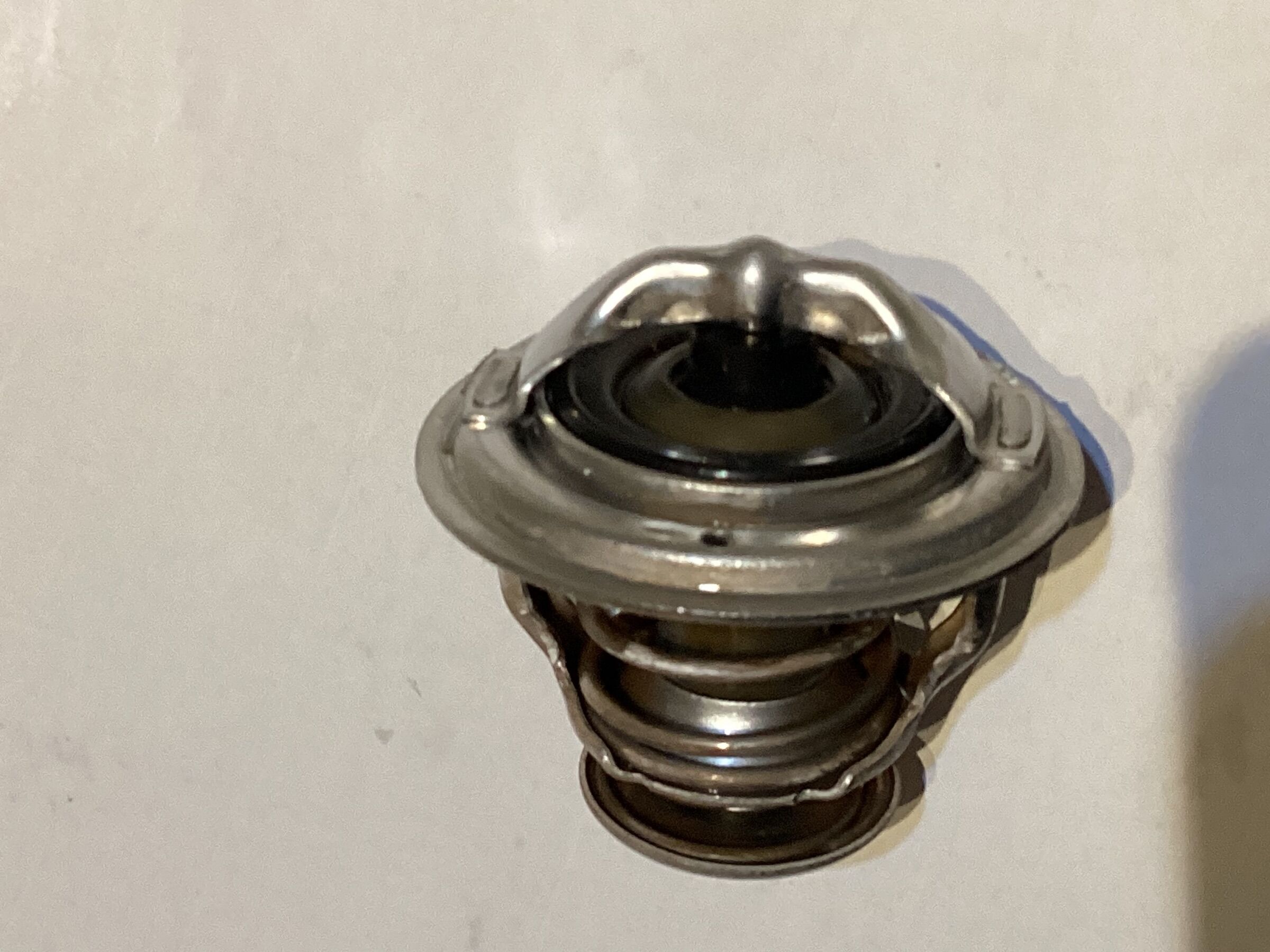

  1. I have just pulled the thermostat from my spare(almost new) engine in the workshop which I am sure is factory. Hope this helps. It has a rubber seal at the top. You should see the top open in boiling water or heat it up slowly in a saucepan and you should see it open before the water boils. You can see the quality of the jap oem stat they almost never fail in my experience
  2. Just one thing I forgot to mention and that is there were 2 different versions of the engine and I believe HMI may have used both one is the 4LE1 and the other 4LE2 ,one is direct injection and the other is indirect and although the same capacity use different cylinder heads and May use a different thermostat.
  3. I have a spare engine and will have a look at its thermostat and the weekend but I have a feeling it different to a standard automotive one in that it seals in two places. The cooling system (skin tank)is designed to dissipate at least the maximum waste energy of the engine which is approximately equal to the power output of the engine 40kw. At say tickover the skin tank will take all the waste heat away as it is produced and the engine should only get slightly warm and it will maintain this equilibrium indefinitely. It is extremely important to have the correct thermostat on a modern engine as it is designed both to reach and maintain the correct temperature and maintain thermal balance across the engine and avoid any thermal stress. Running without a thermostat in my opinion could cause head gasket failure and worse. Do you still have the old thermostat ? if so check if it has a rubber ring seal at the base.

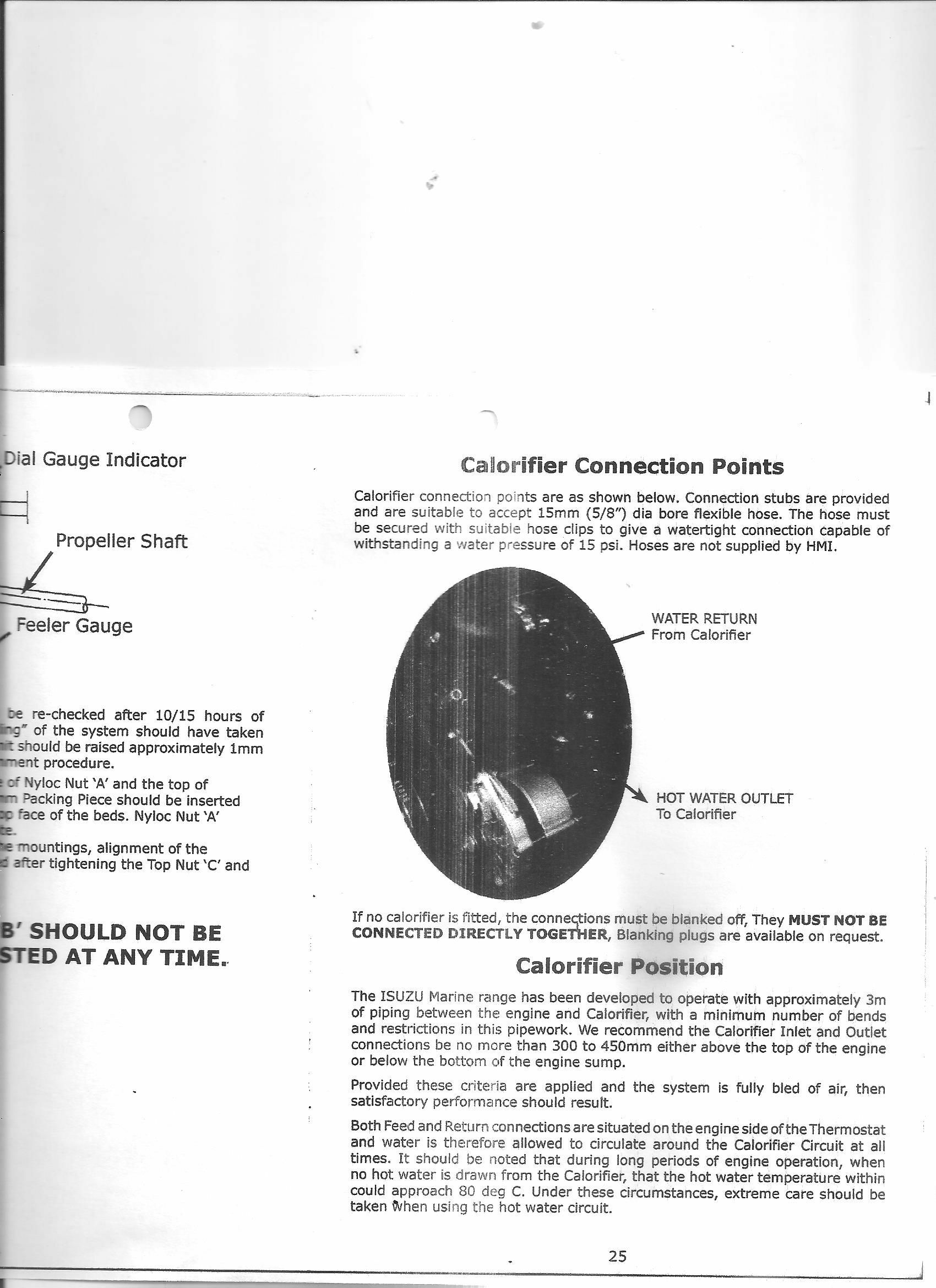

  4. If you run it without a thermostat nothing will get hot. If you are going to take the current one out just bung in a new one whilst you are at it. For some reason the thermostats for the 4LE1 are very expensive which makes me think they are slightly different. Try contacting Engines Plus who still supply the industrial version of the engine. I have attached the page of the manual in case you don't have it

  7. The calorifier should have two fittings,inlet and outlet, vertically above each other with the coil in between so the highest point is the higher of the two connections unless any pipe connecting to the engine is at a higher level so I would loosen the higher connection to release any air. I think that the temperature sensor is in the thermostat housing as shown in your picture and not on the cylinder head which means it might not be reading correctly the actual engine head temperature. I am not at the boat so I might be wrong on this there may be two switches one for the overheat warning lamp and one for the gauge sensor depending if you have a temperature gauge or not. I think it is unlikely but possible that calorifier loop is blocked but can be checked by disconnecting the engine connections and running a hose though it. hope this helps.
  8. I have found with this engine and my set up (with the calorifier higher than the engine) that even after the engine cools down it maintains some pressure in the system and you can bleed the calorifier from the highest point in the loop even when cold. I fitted a central heating type bleed screw. As you have probably read these engines are often subject to head gasket failure caused by over heating on skin tank cooled models so you really don’t want any air or air locked in the system or you could end up in big trouble. By squeezing the hose From the header tank to the thermostat you can help to get any air out. Make sure you have the correct thermostat installed correctly some can be put in upside down.
