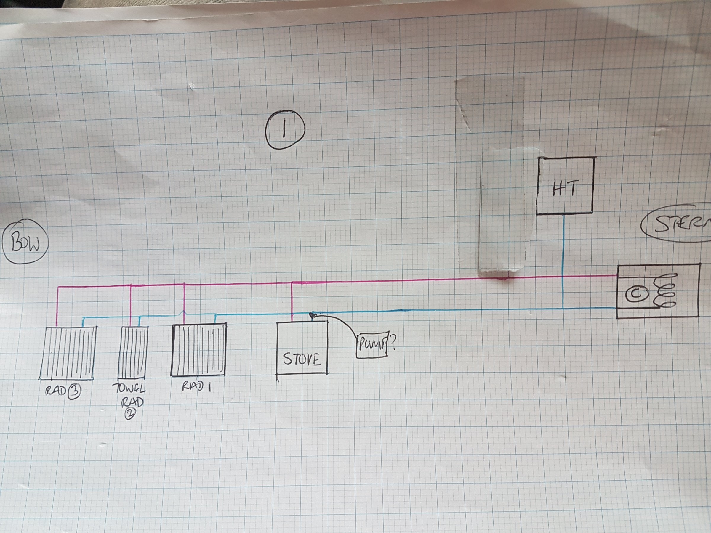

Many thanks to you all for your comments. I will take what I am able to on board so, control flow to calorifier with perhaps a gate valve, use bends wherever possible, and fit auto air release valves at high points, including in flow near BB. For lots of reasons pipework will be at floor level so I will have to be happy with the risk of a failed pump and let the header overflow, rather than try to induce thermosyphon. As Alan said it's not uncommon. Regarding Mike and Tony's comments the pump is this one https://uk.rs-online.com/mobile/p/central-heating-pumps/7066934/ Springy - could you expand on what you mean by "straight into the length of the running tee" please? I was thinking of bringing the flow straight to the wall with maybe a swept tee down to the floor level witn an air release on the non swept side and then swept side down to tee into main flow. See diagram. Ignore failed uploads see here https://ibb.co/mzqi7b Regarding comments about header - I should point out that the calorifier is on the shelf above the swim in engine bay so that is the highest point. And I've just seen Pete's response - i'm afraid I fall into the "but i can do some other way", I would just keep a spare pump and plumb the other in with service valves to effect a quick change. But may I ask Pete, are you saying I need a wide bore pipe between flow and header in my proposed system? Or only in the diagram you posted.? Thanks. -

Hello all. I would appreciate some input on this diagram. I have a Squirrel stove in middle of the boat that I want to feed 3 rads and a calorifier. It is only possible to pipe up one side of the boat so a flow and return circuit must therefore, I propose, be teed into the backboiler. In case it isn`t quite obvious, in the diagram the pump is in the return, pumping towards back boiler. The pump would be a Jabsco. The priority would be Rad 3 as hot as possible for as much of the night as possible, then Rad 2. Rad 1 would be in the cabin nearest stove so would spend most of it's life turned off. Then the priority would be hot water, and I was thinking by morning this may need the rads to be turned off to get calorifier up to a decent heat. Basically I'm wondering if the system looks reasonable or if the tees will cause issues. Cheers. -
