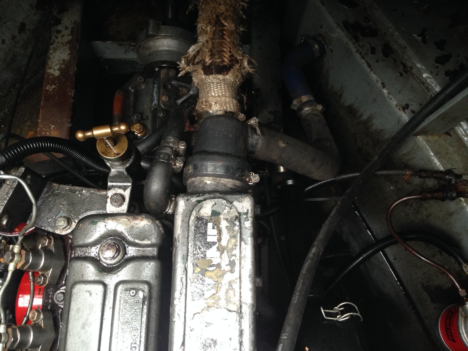

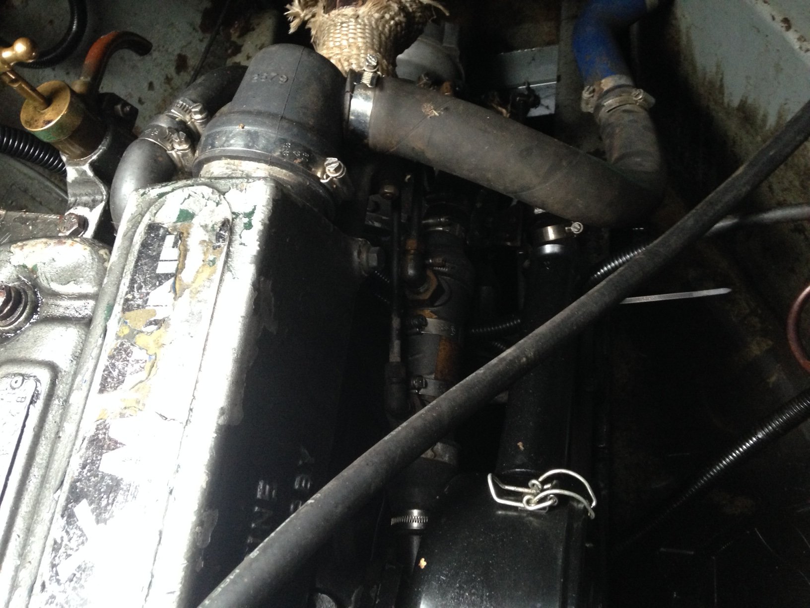

  10. Thanks Tony. this is an ex Ownerships boat of 1997 vintage. I think it started off with using raw canal water to cool and then was converted whilst part of Ownerships, along with all of the other boats. (I stand to be corrected!) I don't know if the pictures help? interestingly, today's cruise resulted in the header tank filling right up and then dripping out. The engine was working reasonably hard in a shallowish canal (Leeds Liverpool beyond Silsden) but no signs of overheating and the gauge on its normal 80. No signs of boiling or anything like that, the level just rose to the top of the tank and then dripped. So I'm wondering if the air pockets might have been filled and this is the result? The header is filled to the Min mark, about 1/4 full. Tony, if it's cooled directly from the skin tank then is it all one system and is the header tank effectively connected directly to the skin tank? i feel I'm learning a lot more than I expected this week! Thanks to all the tutors ......
  11. Cruising at the moment but it does have a skin tank and a Bowman exchanger. Not sure if it is now one sealed system, will post some pictures later.

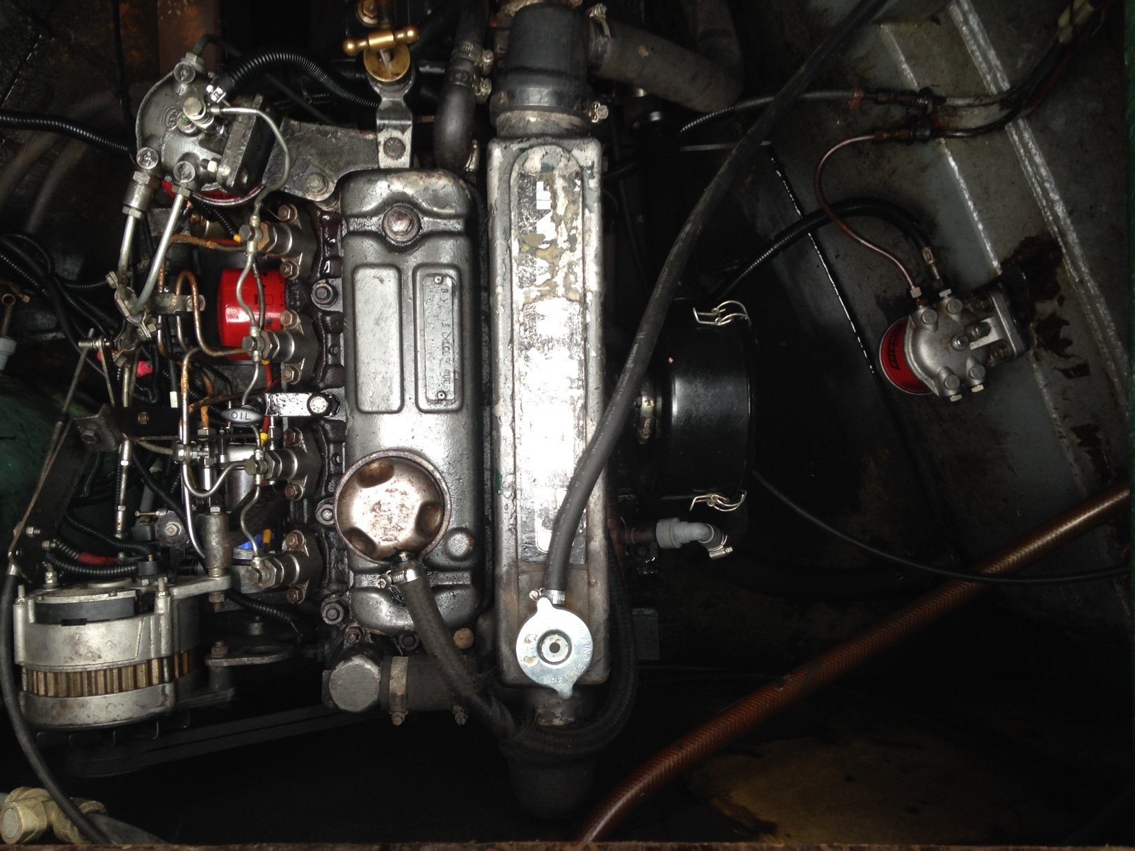

  12. Thanks for all your help folks, I've looked at it again this morning and I think the cap on the engine is indeed a blanking cap rather than a pressure cap. It looks just like the one in Alan's link and has a black rubber pip in the middle of it. No surprise really I suppose as our boatyard does do a good job, it was just my ignorance that assumed it was the original pressure cap. Still, the mystery is as to why we are topping up with water to a much greater extent than before the tank was fitted. Thoughts: 1. Co-incidence. I don't buy that one really. 2. Leaks in the new pipe work or tank 3. Leak exposed by the fact that we now have a coolant reservoir sitting higher than previously. 4. As in 3 but now filling previously up filled air locks. In which case it will stop at some point. I'll keep looking and report back when it's solved!
  13. I need to have a good look at it but I think the flexible pipe is connected to the collar below rhe pressure cap. No idea whether the coolant was drained, its possible.

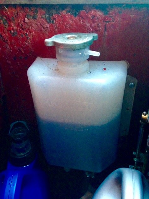

  16. Thanks Alan Firstly, we fitted the header tank (or more accurately had it fitted by the boatyard) because we had been concerned that it was quite difficult for owners to correctly judge the proper level to top up to. One of our previous engineers had suggested that it could be overfilled with dire consequences and I felt that this could lead to underfilling. We have had a couple of unexplained overheating episodes. The header tank has a pressure cap on it and the feed goes to the engine and to the collar below the pressure cap. So, yes, the header tank is part of the pressurised system. I've watched it whilst the engine warms up and the level gradually rises as the engine warms up. It's all been fitted professionally and looks good. I've tried to see if there is any leak from the tank but it's difficult as the locker it's in does get damp from the rain. If we have a dry spell then I'll try again. Finally, we are in the middle of a 5 week cruise which is why I've not consulted the boatyard that fitted it. If it is gradually getting rid of air locks in the system then I guess it won't go on forever.
  17. Not sure I follow that? The header tank is topped up to the mark when cold then the level rises when the engine gets warm. The level doesn't get to the overflow then settles down when cooling - but to below the original mark.
  18. We have just had a header tank fitted to our BMC 1.8. Before this we didn't seem to be using any water. Since fitting the tank we are losing about 1/2 pint each day. We even lose water when the boat is just on the bank without the engine running. i can't see where the water is going. I wonder whether we had an air lock in our skin tank and whether having a header tank higher in the system than before is gradually filling this up - in which case I guess it will eventually stop. Any thoughts would be appreciated!
