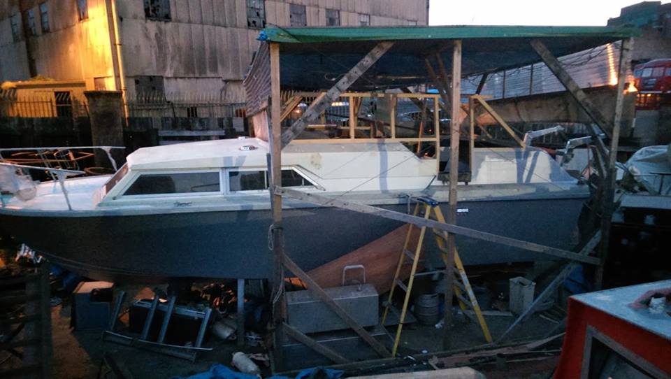

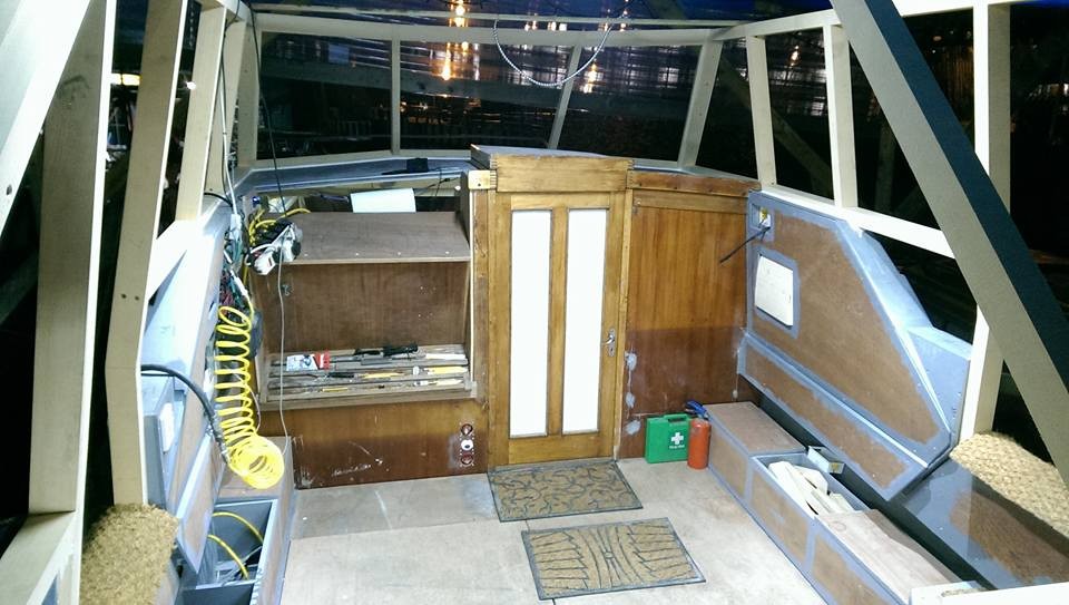

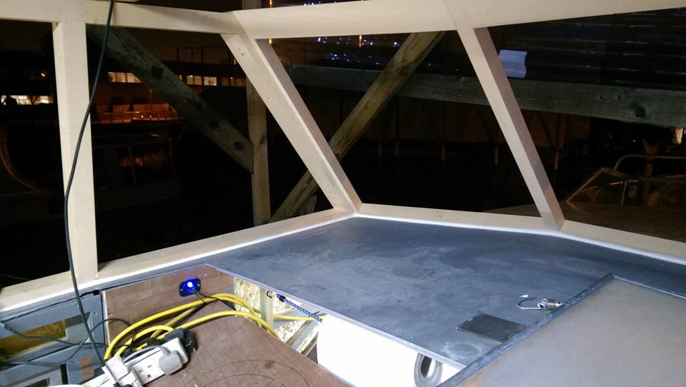

Hi all I'm struggling somewhat trying to source info on the type of glass I should use for the frame work I've had done to the hard top conversion that replaces the folding canopy. As a liveaboard and a semi plaining displacement hull I'm concerned about any weight added and making her top heavy. The frame work was built with imported White Cedar and is as light as we could make it. 1) I believe she is a Category B rated boat, do I require 6mm Toughened Glass for all panels or can I get away with less thickness?. 2) I understand water pressure from rogue waves in bad weather could be an issue with less. Would I be ok replacing the forward facing five panels with 6mm (as was originally fitted) ? 3) Are there any regulations that need to be followed as a private boat builder, if I'm going to sell her later? I plan to keep her for several years while saving up for a larger boat and do some sailing on the continent. Thanks in advance Chas
