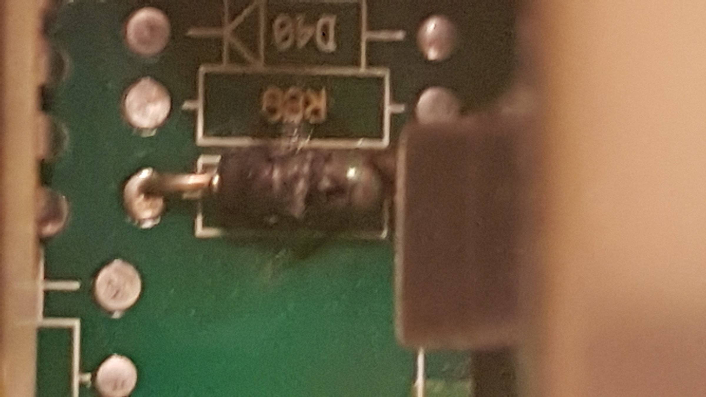

Ok i'm thinking as nicknorman says there may be a slight chance that with more modern protection the failure may have been restrained and I may take a punt at a repair attempt, checking the FETs and replacing, replacing the small electrolytics and any other failed components I can identify before having to part with a serious amount of cash. if by any chance anyone has access to a Mass Combi 2000/12 that they can take a photo of that burnt resistor so I can see the value it will help :-)

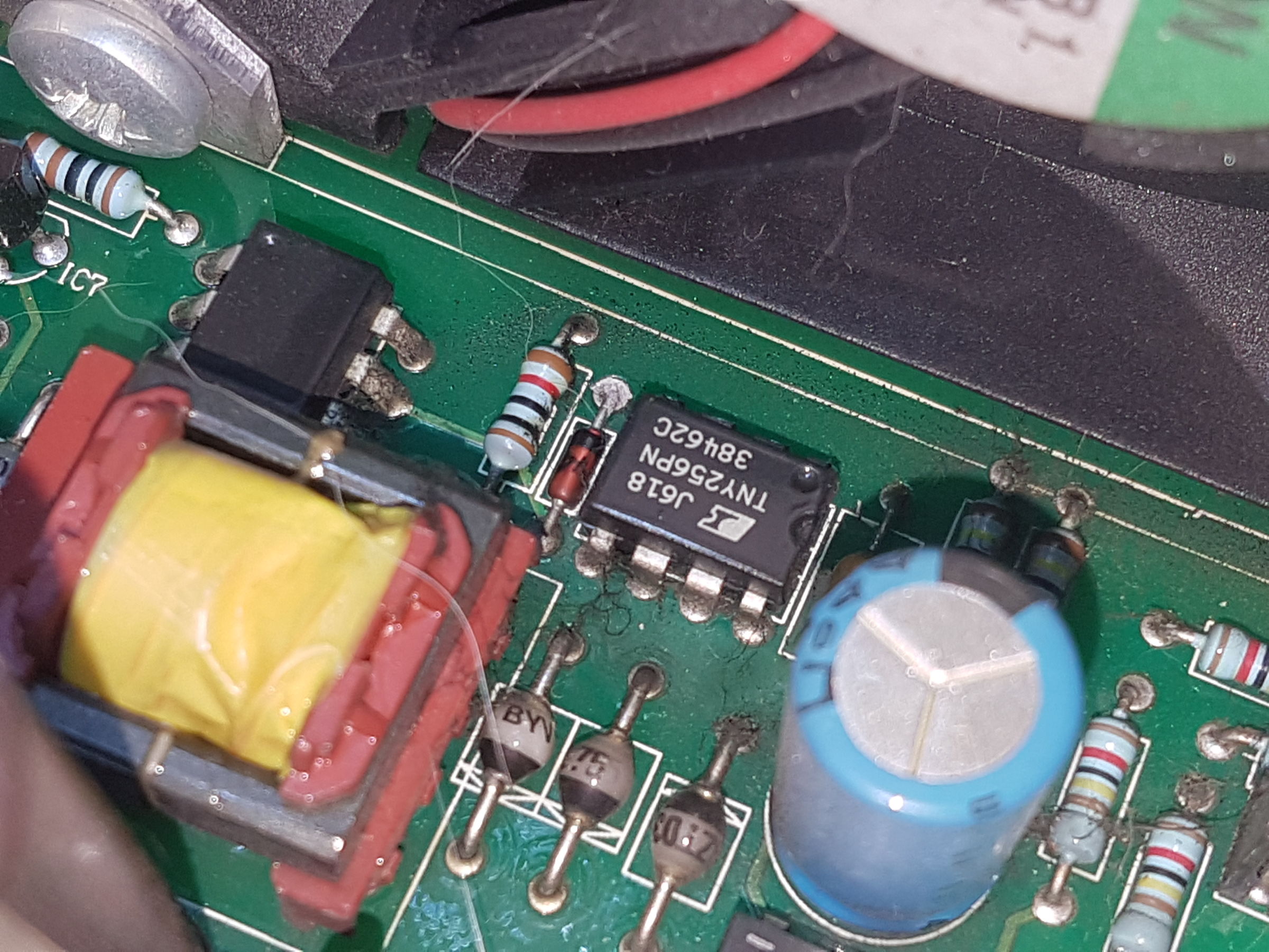

Thanks SeaDog. Yes please see if you can find the details of the firm that takes on the repairs. And let me know when you decide what you are doing with your old one i may be interested if you wanted to sell. Thanks nicknorman and WotEver. Yes i will check all the components around the FET and failing electolytics somwhere was my 1st thought that may have caused the initial symtoms of the psu not starting that I assumed was marina power issues. But alas unless im lucky here experience tells me im likley going to find its an snowball effect failure with many components effected and unless you have direct experience working on these units you are likley to get into repeat loops of replacing components before any hope of getting to the end of the repair......or maybe im just being pessimistic. Anyway its comming back with me today and think i'll have a go at repairing it before getting another firm or Mastervolt involved. I have got a cheap chinese 3kw inverter that has a 10a charger that ive neveŕ used ( bought for a cruiser i had) i may throw on for now.

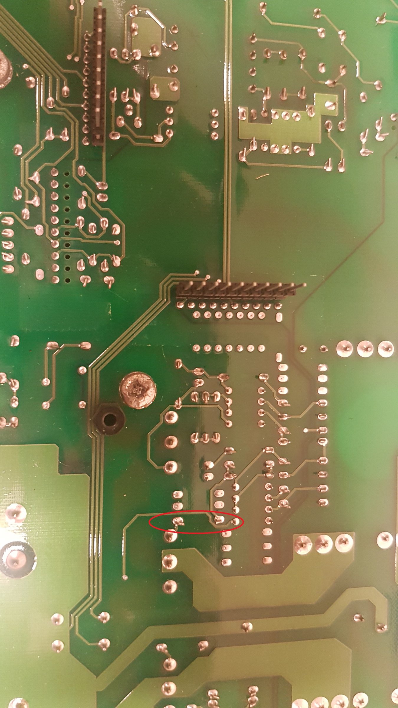

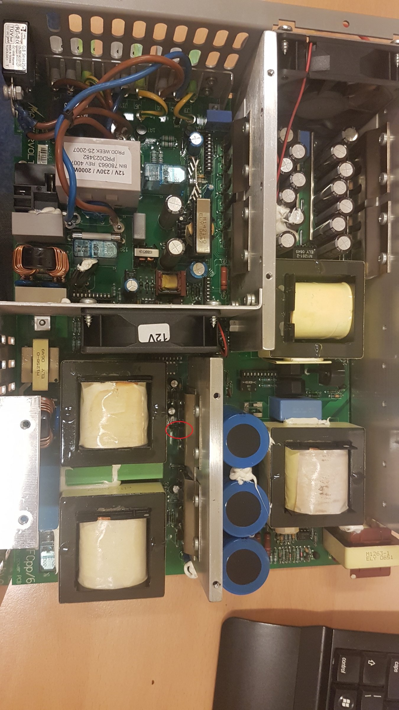

A bit of an update... I had 10 mins to kill today so took apart the combi for a quick visual look for anything obvious. Only thing I could see was a burnt resistor that appears to maybe be part of biasing for a FET I stress this was only a visual look, I didnt have so much as a multi meter with me to go further. I have attached images with the offending resistor circled in Red! Im thinking that this looks increasingly bad :-(
Thanks Sea Dog for the info, I think mine is discontinued too, its the 2000/12 (i think the current model is the 2200/12) so the fixed fee repair prob wont be available to me :-( I'm actually an electronics engineer so will prob have a look 1st although you usually find when these types of heavy current equipment let go they usually do in a big way and unless you are familliar with the particular fault trates you can end up killing lots of time & replacement components before getting to the route of the problem (I never have been a fan of working on switch mode PSU's......) Thanks Mrsmelly, you may be on to something there, I'm considering options and may have to look at the Sterling route....

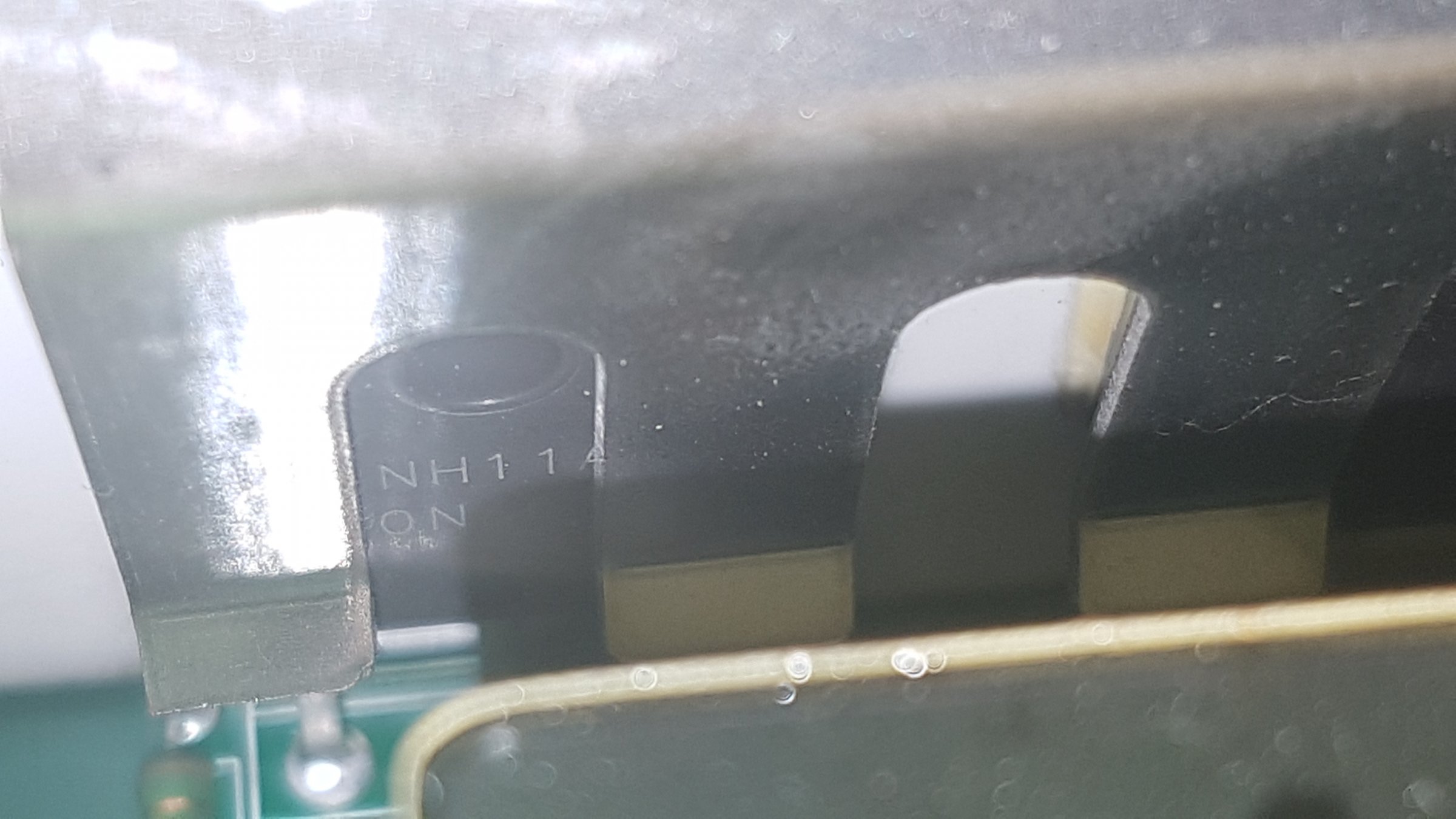

Thanks nicknorman, i'm going to remove it today and take a closer look
