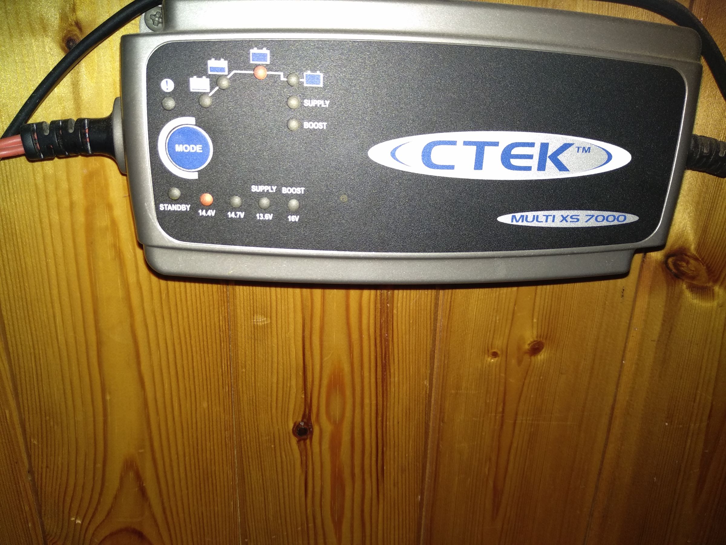

  1. Thanks to all replies. Seems it's a good bit of kit but....After leaving it on all night it's still showing the same lights. After exploring the 'mode' button it seems to cycle round. 1, standby no battery symbol. 2, 14.4v it seems to check state and flips to 3/4 battery symbol. 3, 14.7v again checks status and settles on 3/4 battery symbol. 4, 13.6v(supply) and the battery full symbol. 5, 16v(boost) and the batter full/boost light. On the instruction download I can't seem to find anything about the 'mode' button and what ' mode' to leave it on. Any advice would soon be welcome. Thanks
  2. My month old adventures into the world of narrowboats and continuous cruising has been temporarily put on hold as I have had to enter in to a marina for a couple of months. (Health issue) Now I have shore power available and not just my engine, my query is regarding this CTEC multi X's 7000 gizmo. Boat electrics, and my knowledge are basic, no dials, meters etc. Only 2 x 240v sockets. Will this CTEC 7000 plugged in to it's seperate socket keep the leisure and starter batteries topped up? Can you leave it plugged in all the time, as it indicates on some websites I've been looking at? I've just switched it on and is now showing 2 amber lights one is, 14.4 volts and the other, battery 3/4 full. I am assuming it is 'hard wired' into the batteries somehow as I hadn't been able to trace the wires yet. The previous owner had the boat in a marina 24/7. Any advice from you knowledgeable guys and gals would put my mind to rest. Thanks
