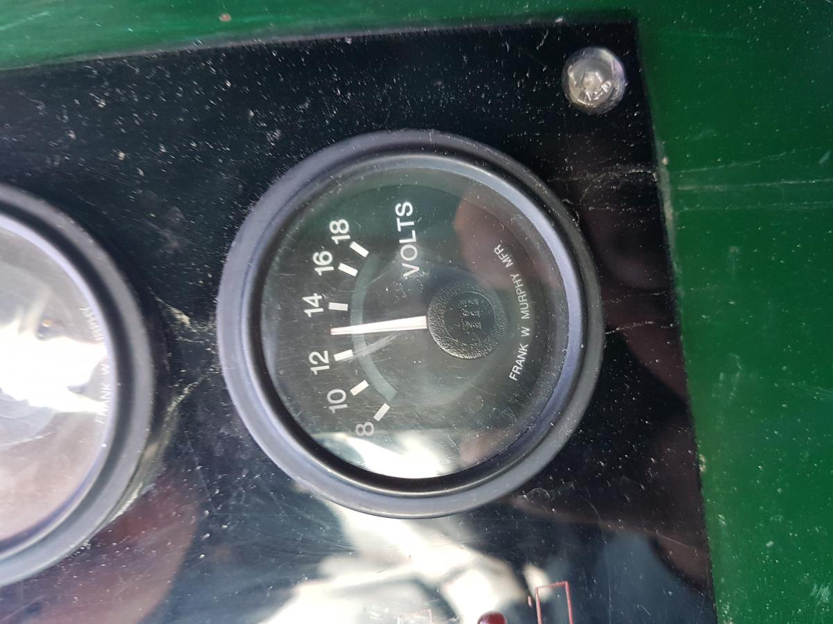

  8. I have just noticed that the volt meter is Pulsing, batteries are keeping good charge. Never noticed it before.

  25. Just wondered can anyo5help on this one please
