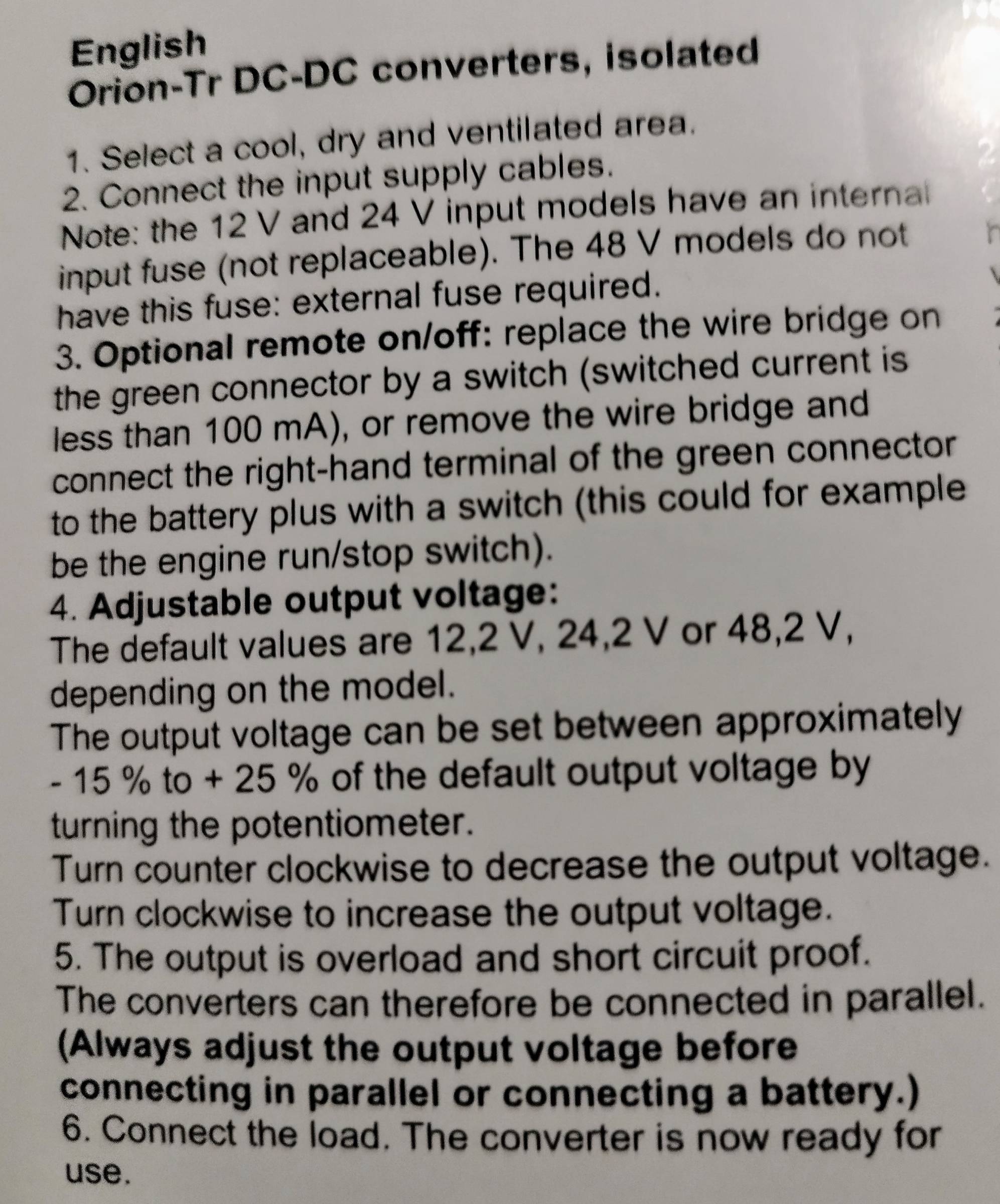

  9. 48 minutes ago, blackrose said:
    Right, that makes sense, thanks. I was looking for a dial on the unit which it doesn't have so I assumed it must be in the app.
    Because it has an internal fuse I don't need to add any fuses?
    Remember that the fuse is there to protect the wiring, not the box! Fuses are needed to protect against a battery short circuit. So in principle the positive wires to each battery should be protected by a fuse close to the battery (but not actually in the battery box). But IMO a risk-based approach would mean it depends on the distance from the batteries to the box. If it is short with no feasible prospect of a wire chafing/short circuiting/getting ripped out by standing on it etc, then probably a fuse can be avoided. But I think the “correct” answer is to fuse it at both batteries.
    Edit: The manual specifies a fuse at each battery so that is what you should do.
  10. 50 minutes ago, blackrose said:
    I'm a bit confused about the instructions for this Tr Smart 12 / 12 - 18. Although the one I've got is a charger the instructions that came with it are for a converter.
    Firstly, I know it says optional but just to be clear, is there any need to fit a switch at all? Can't you just switch it on/off via Bluetooth if required?
    Secondly, in terms of adjusting the output voltage; if it does behave like a mains charger then I assume the adjusted output voltage is the maximum or absorption voltage? Does it then automatically know what the float voltage is based on the max voltage set? Something doesn't seem right.
    I assume the potentiometer is on the app which you can set when the unit is powered up, but then it tells you not to connect a battery until you have set the output voltage? Does it mean connect the supply battery but don't connect the load battery? Scratching my head. The instructions could be clearer.
    Picture of the unit
    It’s the wrong instructions, so not too surprising that it’s confusing! I doubt the charger version has a potentiometer (which is a hardware thing on the box). I would connect the supply battery then have a look at the settings on the App, make appropriate settings before connecting the battery to be charged.
    The instructions for this device can be found here https://www.victronenergy.com/upload/documents/Orion-Tr_Smart_DC-DC_Charger_-_Isolated/34439-Orion-Tr_Smart_DC-DC_Charger-pdf-en.pdf
