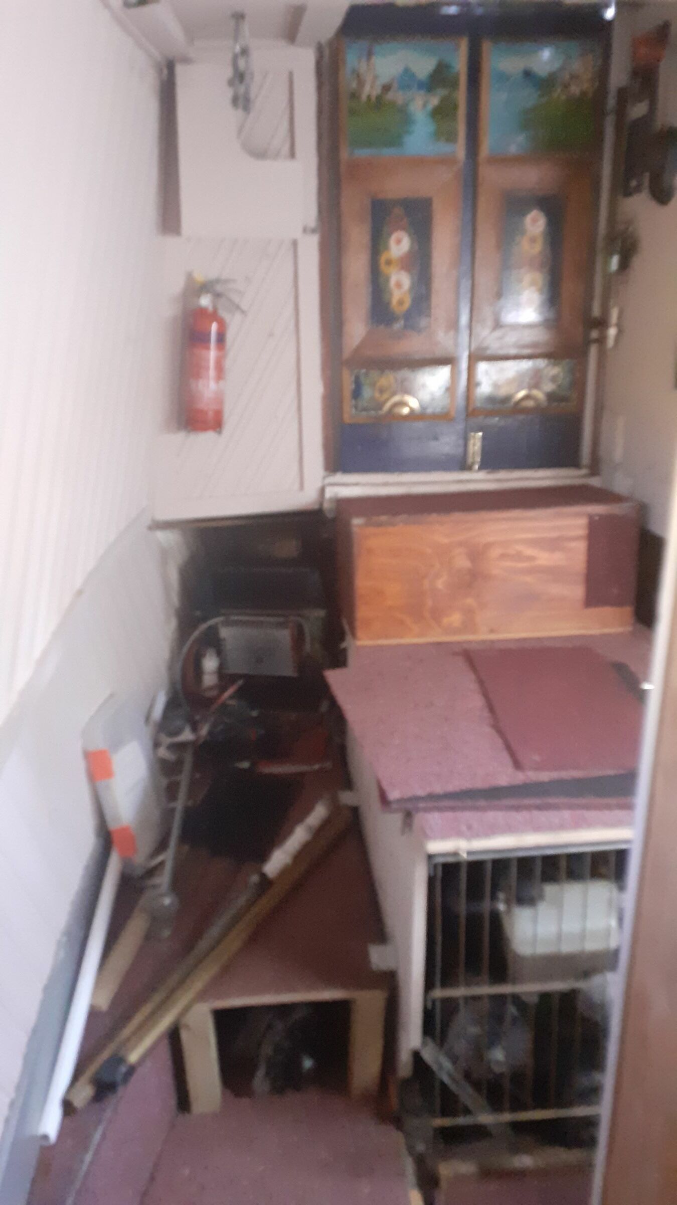

Hi guys, Thanks for all the recommendations. Below, is the rear of the boat from the inside. Just a white wooden box over the engine and no bulkhead across the boat. I think the wooden box will want to be replaced with something more like what you guys have shown already. What ways of making the detachable engine access panels so they won't rattle with the engine? Also what/how much sounds damping is practical and not o.t.t. with no real benefit? Thanks again James
