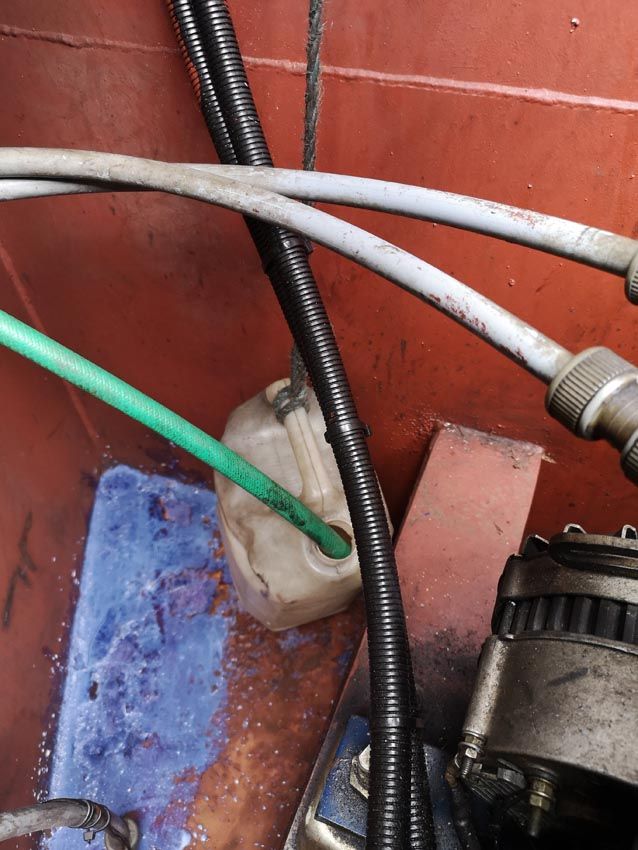

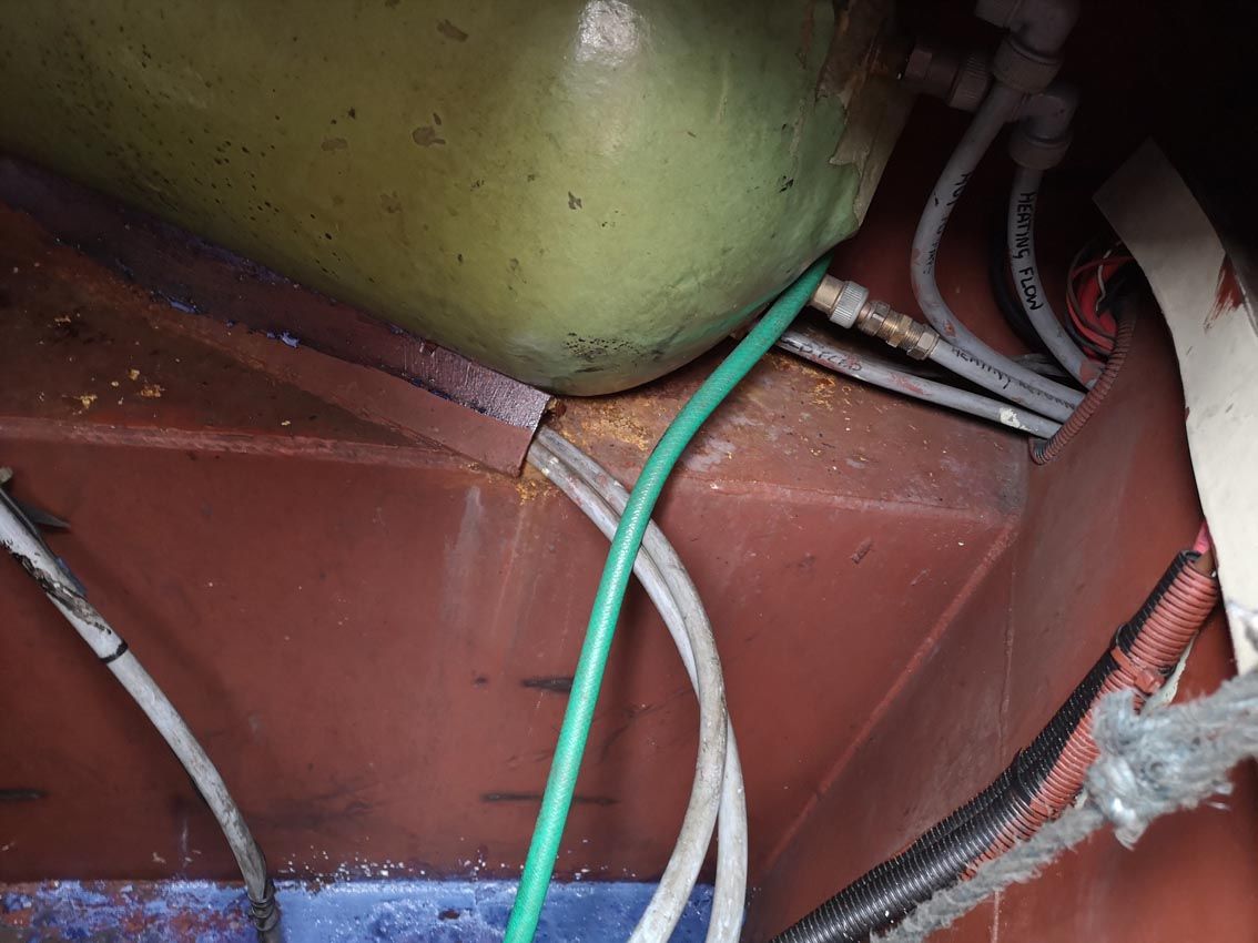

  7. I'd very much appreciate some help. I have just bought myself a narrowboat and have been on it for week. Everything seems fine and I'm very pleased with my purchase. However, there is one thing, which may or may not be a problem, that is puzzling me. From the calorifier/water tank in the engine bay is a hose leading to a suspended container which filled with clear water and overflowed into the bilge over a couple of days. I emptied the container yesterday and there was an inch of water in the container again this morning. I have no idea of what is going on and I was hoping someone does. In case it helps I have a gas fired boiler and central heating. I've attached photographs (ignore the Fertan)
