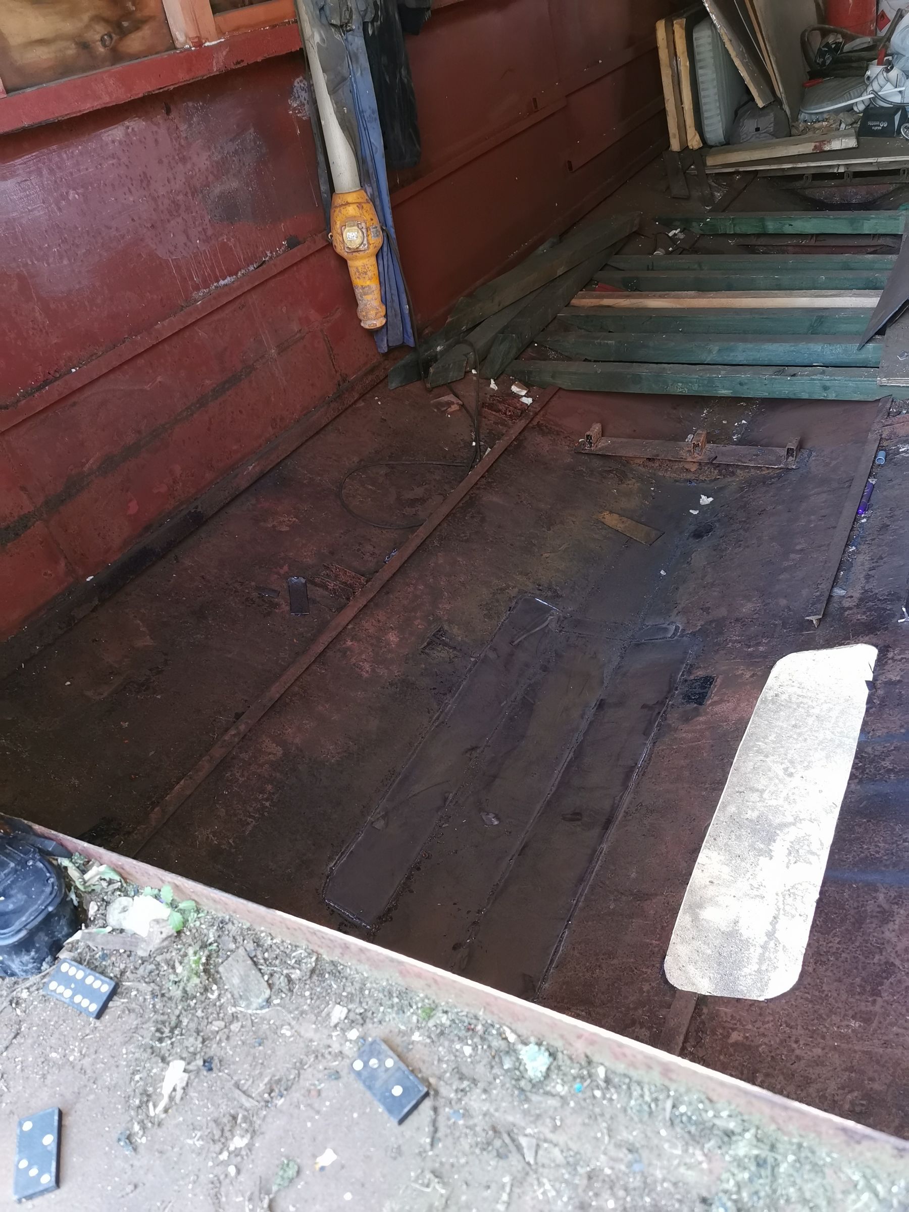

  1. Haha indeed. When we bought this boat it had many strange discoveries inside it, and outside covered in domino's lol. Luckily it's all cleaned and empty now, though our trailer is now full of rubbish and the tip won't let us on with it

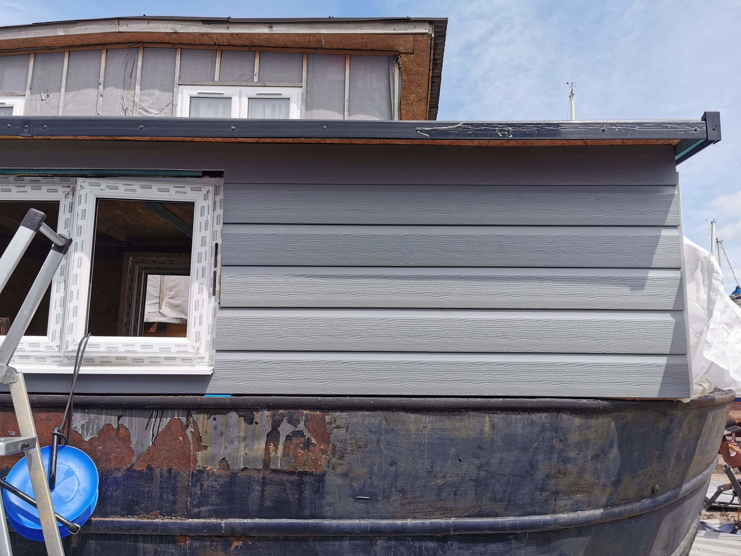

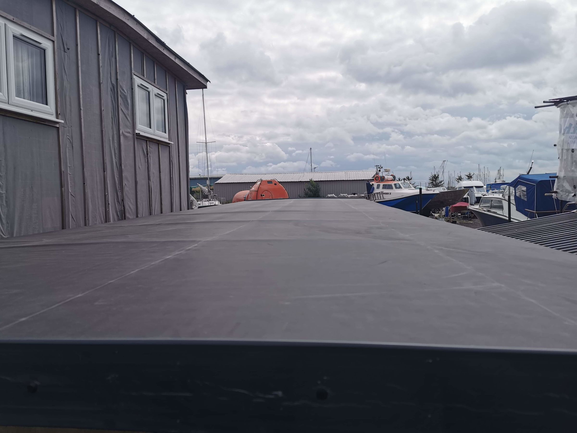

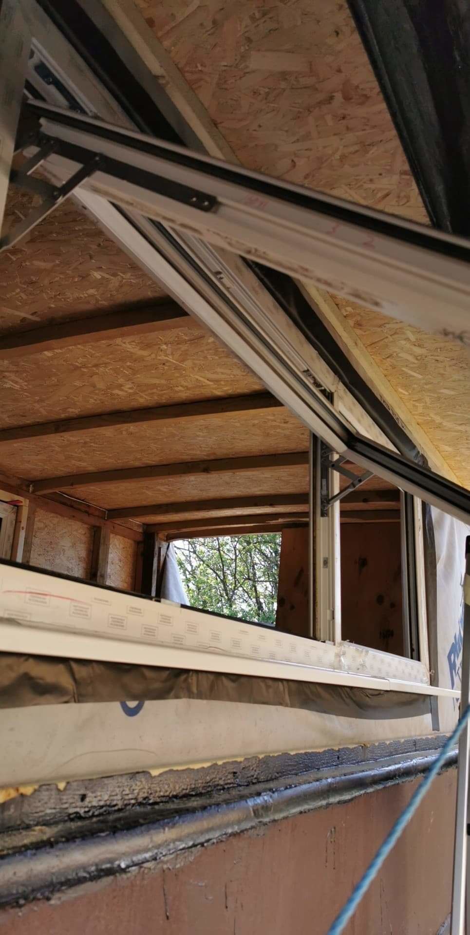

  4. Hi all. I posted here back in January with a rather big project. Didn't get started working on it until late March and have been chipping away at it between work. It did have 2 holes in the bottom, quite large actually. We've have these sections cut out and replaced, not just a bit of metal plopped over it. We are having final bits of welding done to it this week so we can get everything on the Hull ground down and painted. Anyway, for anyone that remembers it is in fact a wood top boat. Everything apart from the welding is self done (I got a marine welder in for below water line) and every bit of the top has been replaced. It has regular double glazed units (glass is there ready to be fitted and large front window with emergency Hatch arriving tomorrow) along with Upvc cladding on the exterior. To seal the wood top we have very thick liquid rubber between the Hull and the wood. The roof overhang will also help keep the nasty water away. Roof overhang you ask? Yes. But I will be putting on a rather wide rub rail along the edge. That will also protect the corner and keep everything damage proof and stop that roof catching on anything, not that this will really be leaving its residential mooring spot. Here's where it's at so far anyway, from how we got it to how it is now More pictures which are from today

  5. Cheers for the responses. I can't reply individually or I may be here all day. We have had a look into what's required and will be doing things by the book. As for sinking worse case is the first spot the residential yard has offered is when it's done we can be put into a mud berth, not very far to sink but I don't wish to find out exactly how far. We have access to someone who has been marine welding for nearly 25 years. I think the point was missed about testing the thickness for metal, we have someone to test this for us who is not doing a official survey. This is so we know what points are affected so we know where to carry out the repairs.. The costly official survey will be carried out after its done. I must apologise for grammar. I eagerly left school with not very good results to do a trade and spent too much time I'm my youth buying old cars to learn how to fix and building things ? . My girlfriend normally proof reads everything but I thought I'd get away with it on here.

  8. Thanks for the reply. Yes your right it does look like 4mm. I did have the same thought about access and have a few ideas in mind to make this easy without it being noticeable that the floor can be lifted. We had the idea to use poor man's fiber glass curving over the edges where the wood is attached, try and stop water sitting in these areas and seeping through. We've had some good results with poor man's fiberglass in the past and epoxy fiberglass around the leaky windows and doors, we also want to fit roof hatches so this will have to be done also. It's a bit of a risk but manageable. This engine isn't as massive priority just yet as it will be put on a residential spot and I doubt we will really move it from there, but I am a motorcycle mechanic by trade and was previously a car mechanic so shouldn't be much issue to get it going if it's just been sitting for awhile. This is the reason why I want to get the hull done to top standard and treat the inside and outside so really I've only got to pull it out of water when it needs to be blacked and not have any major headaches.

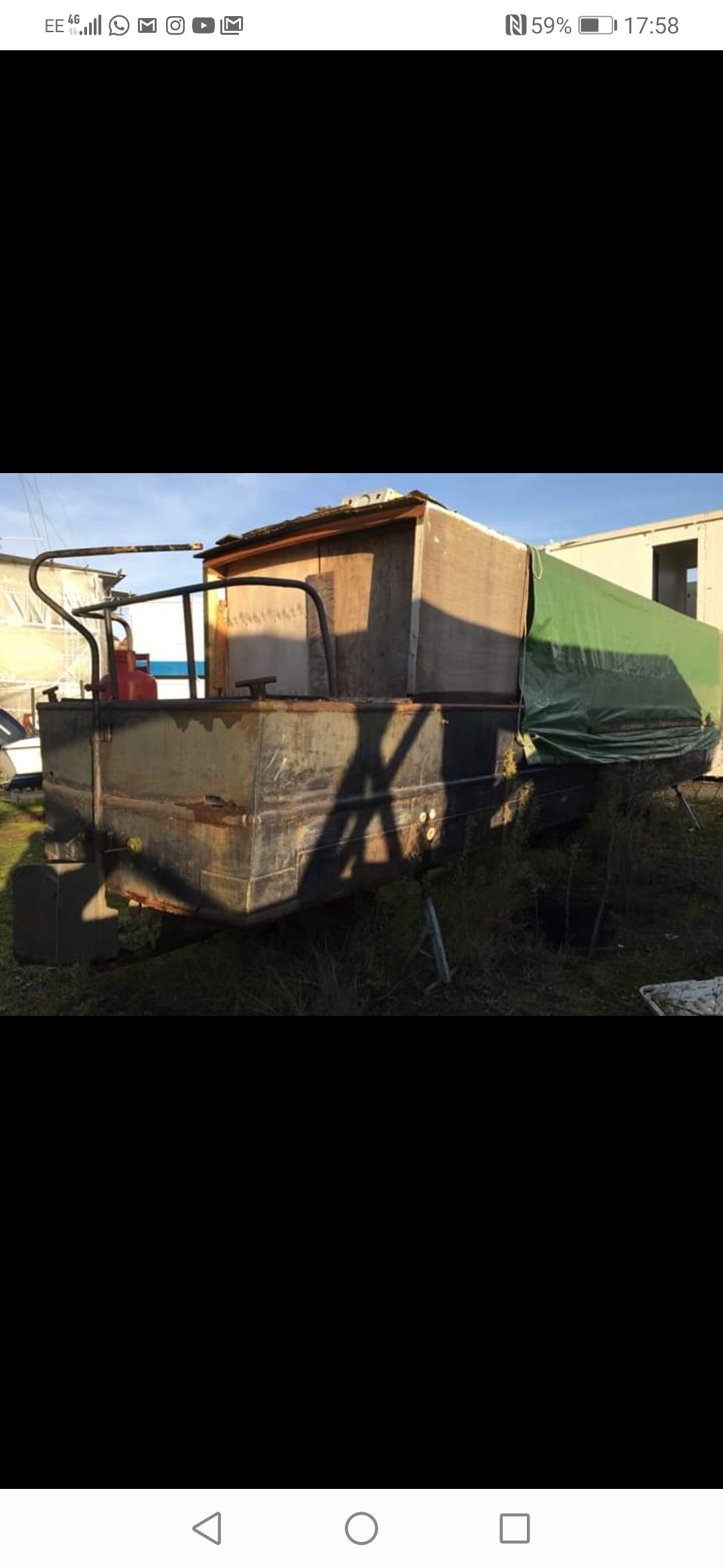

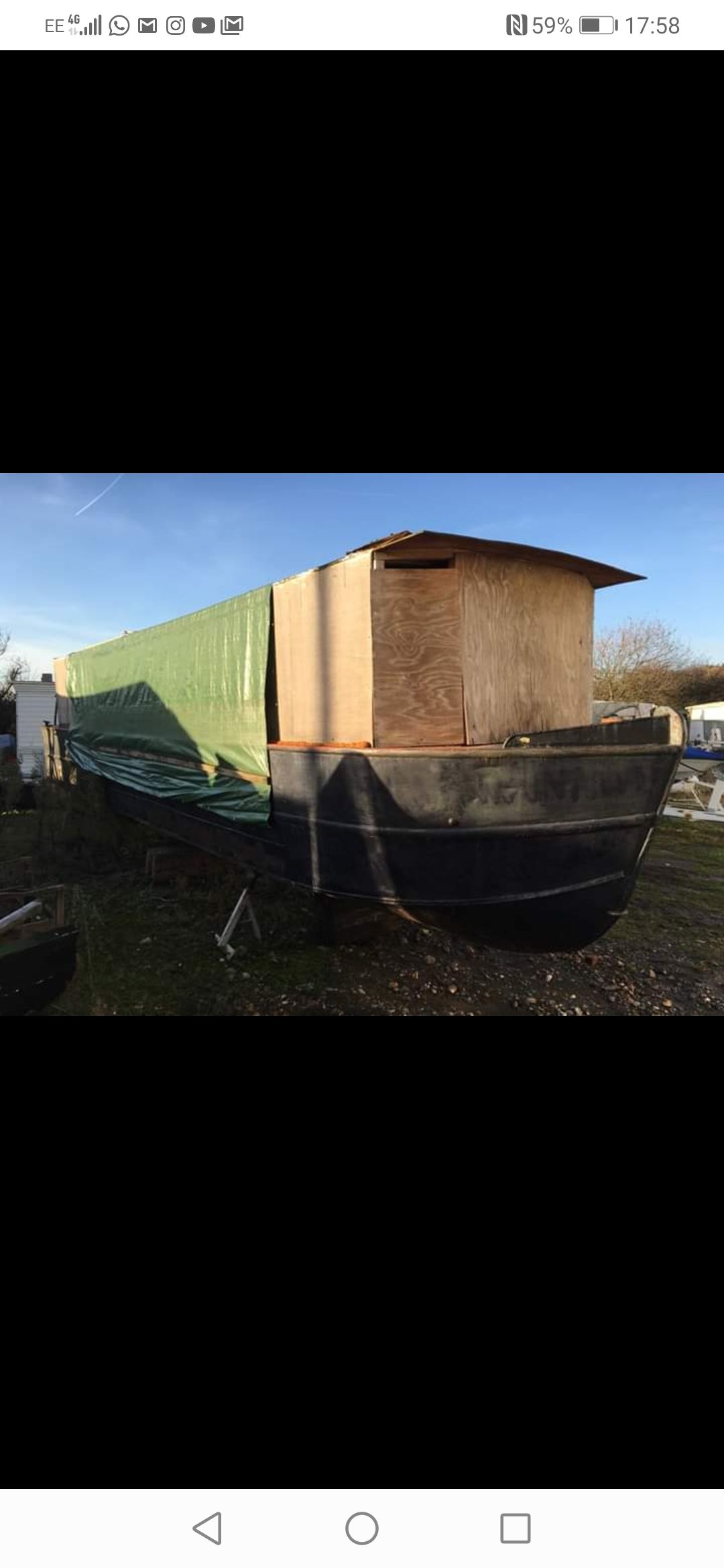

  9. Hi. Myself and my girlfriend have just bought a cheap 30ft narrow boat to turn into a live aboard. Because of length this is more of a tiny home I suppose. We took a bit of a risk and paid £900 for it with 6 months storage free. Reason it was cheap is it was sold for the price of unpaid fees, but it does need a lot of work! Although we knew nothing about the previous owner we can see he had the intention at some point to finish it and put it on water. Its packed with new insulation boards, lots of timber, sealer, tools, sheets of steel, windows and pretty much everything else needed, even a shower unit and shower tray not fitted. Pretty much everything. The is a few issues with it but rust is a major one! The bottom steel has rusted from the inside out leaving some rust holes behind. Its kind of a v-shaped hull so instead of the bottom being totally flat it has a small dip. I will post pictures tomorrow as its a bit hard to explain but this is the affected area where water has been sitting. The rest of the steel seems okay and no sign of any pitting under the paint. It also has never been re-plated so this is another option I suppose, but personally I'd rather cut out problem areas and replace. I also know there is mixed opinions on both options. We will be carrying out all the work ourselves apart from the welding (I can weld but rather have an experienced marine welder do it all and we just do the cuts and prep) but this is also slightly different to usual narrow boats. The top half is wooden rather than steel that we have mostly seen, this is fine and makes things easier on our part though a little more up keep. One question I have is ballast. How do I calculate such a thing on a boat like this? We've looked at different types of ballast and feel the engineering blocks is probably the best and easiest method but how do we calculate how much weight we will need on board? Any suggestions will be great and we will keep this post updated with progress. We are hoping for around a 3-4k budget which sounds tight but seeing as we are carrying out the work ourselves this should be manageable. We just need the hull sorted and treated inside and out before the extras come into play. Thank you
