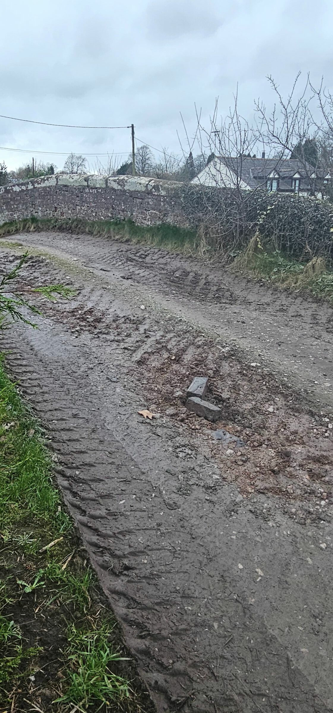

  5. After today's 8 hours of slurry tankers this is now the state of the bridge

  7. This is where it may become tricky. It's not clear who owns the lane and when we bought our house the solicitors could not determine who actually owns it! The bridge is CRT and the lane is a bridleway as shown on the council website. I've no idea if this means the council should do maintenance on the lane as its bridleway or not because they haven't touched it in the 6 years we have been here. To be honest it would be pointless doing any maintenance on it because the endless tractors would just churn up any gravel etc. This is the lane towards the farm having come over the canal bridge so as you can see the bridleway is in a pretty poor state. Note that the pic of this is an old disused railway bridge not a canal bridge.

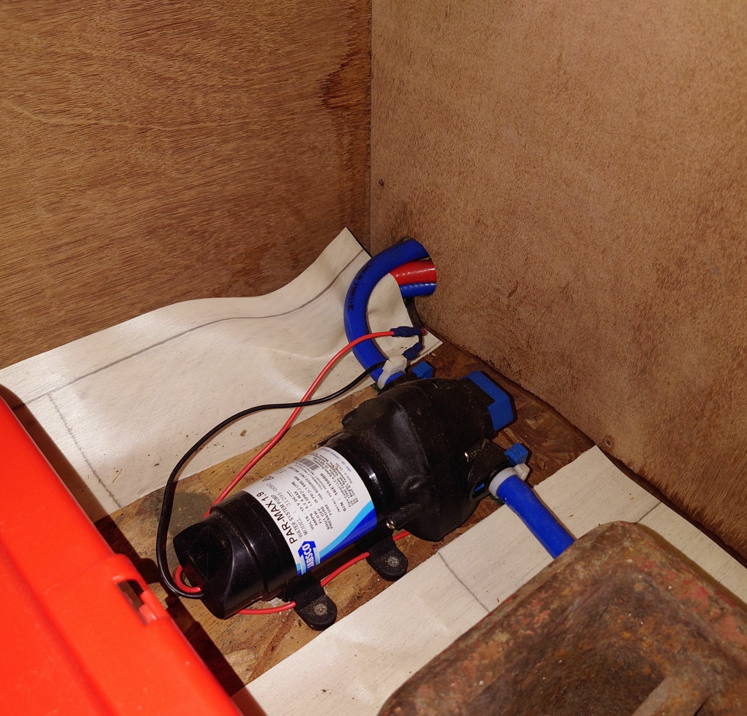

  14. I managed to get it second hand although it's brand new in the packaging and it's never been installed I'm hoping to put it in later still expensive for what it is but fingers crossed.
  15. I believe this is a compression fridge. I did read about absorption fridges on another post and that led me to realize why the cheaper ones were well, cheap! I guess there is a reason the Dometic Waeco ones are expensive! They seem to hold their money well, even second hand!
  16. Has anyone got any experience of this fridge? We are on 12v and we are looking for a decent replacement and we have seen the cheaper alternatives on Amazon etc but know they aren't good for battery and we only have our domestic and starter and a solar panel so we want something decent that will last.

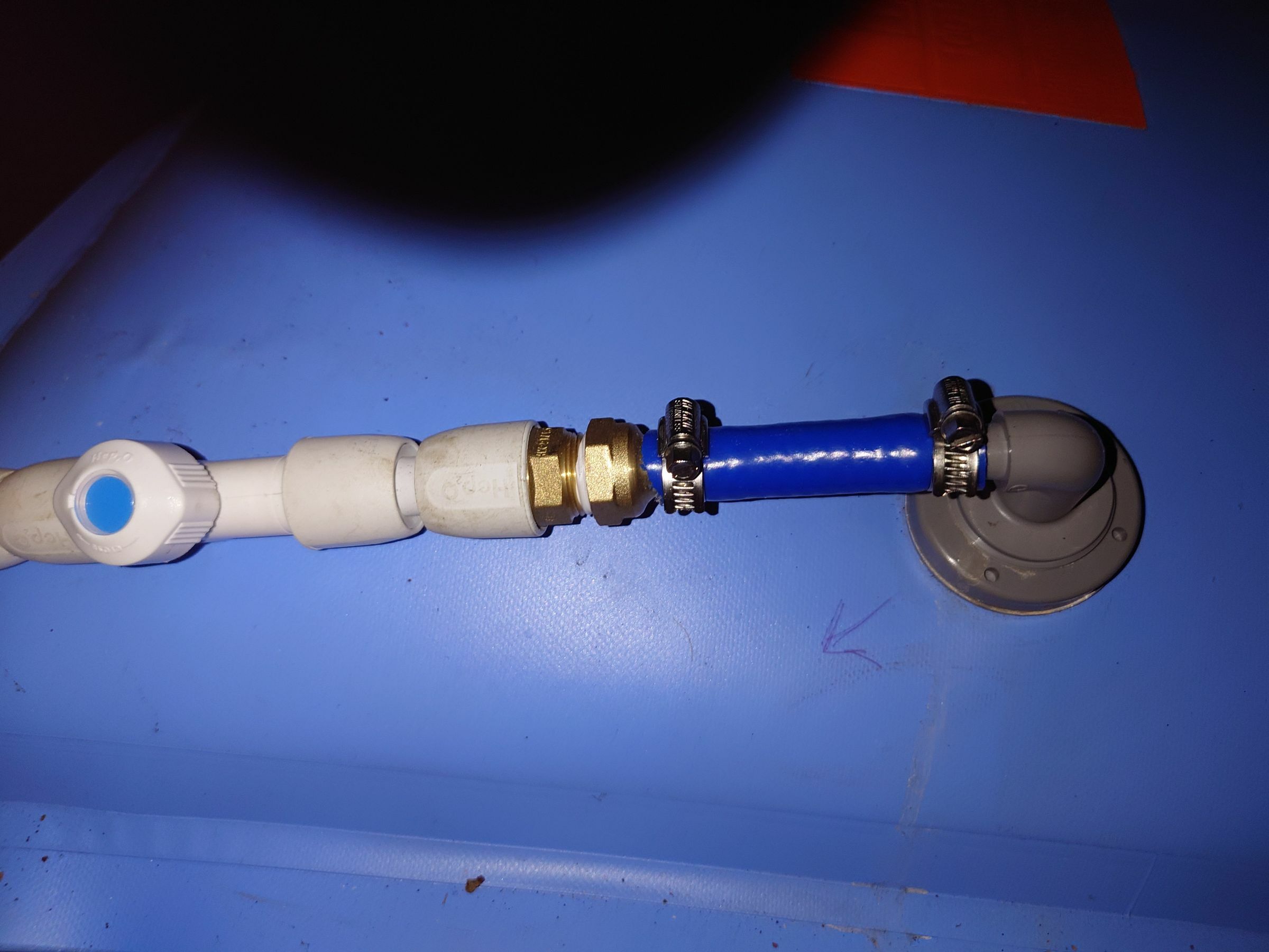

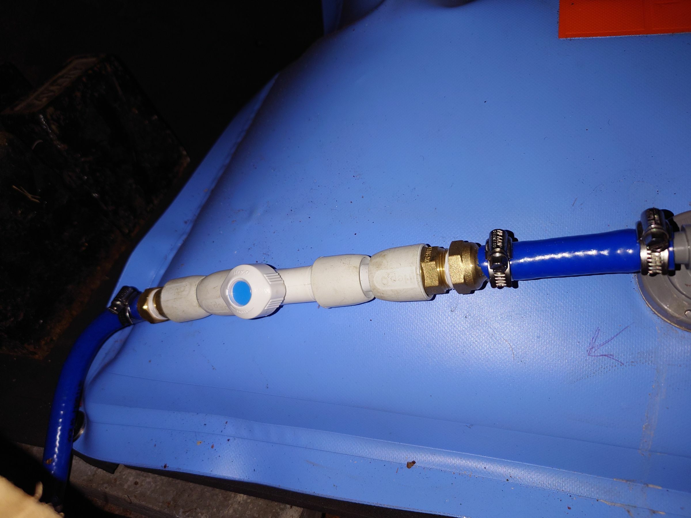

  17. Yes it's a Vetus tank! All solved - it was nothing more than a huge air bubble. Palm under mixer tap opened full, turned pump on, left palm there for about 20 seconds. Lots of spitting and spluttering and hey presto - water.
  18. Will it be ok running the pump with no water for 10 mins or so (hoping that it won't take that long). We were worried about damaging it so didn't leave it running longer than about 10-15 seconds
  19. Ah I remember . . So we had a different tap last time we had an air lock and I ran the hot water one (engine heats hot water), put my palm of hand against tap and turned the cold on slowly. I'll try that tomorrow before going down the route of taking things apart (although last time we didn't have a mixer tap)! Access is no issue but let me try the other option first!
  20. That might make sense. How to get rid of a big air bubble? I can recall we had an air bubble previously, though I can't remember how we got rid of it! Ah I remember . . So we had a different tap last time we had an air lock and I ran the hot water one (engine heats hot water), put my palm of hand against tap and turned the cold on slowly. I'll try that tomorrow before going down the route of taking things apart!
  21. That leads to the pump. No idea but it had a recently fitted new water bladder when we bought it and we had all the receipts from the marina. It's worked fine previously until today! https://www.kapwing.com/videos/646934ff8cc3d6001f0b4f37 This is the sound the pump makes (edit just realized no sound 😕 on video, I'll redo it tomorrow). No evidence of any leak that we can see. Pipes run under seats and are easy accessible as all our storage is under the seats (no fixed bed) and we have had them all up and can't see any water. Just been out with torches and looked and felt all round bladder and no water we can see.
  22. Pics attached. We are going to try and look into the issue tomorrow. The bladder is full.

  24. Nothing from shower or kitchen tap (that's the only two options). Could it be an air lock? Sorry idiot question but what's a breather?
