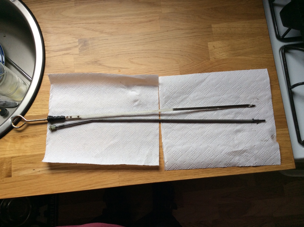

  11. Thanks - I'll give that a try - speedometer cable ... Always thought it looks familiar ...
  12. Here a photo which compares my dipstick with the missing parts on both ends and the one from the newer engine ...
  13. Thanks for the link - I already tried that one and it not flexible enough - the original one is more like a long flexible spring with two more solid parts on both ends (the ones missing on mine ;-) )
  14. Sounds like a brilliant idea - is there anyone around with a vetus or thornycroft engine with an extended dipstick who could measure the length of the flexible part and the diameter of the fitting in the tube? Many thanks, Martin
  15. No, the dipstick has been like this when I bought the boat and the former owner told me the bits were missing fo a long time ... But maybe it's still in there and only the filter holds it back from breaking the engine :-( - never thought of that ...
