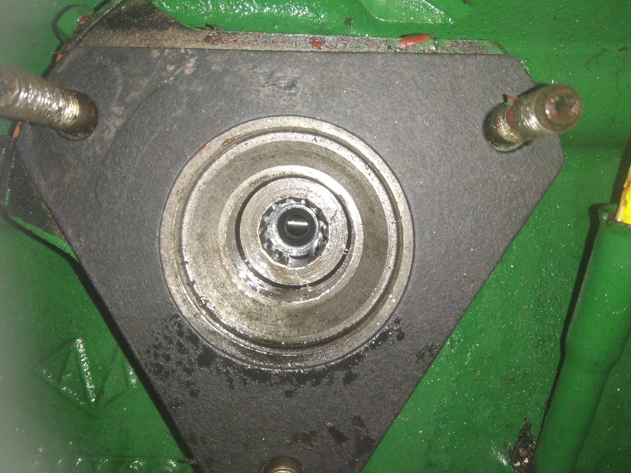

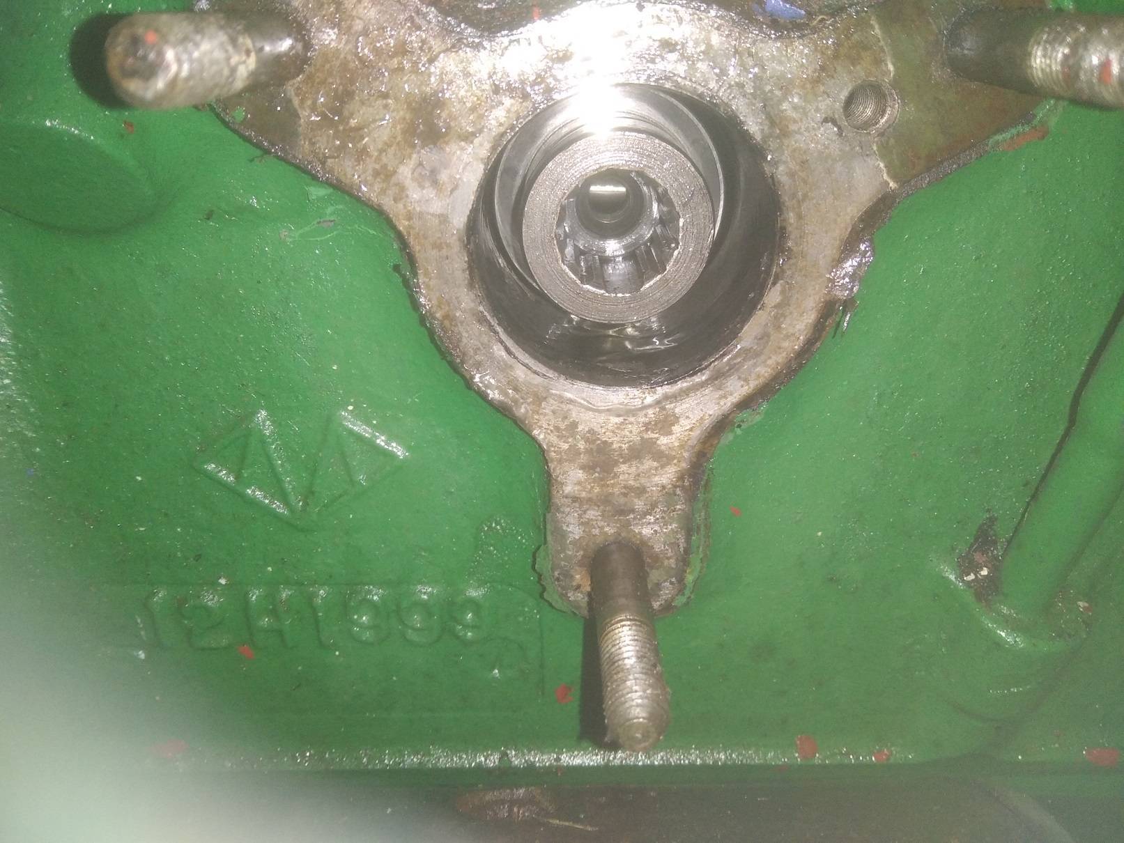

  2. This is a low priority task and conscious the time it has taken me so far. With the crank at a nominal 22 degrees before TDC I removed the injection pump mounting block and moved the skew gear round one notch. Before and after photos here. I feel it starts better, the issue is where it now starts and then dies, even with full throttle it dies with no smoke implying fuel starvation. After a few seconds it can then be restarted.
  3. The old injection pump didn't pump so used another pump. TBH it looked in poor condition where fuel was leaking from the throttle arm. The 'new' pump has been on a working engine. What do you mean by 'cam ring'? During the time the engine ran there wasn't any perceptible chain noise. But then I was more concerned over the black smoke filling the area I was working and there was no silencer. I think the splines/pump run in a an anticlockwise direction and the crank pulley was set close to 22 degrees. If at TDC the key would be closer to 5 o'clock. I have timed pumps by ear myself and one of the reasons why I replace the solid pipes with hoses, otherwise the 'side' cover gasket invariably leaks from crushing/manipulation of the cork gasket. The force to overcome the spring in the injector pipes is still significant! A good call about the oil jet and filter. Also an idea to remove the injector mount body and take a look at the pinion. I suppose I can gauge chain stretch from the level of backlash, but don't have any reference to compare that with. Hi Richard, many thanks for the offer. TBH I was more worried about the position of the skew gear shaft.
  4. This engine ran albeit not that well, and I don't want to run it for long without coolant. Given this was a 'training' engine before I purchased it all bets are off regards timing though I doubt the pump drive gear has been removed as it seems captive. I have timed the crank pulley to be what I believe is 22 degrees before TDC. No 4 valves are tight in this position and rocking around TDC. This is a photo of the splines with the pump removed. I don't have a pic or diagram of where the splines should be, the manuals I have at hand have only a reference to a timing tool. Can anyone indicate this is good for correct timing?

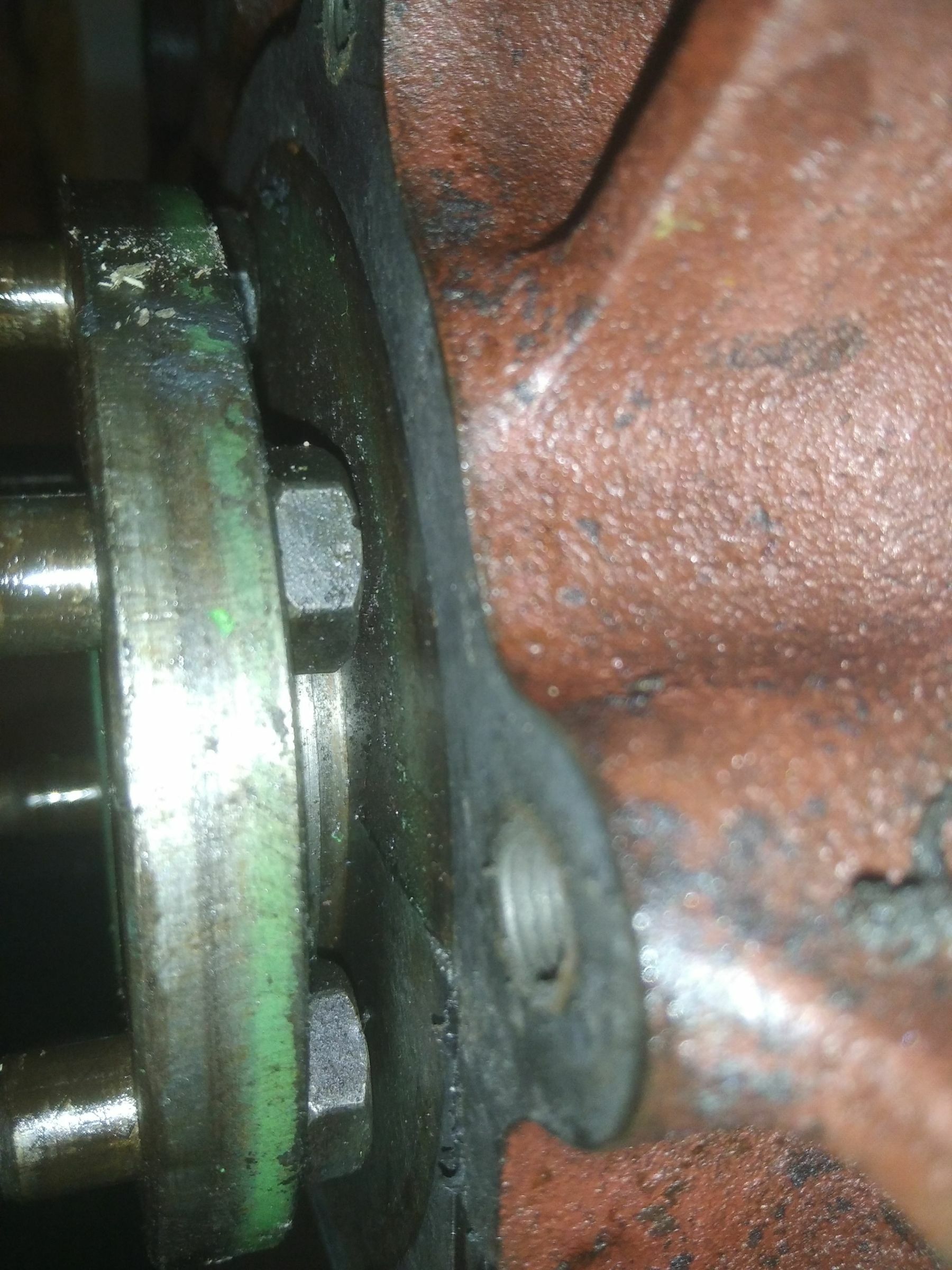

  9. I have lots of other things to do, hence the time taken to provide a photo. You can see the rear bearing cap join in the photo and I would say there is no room for a seal anyway. Any more detail would require the sump to be removed again as well as the bearing cap.

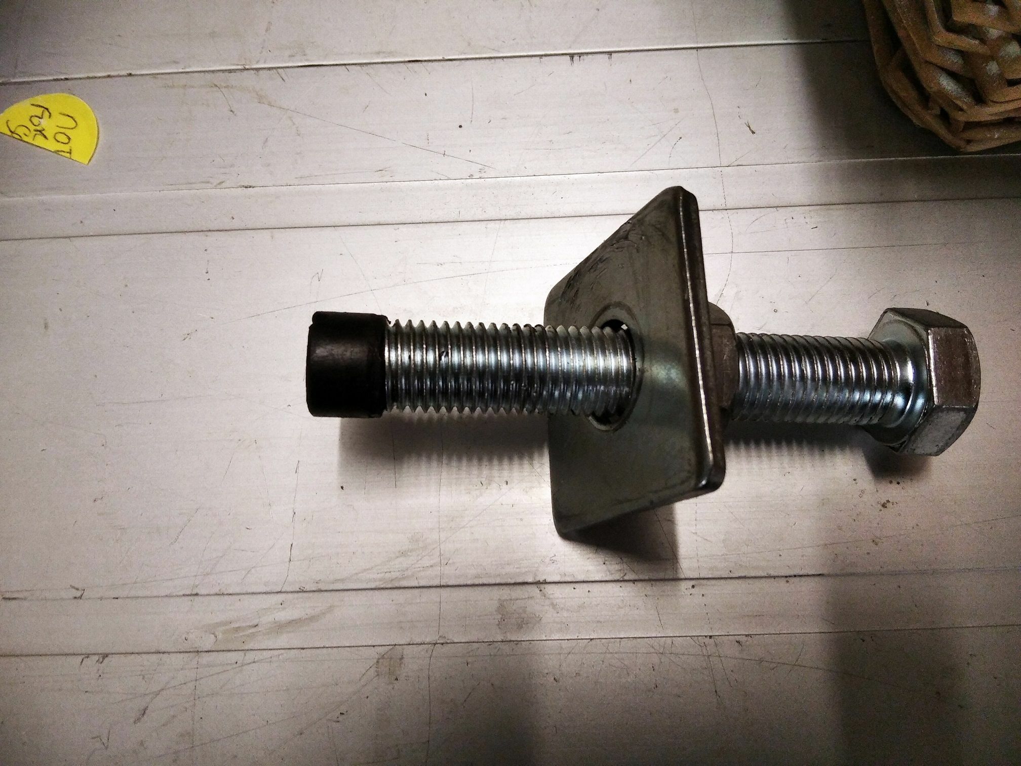

  16. I have good access to a milling machine and a number of cutters. I have some step blocks so with shims I should be able to get the injector hole pretty much vertical. I only need to cut down to the copper washer so minimal risk to the head. I f I use a smaller cutter I should be able to cut just a side of the brim that should help loosen it's grip on the injector bore. My main concern is how hard the material is. The fact I could easily tap a M16 hole suggests it should be ok. Yes, in hindsight that would have been an idea but TBH I was trying to avoid removing the head. The fact I left the brim behind with a straight pull makes me wonder if sharp taps from below with the swirl chamber removed would have ended up the same result? I have hit the top-hap from above with a metal screwdriver and I'm not convinced I'm doing very much. I'm also wary or hitting it any harder and breaking the head.
  17. Unfortunately I can't attack it from below. The central part has come through leaving a small annular rim that is inline with the head casting and leaving no ledge to knock it out with.
  18. I'm wondering if it's the original, so 35 years old. Thankfully I have a spare head that came from a seized engine. When I've got time I can use a miller to cut the the brim out of the head. I was initially feeling very pleased with myself as it seemed to come out smoothly! It was a good straight pull. I took the injector studs out and used a 5mm plate as per photo. It's funny how experiences can vary, but I've not heard of this happening to anyone.
  19. An existing top-hat had suffered corrosion and wouldn't seal with the correct copper washer. So I decided to replace it. The saga started in the thread, "Changing injectors on a 1500" I recall in this forum how easy they were to get out and how they might even come out with the injector. So, I got an M8 tap and screwed this into the top-hat and there was minimal purchase, I had an M9 tap which I screwed in but couldn't really give it a good pull. M9 bolts aren't very common. Next, an M10 tap, some studding and a nut and the thread pulled through the top-hat making a mess of the studding. Next, an M12 tap, some studding and a nut and the thread pulled through the top-hat also making a mess of the studding. Last ditch chance and no return using an M16 tap that in the top tat, where it made a thread from top to bottom inside the top-hat. Using a bolt and nut I wound the top-hat out. Sadly the brim was left behind. So it's head off and swap for another. I expected its removal would be so much simpler!
