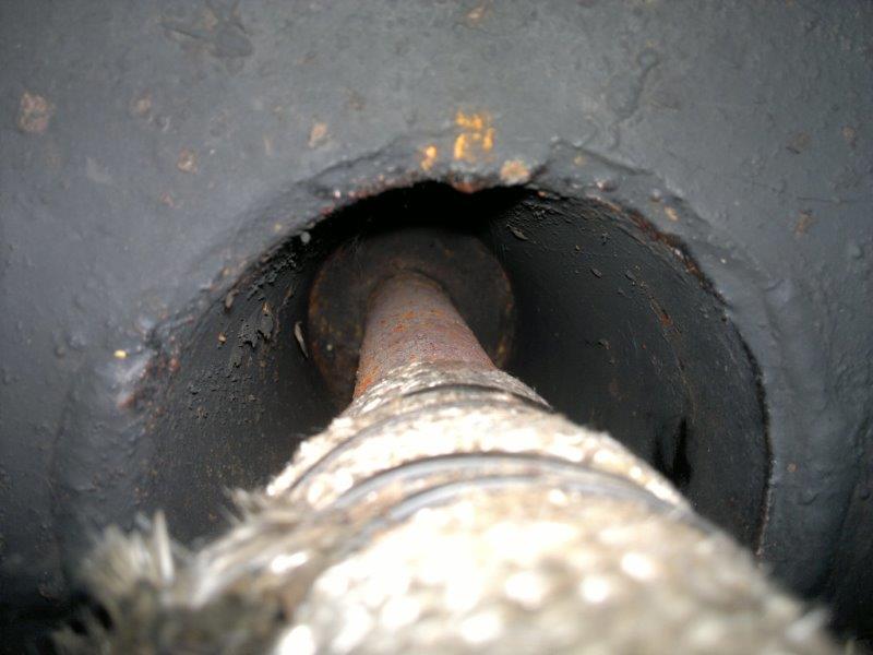

  1. I see the idea, I will think about this a bit more. I've no idea how long the stub is, but the idea of having a tube former the hole drill can sit over sounds a good idea of centring a hole-saw. I think some measuring if the actual pipe size is in order. I suspect it's either 1.25" or 1.5" BSP pipe.
  2. I was reticent of moving the exhaust exit, this argument has me convinced!

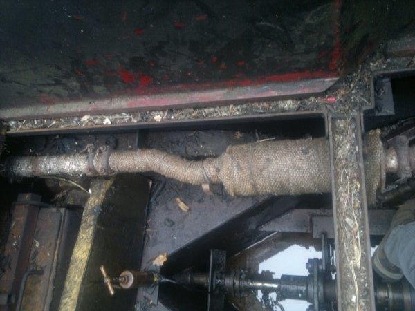

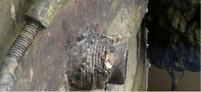

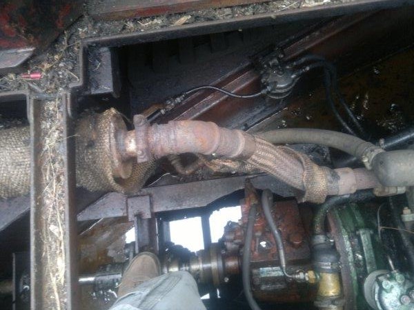

  3. I'll attack the hull around the exhaust pipe with an angle grinder at the weekend and report what I see. Access to the rear-most part, through the depth of the diesel tank, is very poor. I don't see any alternative to the downhill run. To be honest the exhaust is quite high up on the hull, and only just below the rear deck floor level, so the risk of water ingress is quite low.. That is a plan. However if threads need cleaning up or remaking in situ there isn't going to be enough room. I've never been successful with heat with iron on iron. I'm not sure how I can successfully use a hole saw on a pipe. It has got me thinking but I am wondering if a jig-saw or other reciprocating saw might be a way forward. Thanks for all the ideas.

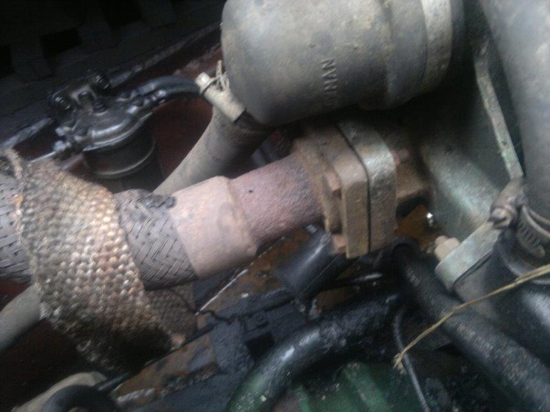

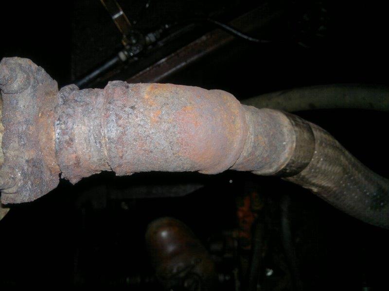

  4. The short pipe between the flange on the Bowman and flexible is seriously holed. The whole of the exhaust is currently suspended from the rear. Although there are a couple of brackets connected to the Swim, they aren't actually used. I would like to undo the exhaust, though it is of sufficient age that I am happy to remove and replace the lot. I do have access to pipe threading vice and dies so tailoring to fit shouldn't be a big issue. I have been able to make one thing move using Stilsons, the 45 angle fitting (in the last photo). However I suspect if I apply any further force it will fall apart. Photo 4 is perhaps the most telling, it is where it passes through/past the fuel tank. Photo 5 is where the pipe emerges. The gunk appears to be mastic, but I can't see any fitting I can remove. Is this setup standard? Any ideas on how to proceed to remove the exhaust attached around the fuel tank?
