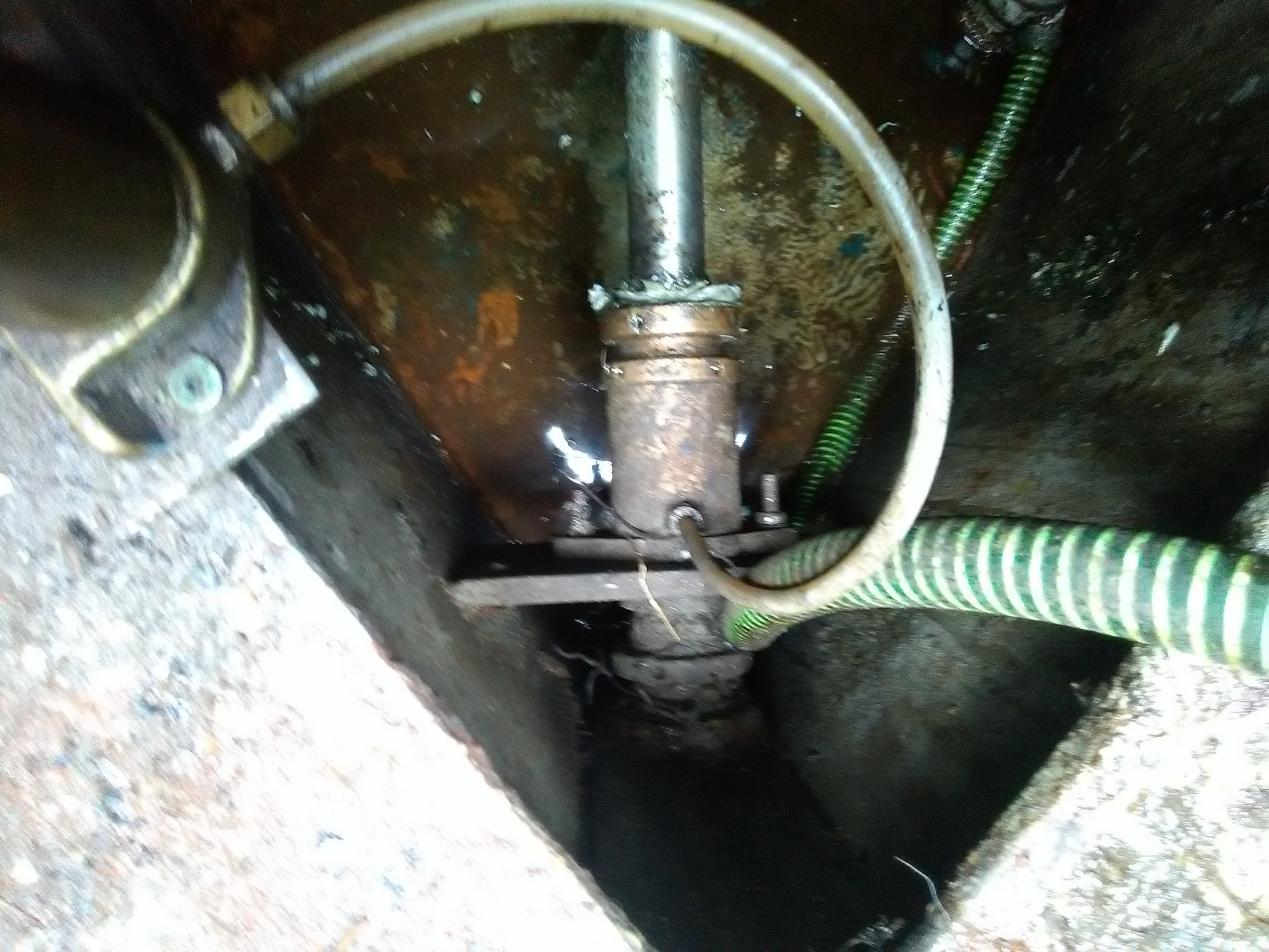

  1. Trying to establish what size packing to get , thanks in advance, Steve . Nb crafty
