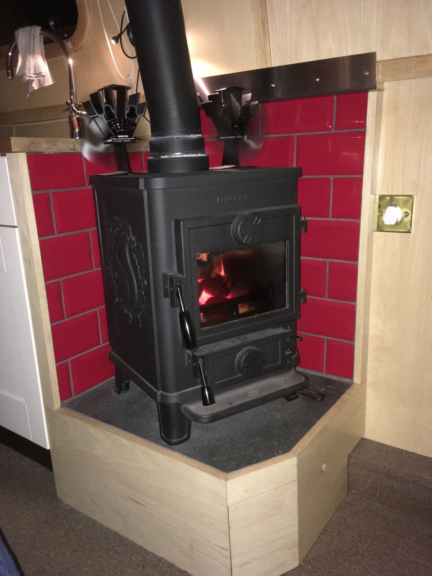

Hello, I am in the process of selling my much-loved 50’ narrowboat and buying a 31’ Sea Otter (limited mooring length at my new destination). One of the things (that I added) that I love most about my current boat is my Morso Squirrel stove, and the Sea Otter does not have a stove. I am pretty sure I want to get one fitted pretty soon, but I can’t decide whether to go with solid fuel again (it’s very lovely and cosy, and I like the fact it’s something to do when sheltering from the miserable weather outside), or whether to go for a diesel stove (more controllable and no need to source fuel). The main thing that puts me off the idea of a diesel stove is the fact that I like to keep my diesel tank full over winter, the Sea Otter doesn’t have a massive fuel tank, and I’m told these diesel stoves can burn through as much as 1 litre per hour, which could mean I might get through 100 litres of diesel in a month during winter, even if I only stayed onboard for a couple of nights a week. Should I just stick with solid fuel, as it is easy to source, perhaps more cosy, and won’t leave me searching for diesel in the depths of winter? Thankyou. Andrew.
