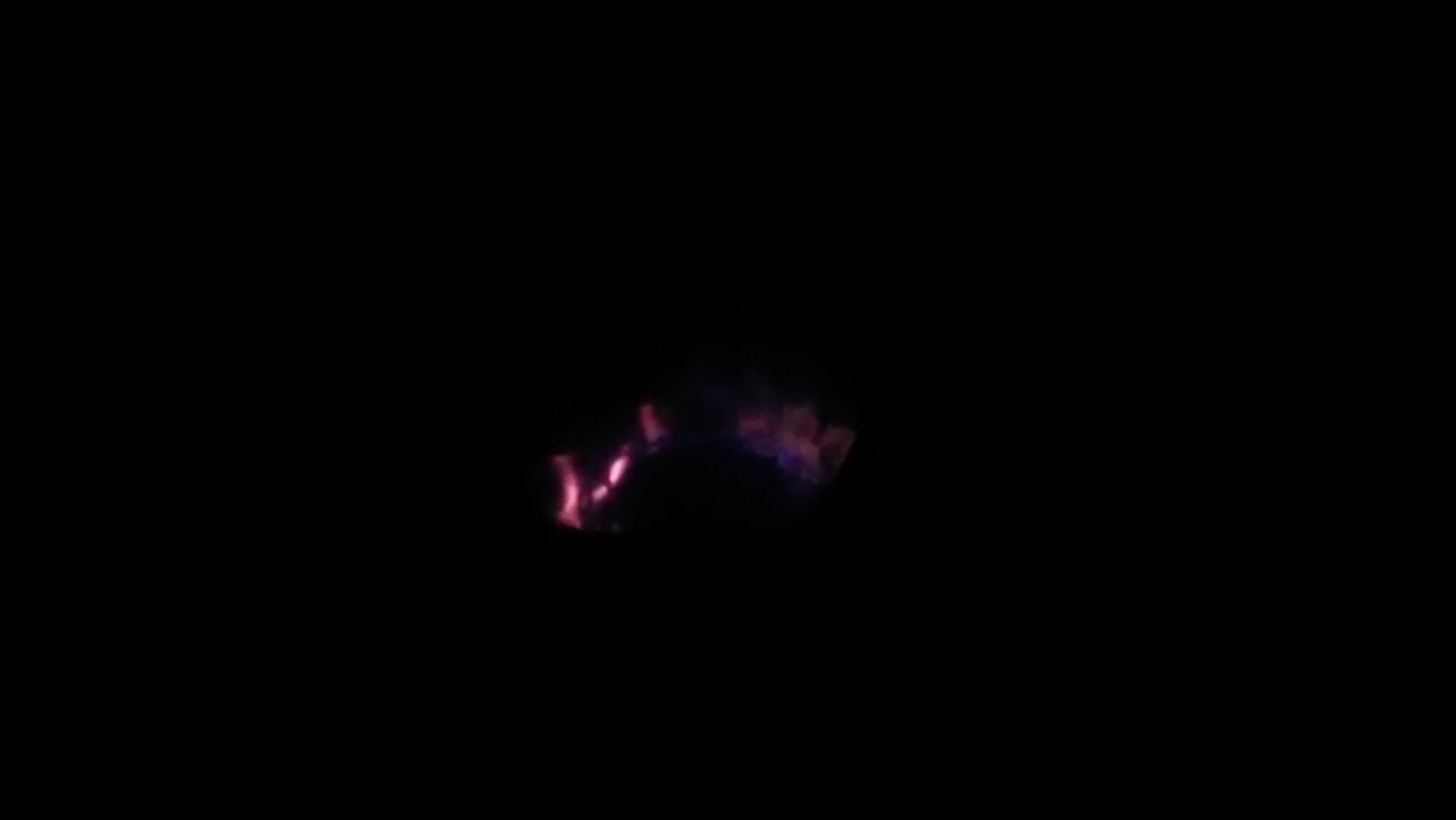

UPDATE Firstly thanks to all for your inputs For any future people needing help here are my findings. MY ISSUES How do I light Why is flame yellow My findings via this thread CLEANING Clean and decoke every thing paying special attention to burner holes LIGHTING Set regulator to number two Bleed a small amount of fuel through add either a capful of meths or a small cube of fire lighter and ignite. Hold in plunger for a further minute I found that the higher you have it set the more yellow the flame and when adjusting don't got too far at once maybe just 1\4 stops and wait 15 mins for effect .(patience) Mine runs best on 1 1\4 Also worth noting I was bench testing mine outside in sunlight ( maybe having more draft caused a few issues) I think it would draw different inside the boat when fitted ? Certainly the bright light made the flames appear yellower Anyway I now have a lovely blue flame and what a cracking little stove the old Dutch is Thanks again all- 13 replies

Hi all anyone advise on not having a yellow flame on my old dutch stove please
