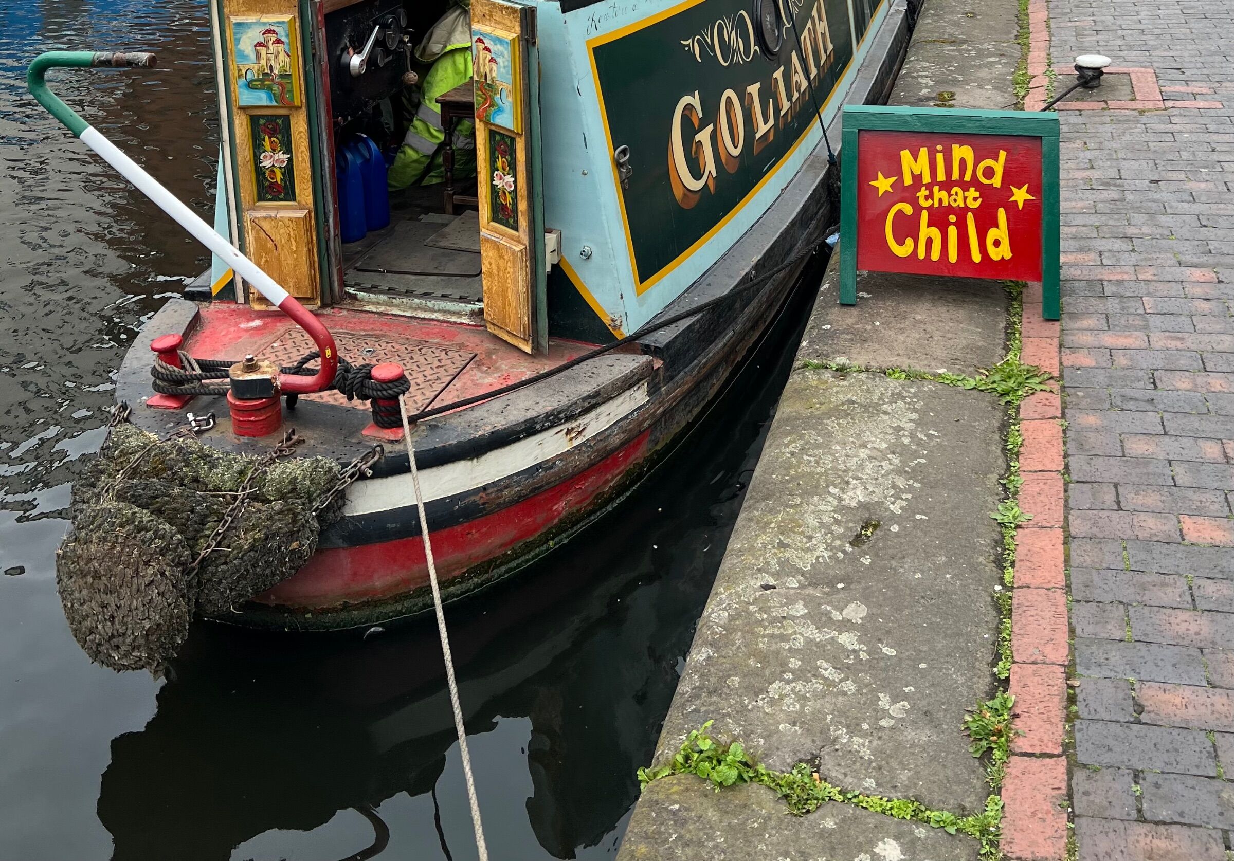

  7. 19 hours ago, 5239 said:
    here’s a spring line,
    the boat don’t match the mooring bollards as I’d like and I don’t want to create a trip hazard at front
    simply the black rope is the springer. (And a trip hazard in my case 😃)
    normally as you know you tie with a rope going out from the front and back.
    but in this case the back rope is longer than I’d like so the springer helps keep the back in as the trip boats pass.
    I was just wondering which forum member(s) your sign was referring too? :)

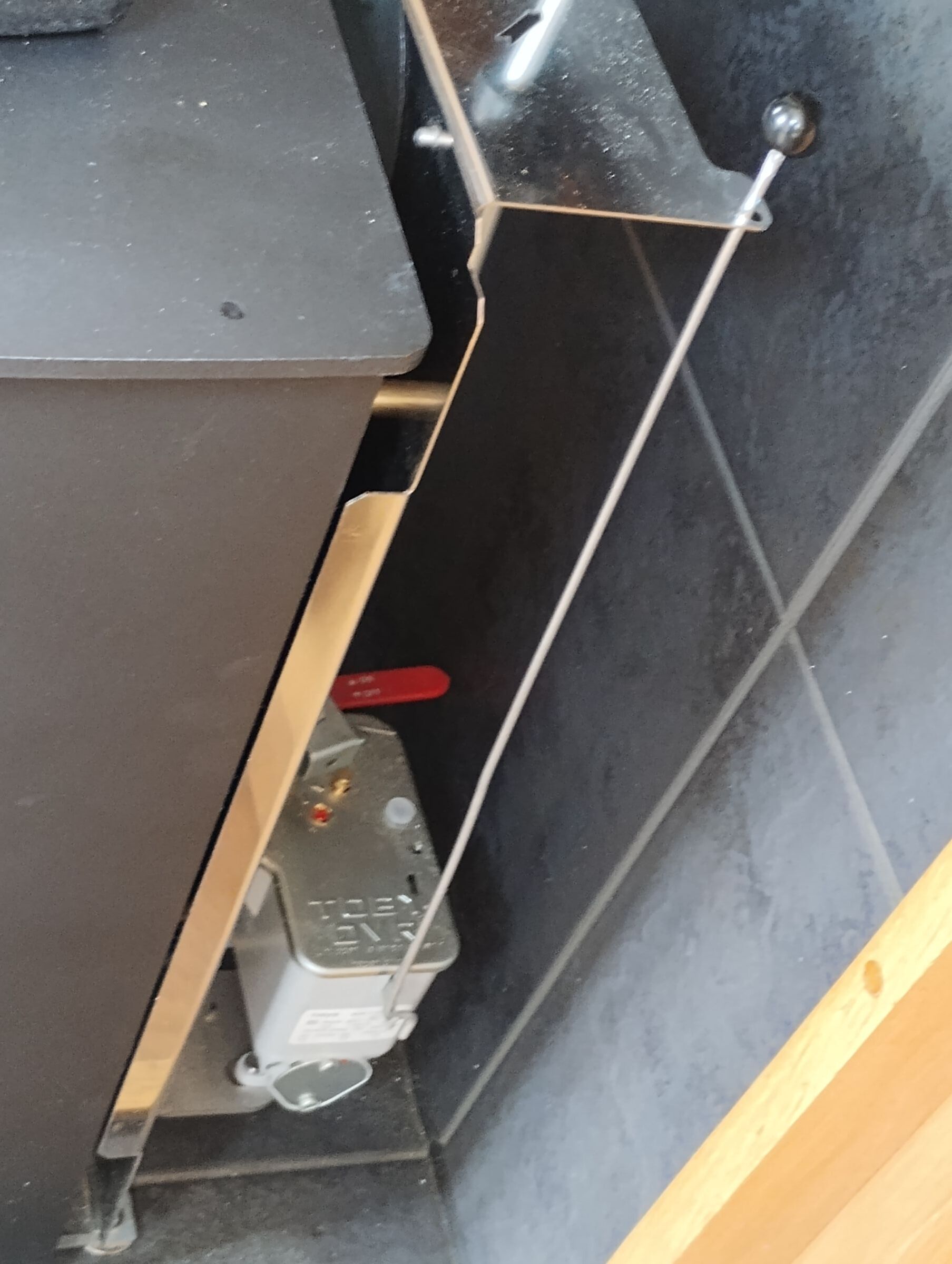

  9. 4 hours ago, pearley said:
    Just fitted but before attempting to light what is this rod for? Pulling or pushing it doesn't seem to make the lever move. Instructions imply I should hear a click.
    My Kabola Old Dutch has a rod like that to turn the oil control valve on the Toby regulator, so it turns the stove on and off as well as turning the fuel flow up and down.
    However yours is a later Toby valve and the rod doesn't seem to have the oil control valve on the top.
    Other than on and off, any changes take a few minutes to show up as the flames take time to respond to the changed fuel flow.
