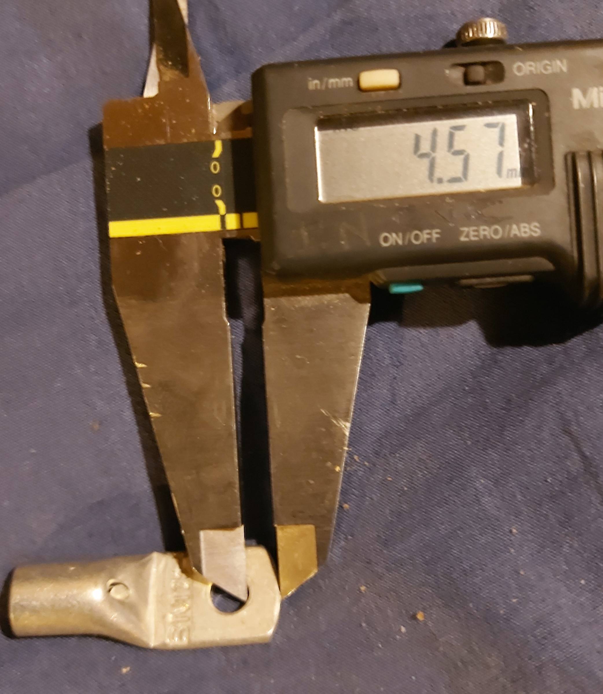

  5. It sounds to me you are saying the measurement in the pic above is the problem . Is that the case ? If so I would just file it down until it fits.

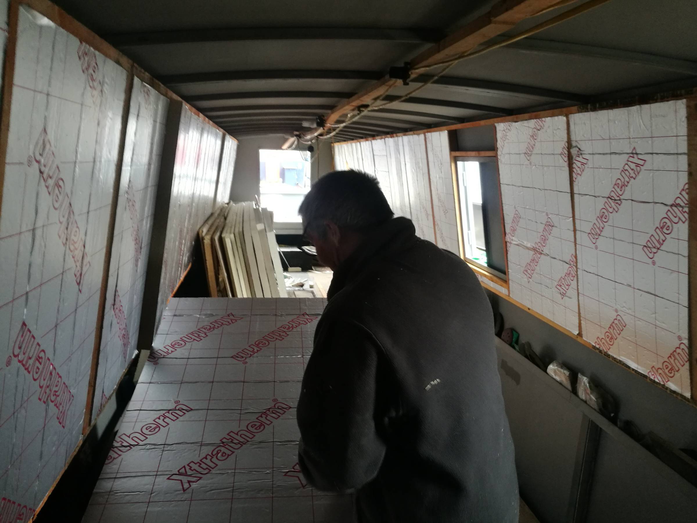

  11. On the boat pictured above the the box section was 2.5mm wall. After drilling a 4.2mm hole and using an M5 tap I hung my 80 odd KG weight off it and felt comfortable I could not make it fail no mater how hard I tried. If it was a single point I needed I would perhaps go up to an M6 just to be sure. If you find a small diameter drill bit and put a mark or tape at 40mm from the tip you will soon know if you are hitting one of the supports or not without causing too much mess.

  13. It is fairly likely you will have 25mm x 25mm steel box section roof supports mounted at 600mm centres down the length of the boat. If you can locate one of these it will be fairly easy to drill and tap a thread.
