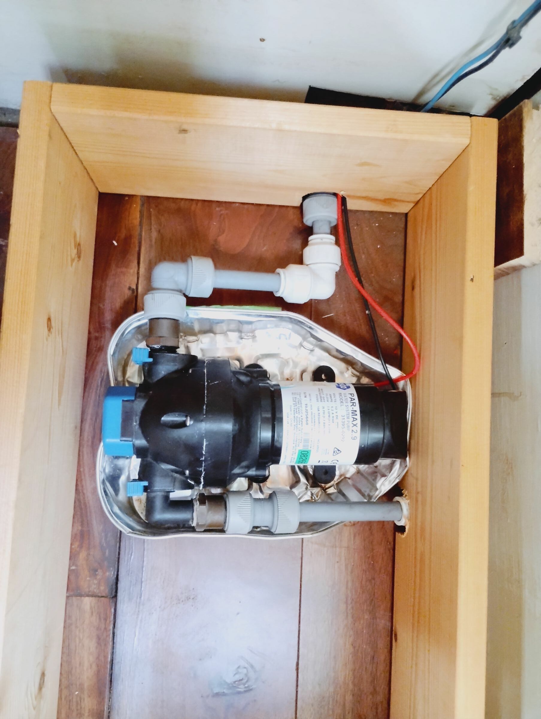

20 hours ago, Higgs said:
You really need to split the casing and clean the mating faces and apply sealant to one of the faces. If it's silicon, I think I let it cure before compression.
That's what I did, missed your reply while I was working on the pump so I reassembled while the sealant was wet. Seems to be working...so far!
Fit the lower-delivery pump, then strip and clean the old one and apply Loctite SI 5926.It's a silicon based sealant, so flexible. Did the trick for mine. The old pump is back on, and the new one sits in its box, waiting for the next time. Two years on and counting.
Got some CT1, will give it a go with that, cheers. Shot to nothing, I guess. Have confirmed sighting of weeping so will apply a thin bead all around.
I wonder why the pump design doesn't use a replaceable gasket?
41 minutes ago, blackrose said:
Just give it a try and see what happens. You might need to adjust the accumulator pressure if the cut in pressure of the new pump is different.
The benefit of jabsco (Parmax) pumps is that the pipe fittings push in and a slide on the pump locks them in position so it literally takes 2 mins to change a pump over.
As I've just found; what an excellent design.

Hi,
My water pump needs replacing (started leaking), and it just so happens that I have a replacement to hand (gifted, as new).
Unfortunately, I notice that it's a model with a much lower flow rate. Jabsco PAR-MAX 1.9, whereas the old one was a 2.9, so replacing one capable of pumping 2.9 gallons/minute with a new one doing 1.9 gallons/minute.
Everything else appears to be the same (electrically), so am I just looking at the pump running for longer to repressurise?
Cheers!

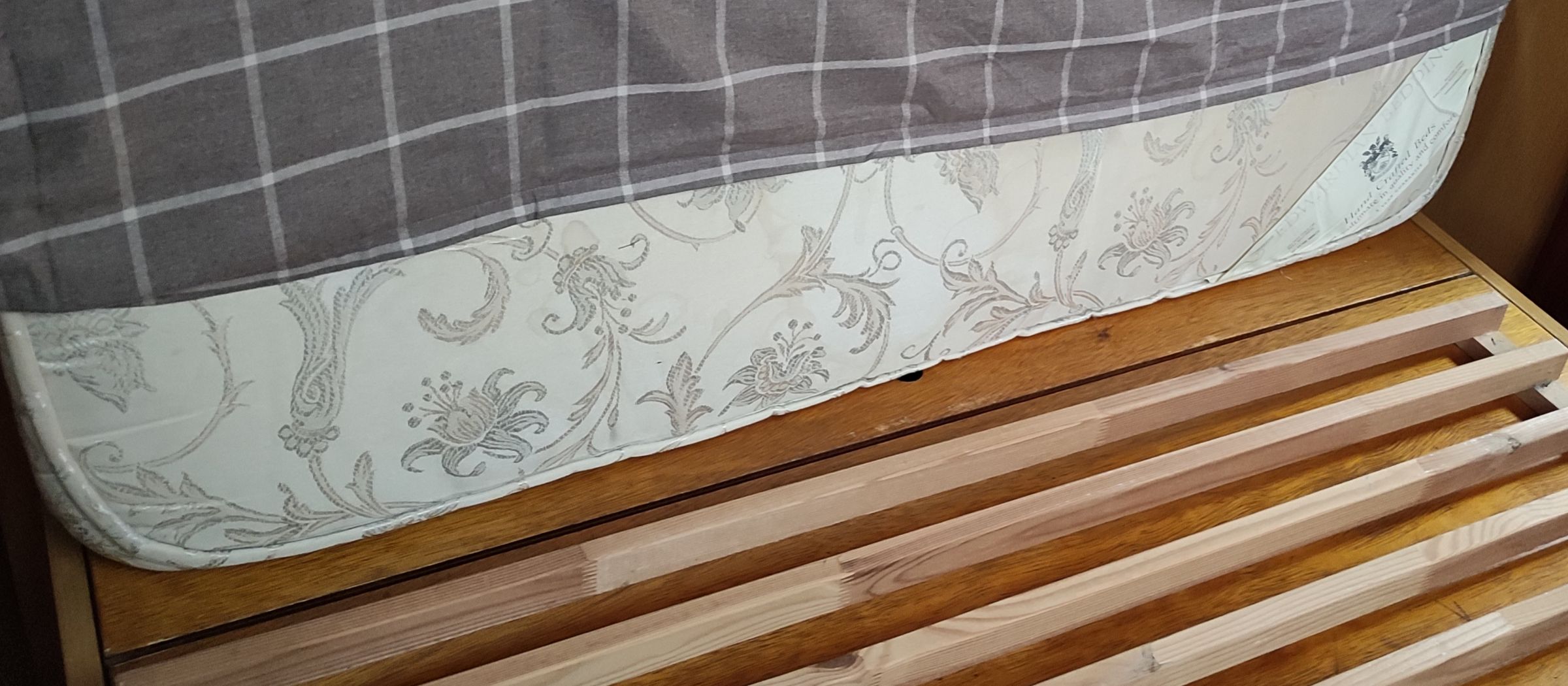

The other thing I was going to mention: that set of slats - scavenged from an IKEA Bodo, just the right width.
If you have a mattress 120cm wide, I found that a cover for duvets 140-150cm will fit right over the mattress provided the opening is full or near full width.
Much easier than tucking in a flat sheet, especially if the bed base is built-in with furniture to the sides, and turning the mattress over is a doddle.

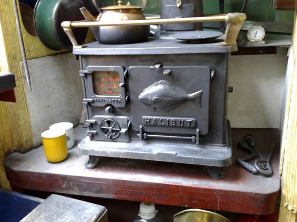

11 hours ago, David Mack said:
If you think that's horribly expensive, then you shouldn't look at the Halibut.
And that would before you factor in currency exchange charges and import duty from the US
On second thoughts having checked out the link to the 'Bubble 1 Pie Pod' (you what?), perhaps the Salamander isn't *that* bad.
Salamander Stoves do a range which seems to tick all your boxes - unless one of those boxes is not being horribly expensive.
