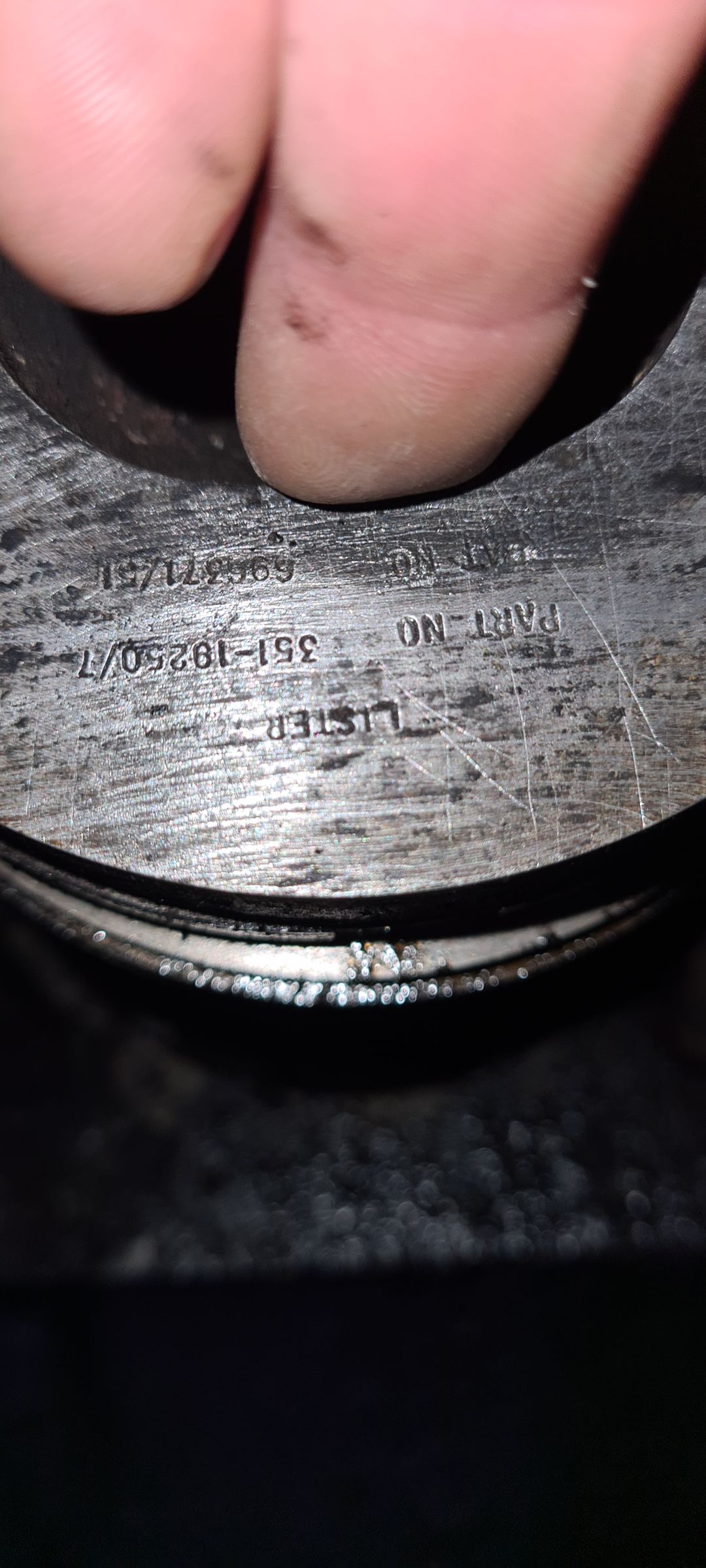

  3. I've started to strip and clean the ha2 now I know it ran so I can clean it up and then once national is fully running will rebuild it. I've removed and cleaned all the top end im in the middle of cleaning piston, I do have a set of rings about (no idea why) but the number on the pistons don't match to anything. There genuine lister pistons and liners and are in very good condition so will prob hone and reuse, The numbers off the piston are part number 531-18250/7 (the 8 could be a 9 as has a bit of dirt on it but it looks like an 8 when I look at the patern number has a 9 in) Any idea what this relates to e.g. stock or over sized?
