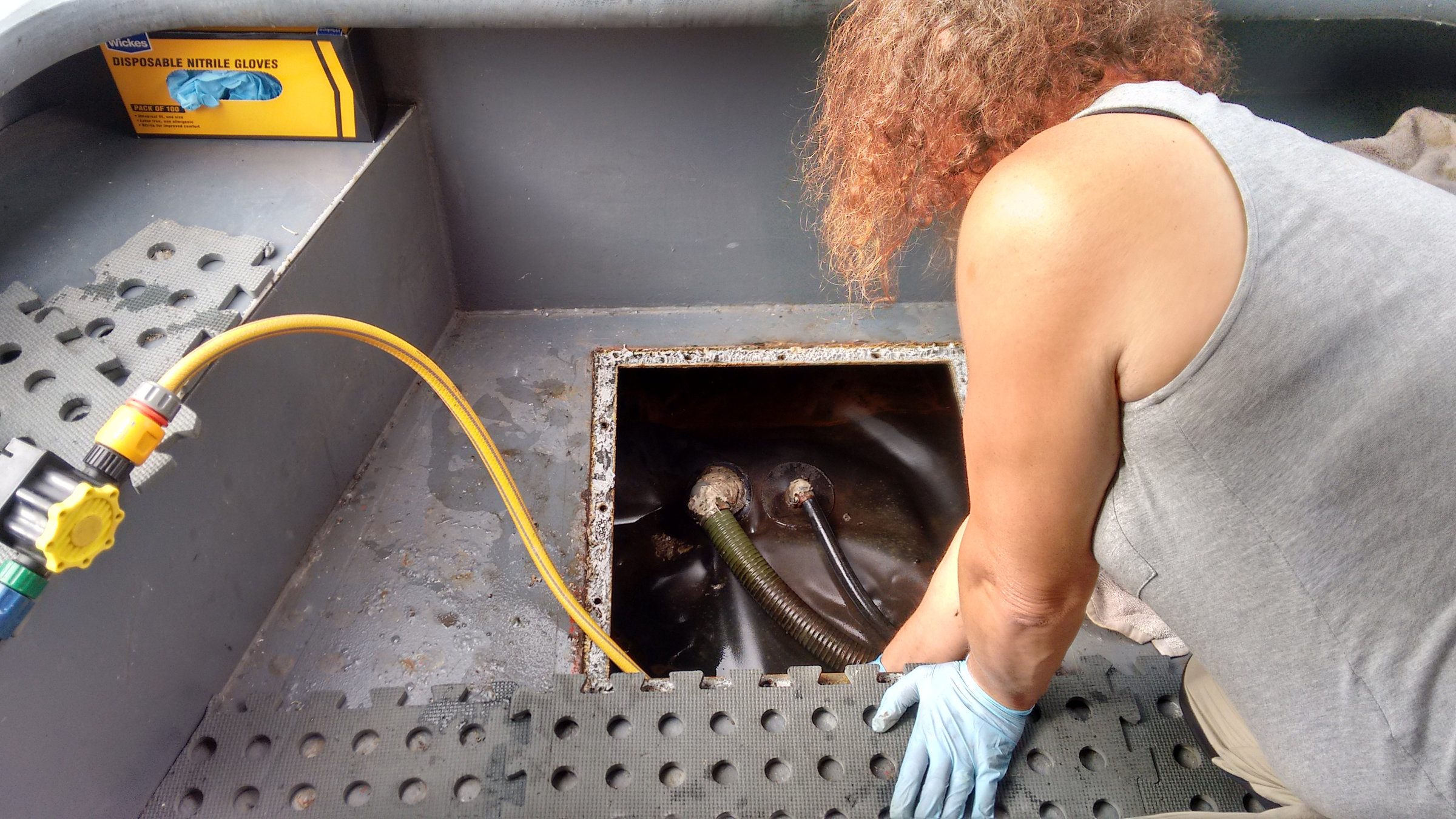

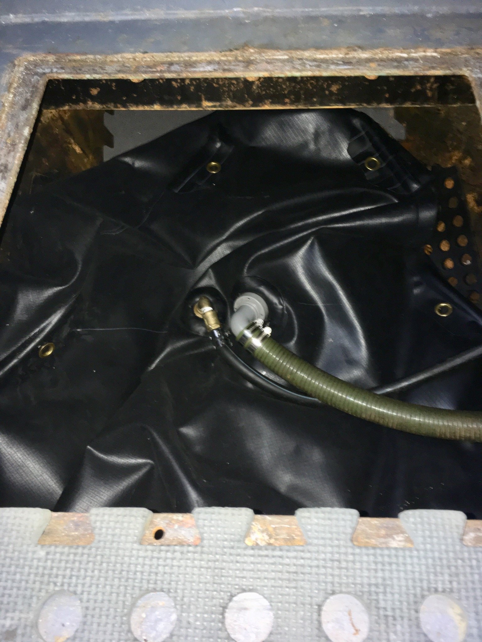

After a false start when I inadvertently twisted the liner when tightening the outlet nozzle against the bulkhead, the water bladder is now correctly located and connected. Here it is filling up. Meanwhile the pleasure of running water is restored to nb Flag Iris after three months of living out of bottled water. You don’t know what you’ve got till it’s gone! -

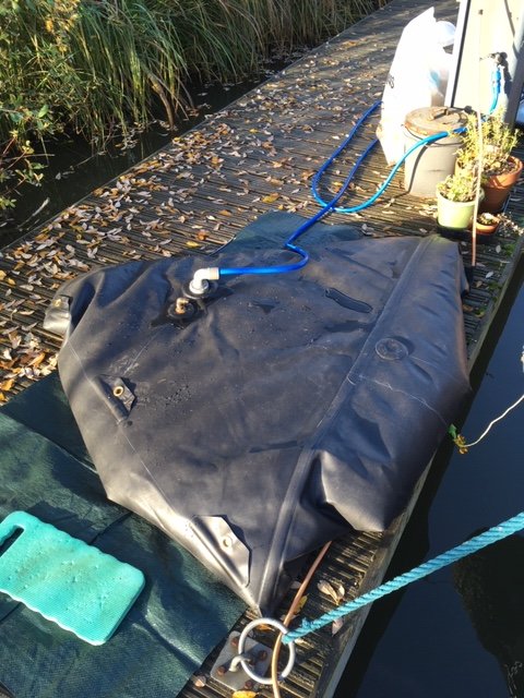

My new water tank bladder took about 4 weeks to manufacture. They used the fittings salvaged off the old liner so that re-fitting to tails will be straightforward. On a fine morning, we decided to fill the liner outboard and make sure it's watertight. So far, so good. -
