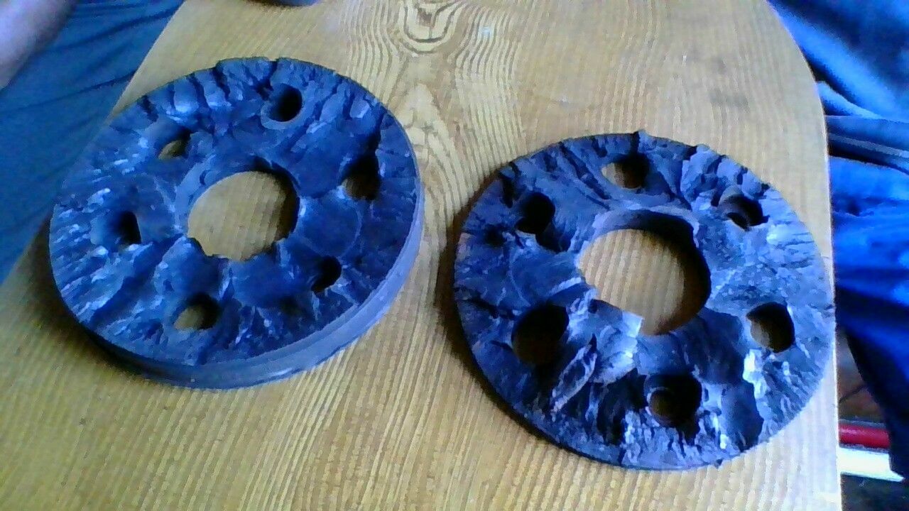

  9. Mine is basically the same as this, only smaller at 6.25 " diameter (approx). Brinklow Boat Sevices have some 'used' 7.5" Metalastik couplers from old working boats. Here is my sheared 6.25" Metalastik coupler - part number 21/642/2 :
  10. Nick at Brinklow Boat Services had a steel replacement coupling machined, and I fitted this steel coupling yesterday. Drive now working fine without the Metalastic coupling, as expected. Very nice to be back on a boat that can move again. Good test trying to cope with the excessive blanket weed on the Middle Levels. Nick also confirmed that the Blackstone 2:1 reduction box has a thrust bearing on the output shaft as standard, so is not really suited to having a prop-shaft with a plummer block 'that does not take thrust' (to use Tony's words from above). How can you tell whether your plummer block can take thrust ? Ralph
  11. Thanks for your comments. I would agree for a coupling costing hundreds of pounds. However, if you can get a good quality (i.e. German) auto rubber coupling replacement for (say) thirty pounds then I'll probably fit one before I reverse any distance on the BCN 😉 Syrinx's previous Metalastik coupling lasted without any problem (apart from becoming obsolete) for over 40 years, before it failed. Syrinx is a Malcolm Braine boat, and I presume that Malcolm was involved in the engineering of the drive etc. My brother has a late 1990s Tooleys-yard build boat (sorry I've forgotten the builder's name). My brother's boat has a very similar drive arrangement to Syrinx - but his boat has a steel adapter plate where Syrinx has/d the Metalastik coupling. Horses for courses I guess...
  12. Nick at Brinklow Boat Services has 'machined/engineered' a solid steel coupling to replace the failed Metalastik coupling. I am going over to collect the steel coupling tomorrow, and I'll be installing the steel coupling during the next couple of days. Hopefully, I'll then be able to escape from Ramsey and get off the Middle levels and back onto the GU via the Nene. I'll also discuss the thrust bearing situation with Nick. My engine is a JP3(M) and it is bolted very firmly using very thick engine support beams and fixed to the hull.
  13. I went over to the boat last night to try the QL9000 for size. Unfortunately it does not fit into the existing mounting holes of the failed Metalastik 21/642/2 drive coupling - it is several millimetres too small 😞 So the QL9000 part is not suitable as a replacement for a Metalastik 21/642/2 drive coupling. However, there are loads of other similar 6-hole rubber drive couplings available for various vehicles, with a good range of bolt hole circle diameters. The QL9000 (old Mk1/2 Ford Granada) coupling probably fits the Lister LH150 gearbox set-up OK, which the R+D flexible shaft couplings brochure (910-052) show as being 98.5mm 'bolt hole circle'. I think that the QL9000 coupling is equivalent to the Metalastik Rotoflex (i.e. car) drive coupling 21/1004/1 which has a 'bolt hole circle' of 100mm (and also large fixing holes - to provide some useful flexibility).
