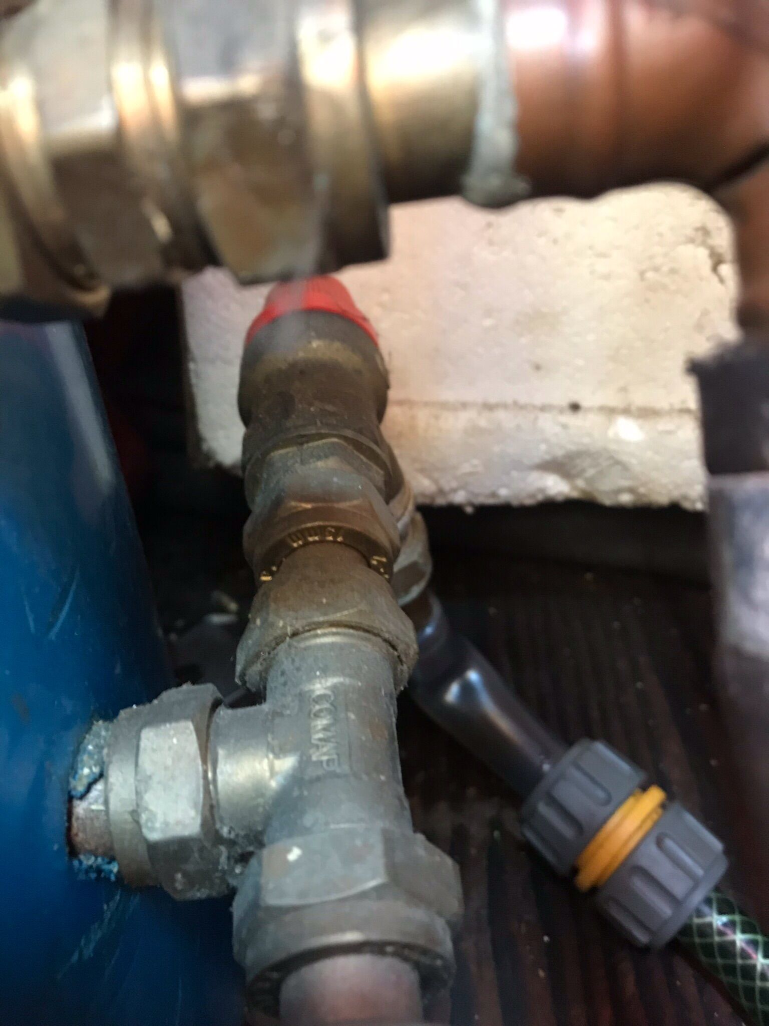

My engine seems to be a lot happier now thanks to your sound advice. I have added the extra wire too to the oil gauge and all seems to be reading as you correctly predicted. i have cleaned out the bilge and now I have final question - when the engine is running I have noticed a very small trickle of clear water coming out off a drain pipe that is connected to the bottom of the calorifier (red cap) - is this just normal as the calorifier is pressured? I have never dared touch the red cap but it does turn and add ‘water’ I guess to get the right pressure? No gauge for my to worry about tho?

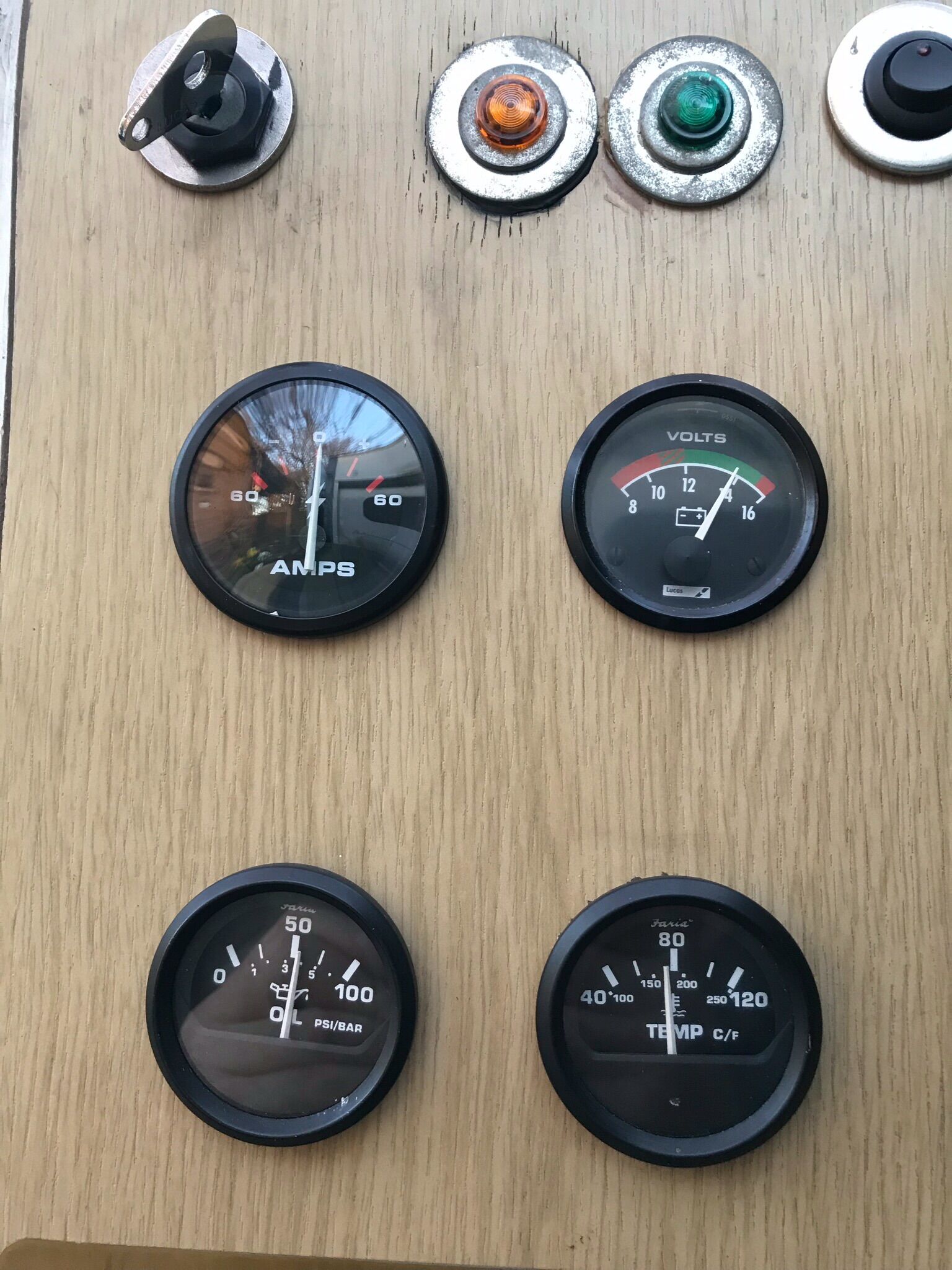

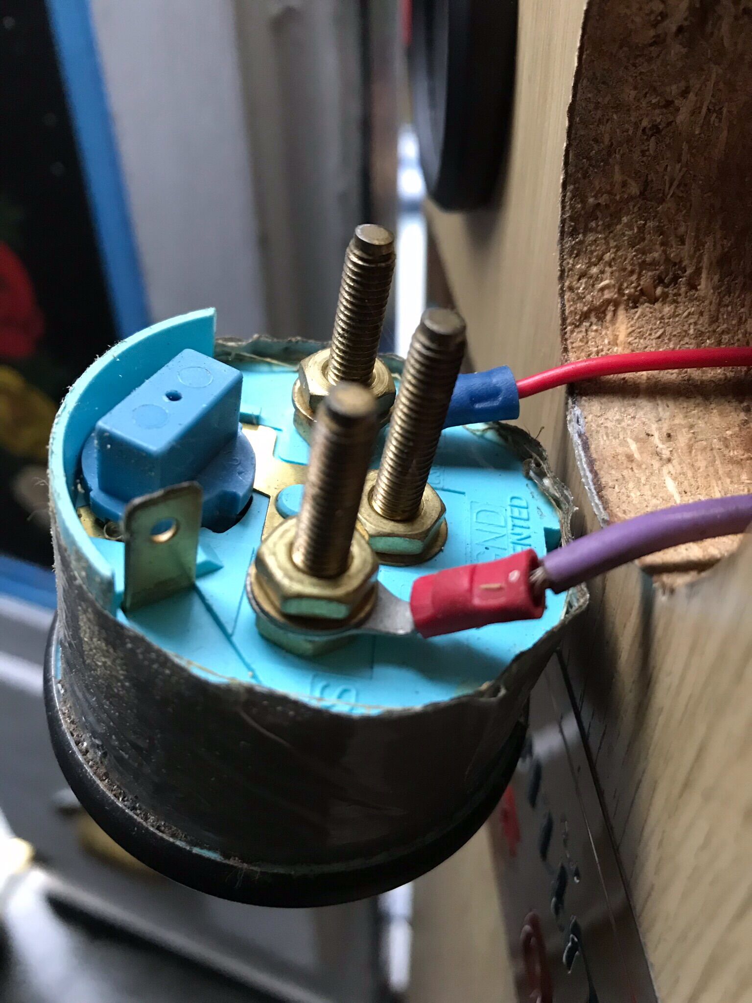

Here is an update by way of a thank you too. Added the additional wire as instructed and had a test sail today following my CH renovation. It went well and the temperature was accurate and stayed mid way around 80c which I think is about normal so it looks like I have no air in the system either. My only query now is following up from what Tony wrote that maybe I need to address the oil pressure gauge - do I need to put a wire to that too from the negative buzz bar? To be honest, Iv never paid much attention to this gauge...probably wrongly but what should it read as it usually goes up to about 100psi? Thanks all for your time and content.

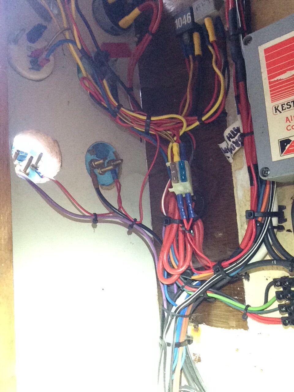

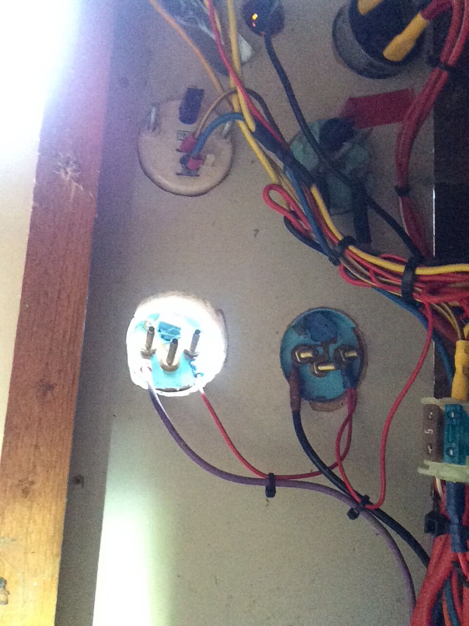

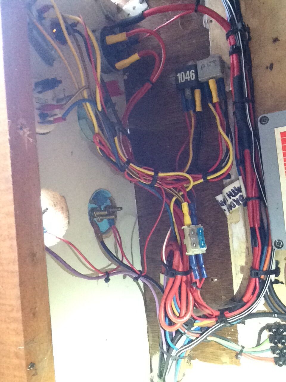

Ok, so I have had a good look behind the panel as recommended and taken a few photos to help. Definitely only 2 wires to the gauge with none apparently ‘lost or missing’. purple wire goes to ‘s’ and red to ‘i’ with the middle nut screwed down tight marked ‘GND’ which I presume is the ‘ground’ that Tony spoke about. next to it is the oil pressure gauge. one brown wire from the sender.
I have taken off the panel but there does not seem to be any ‘spare’ loose wires that would have gone to the back of this gauge. I will have a closer look in the daylight tomorrow. I appreciate the information so far although even though you say there may be a wire missing on back of the gauge it was working perfectly well before the CH was taken off which mystifies me? I also spoke to the engineer who has now told me that he did not replace the sender so both the sender and the gauge remain the same that previously worked.

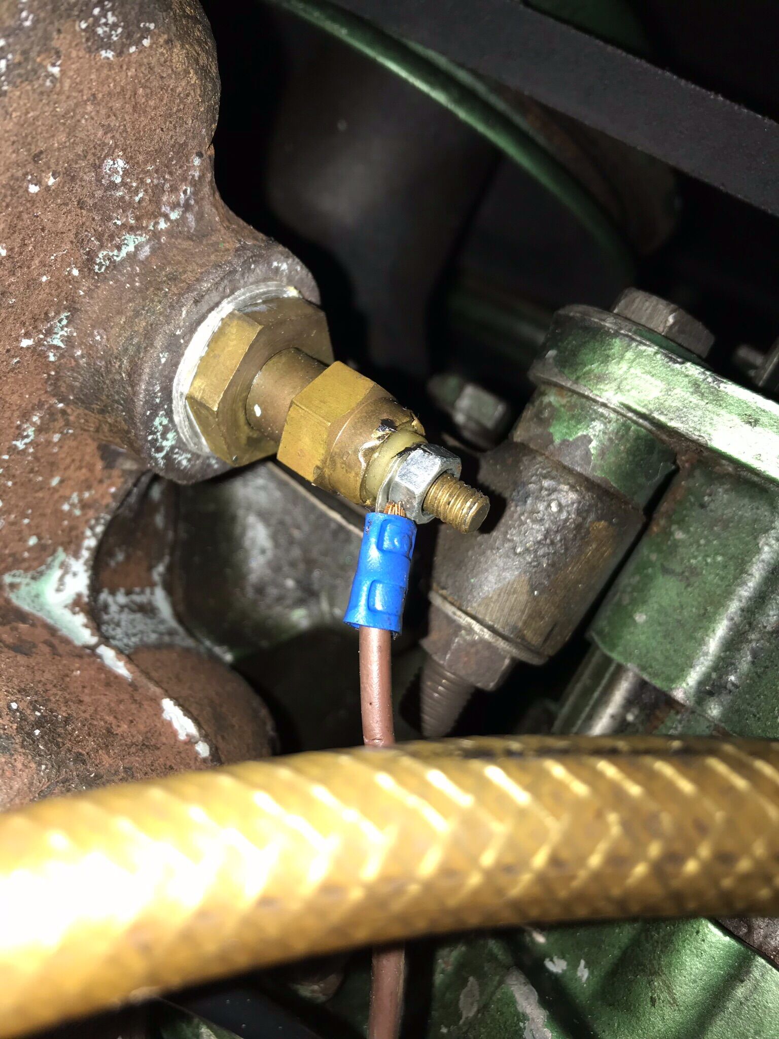

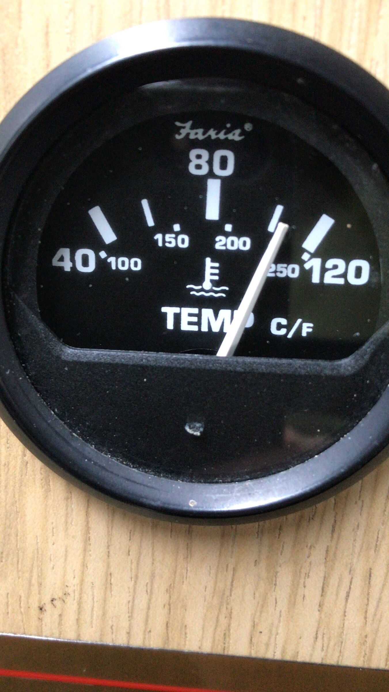

This is good news indeed so thank you both! i had my CH refurbished and I think a new sender was added so it probably doesn’t match the gauge then now according to what u say as its worryingly showing to be 120 degrees after only ten minutes on tick over. However, I can feel the top of the heat exchanger is no where near that temperature!
