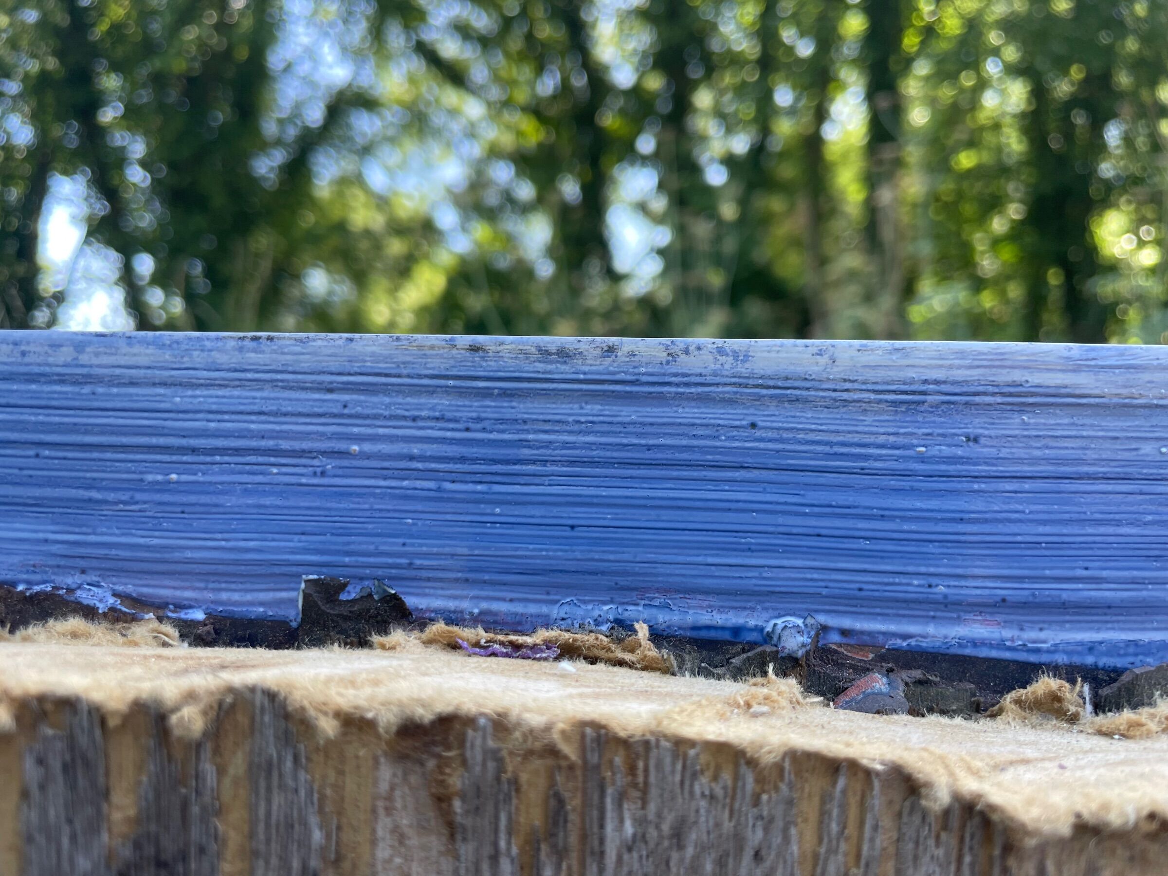

The metal was at 20° when I started around 7am and appeared to be completely dry. There aren’t any deep pits for any water to be hiding in either. I used a solvent degreaser and two cloths to wipe on and wipe off (John Barnard’s technique). It’s a bit of a mystery, really. It will be interesting to see what the new bottle does. I know what you mean about trying to paint the roof. It was the first thing I set about painting several years ago. It was May, but as soon as I started it became the hottest May ever. I was having to get up at stupid o’clock, dry all the condensation and then wait for that brief window of time when I was sure everything was dry, but before it got too warm to touch. No need to apologise, I don’t mind. Any company that isn’t aware that their customers are quite likely to be talking to each other these days is a bit thick and is taking a bit of a risk lying to them 🤣 I hadn’t heard that about the post office scandal. I still find it gob smacking that, even with the volume of identical cases they had, they still blamed the postmasters. -

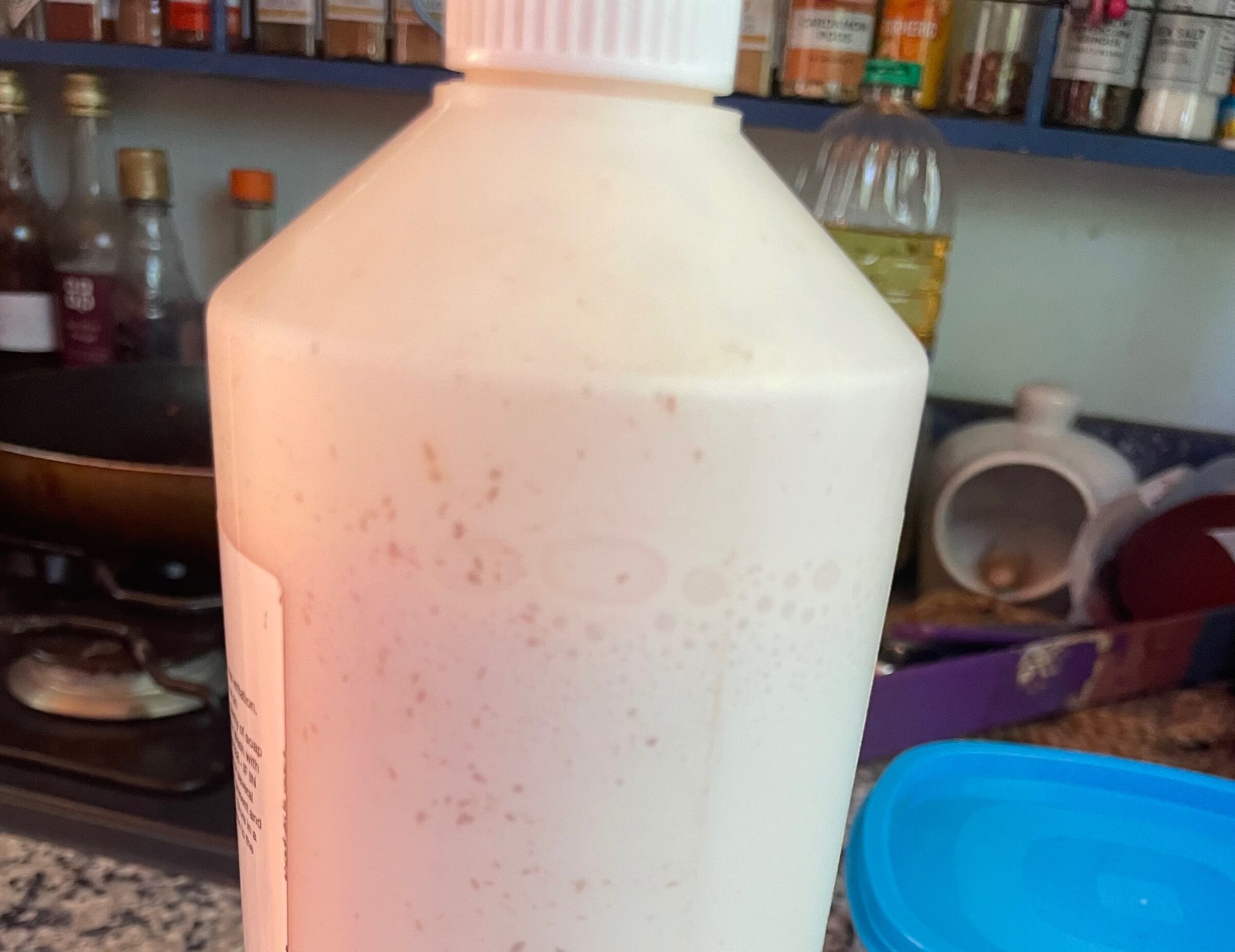

Had a very nice email from Andrew, the owner of Vactan this morning: “Sorry to hear you feel you are having issues with the Vactan. Firstly the product is made in 1000lit batches and we have not had any other customers concerned about the bits you see. HOWEVER Vactan is based on a naturally occurring powder called Tannic Acid and occasionally someone may receive a container with larger than normal amounts of undesolved powder impurities. We can send further material no problem if it is an issue.” Couldn’t really ask for a better response from a company, so there’s another bottle on the way. -

I did wonder if the fish eyes were the rust spots, but it didn’t behave like that all over the only large patch of rust on that section. Also, there are fish eyes on the test piece where there was no rust. I have had a couple of replies now from the woman who answers emails (not someone on the technical side of things, I’m inclined to think). The first one was to tell me the weather was too hot and it is drying too quickly (it does actually say you can apply up to 40° (which I just wouldn’t do, regardless)). I told her it was only 20° at 7 am, at which point she suggested the steel had retained heat from the day before. I told her I use a laser thermometer every time before I apply anything in this weather, but by that time she was knocking off for the weekend and will tell her director on Monday. So, I’m left with the decision of whether to start building up coats in the hope that it will be fine or leaving it until I get a response. I think I read that thread when I was trying to decide which rust converter to try next. Is it the one where the OP gets roasted? It’s been such a PITA even just getting a rust converter. None of the local big DIY stores currently sell it, so I had to get it online which caused several days delay (and a blisteringly hot 11 mile ride to the nearest DHL drop location yesterday to pick it up) and now this 🤦♀️ I did wonder if it was the first brush I used which was why I did a test piece with it another new but different brand brush. When that did the same, I realised the bits were in the liquid. I take your point about cleaning brushes first though – I may start doing that. I did shake it pretty well before I used it. A lot of the bits are stuck to the side and they’re not moving 🤷♀️ The reply above is mostly to you as well, but I forgot to hit the quote button. I bought it direct from Vactan. -

There are hundreds of tiny rust spots on that side. It was easier to paint the whole thing and it doesn’t hurt. -
I’m having a problem with the Vactan I received yesterday. I have contacted them, but I don’t know how long they’re going to take to reply so I thought I’d ask on here as well. I applied it to the side of my narrowboat this morning before it got hot. The steel has had the previous paint removed (hundreds of tiny rust spots), been sanded with 60 grit and been degreased. Some of it was previously coated with Kurust which I sanded off again yesterday. This morning, I gave it a thorough wipe with a fast-drying degreaser and applied the Vactan. I used a brand-new brush fresh out of its wrapper and a clean plastic pot. I noticed immediately that there were small darker dots (like paint fisheyes) appearing all over the surface where the Vactan didn’t appear to be coating as well. Initially, I thought it might be reacting with the remains of the previously applied Kurust, but it was happening where I hadn’t applied that as well. Also, there seemed to be lots of small bits in it. In order to double check that I had done everything right, I scraped, sanded and decreased another small strip of metal and, using a different new brush and a different plastic pot I tried again. The same two things have happened. After this, I examined the remaining liquid in the pot and also the bottle and I can see scores of tiny pinkish bits floating in the liquid. At no point did I return any of the Vactan to the bottle. So, as far as the bits go, that’s a them problem. However, can anyone think of something I might have done to cause this myself. For instance, perhaps it’s the degreaser? I used UPOL system 20 S 2001/5, in case that’s the issue. The photo shows the second test patch that I coated showing the tiny fish eyes.
