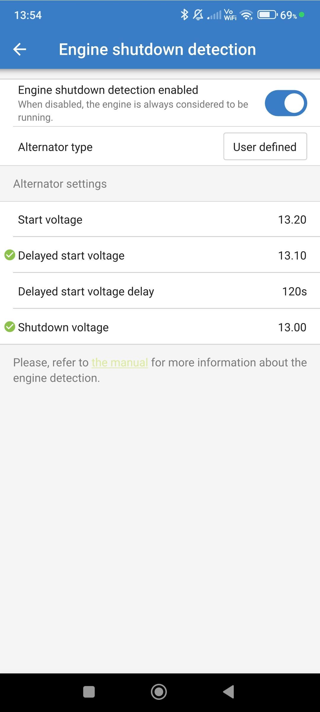

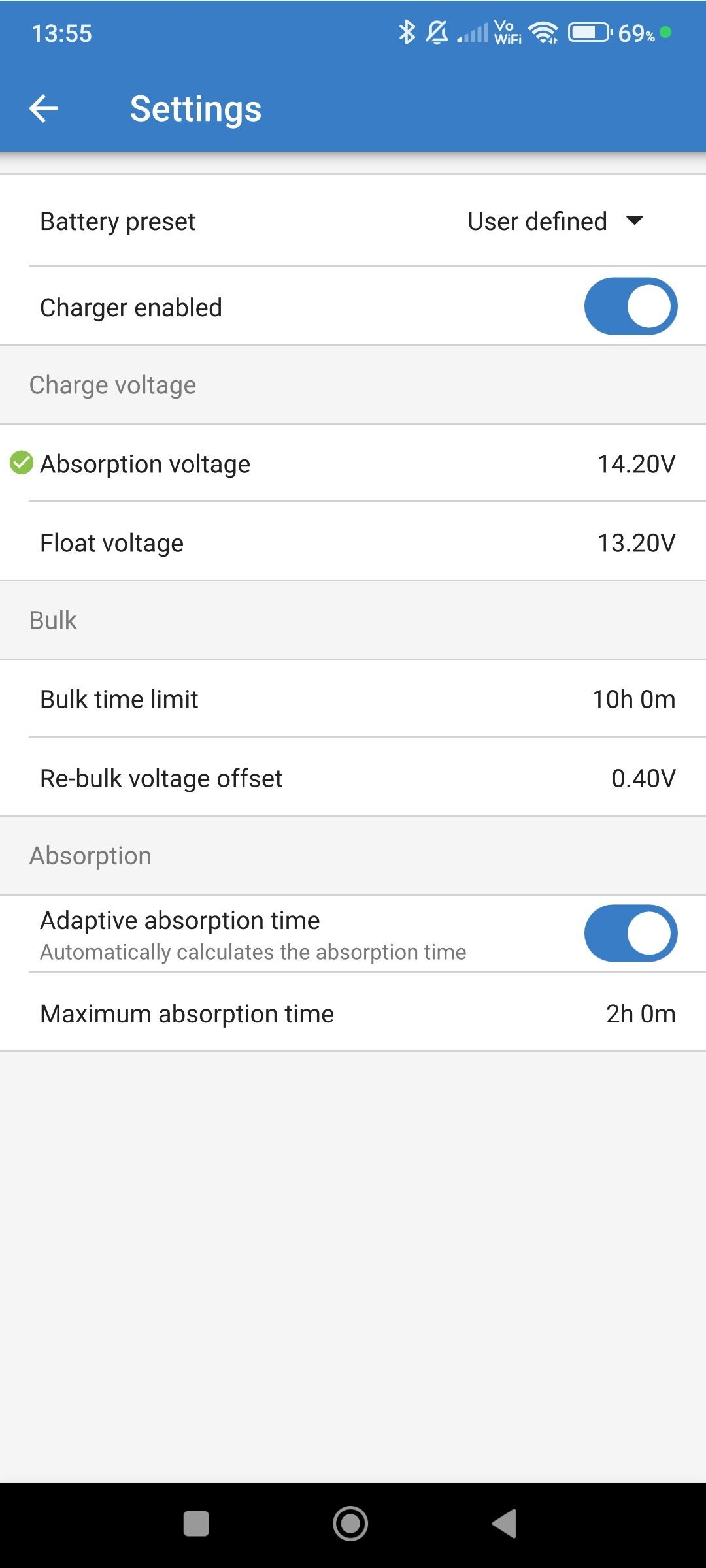

Ok got it, thanks for your help. 👍 This is what I've got now. I'm still not sure about the bulk time limit, re-bulk offset voltage, absorption time and whether it should be adaptive? On the engine shutdown it seems like the delayed start voltage has at be above the shutdown voltage which I guess makes sense.

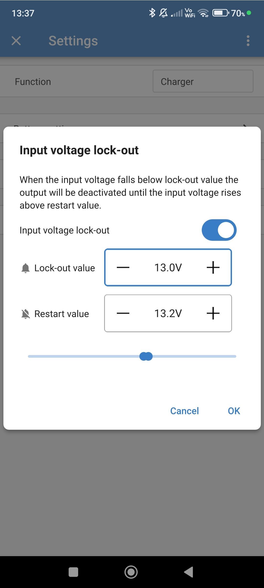

The battery is standard sealed lead acid - I think it might be a calcium type I'm not asking about the voltages so much whether I can use any of the Victron presets? I'm not sure which of their preset options is sealed LA? If I've got to put user settings in them I'll use 13.4v float - 14.4v absorption, but it's mainly the bulk and absorption times I'm unsure about and whether I use adaptive absorption. 13v being the shutdown voltage? This is what I've set. But I don't understand what the delayed shutdown voltage is? I wish Victron would explain these things. Also, why wouldn't I just use this function instead of engine shutdown detection?
Thanks, so any recommendations for settings for a sealed lead-acid battery? Thanks, I don't think I need to enable engine shutdown detection as I'm trying to charge my start/BT batteries from my lithium domestics. I will disable engine shutdown detection so that it's always on.
