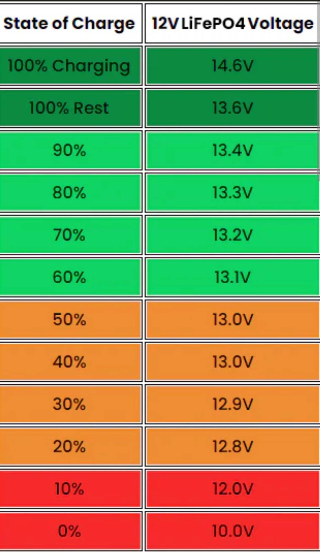

  5. Just now, blackrose said:
    Thanks, I hadn't seen that one. I was using this one from Google. They all seem to vary a bit.
    Someone with lead acid mentality drew that one! Green for fully charged, amber below 50% -shock horror, and  red below 20% PANIC!
    In reality it should be green from 20 to 80, amber 80-90 and 20-10, and red below 10 and above 90. Or something like that!
