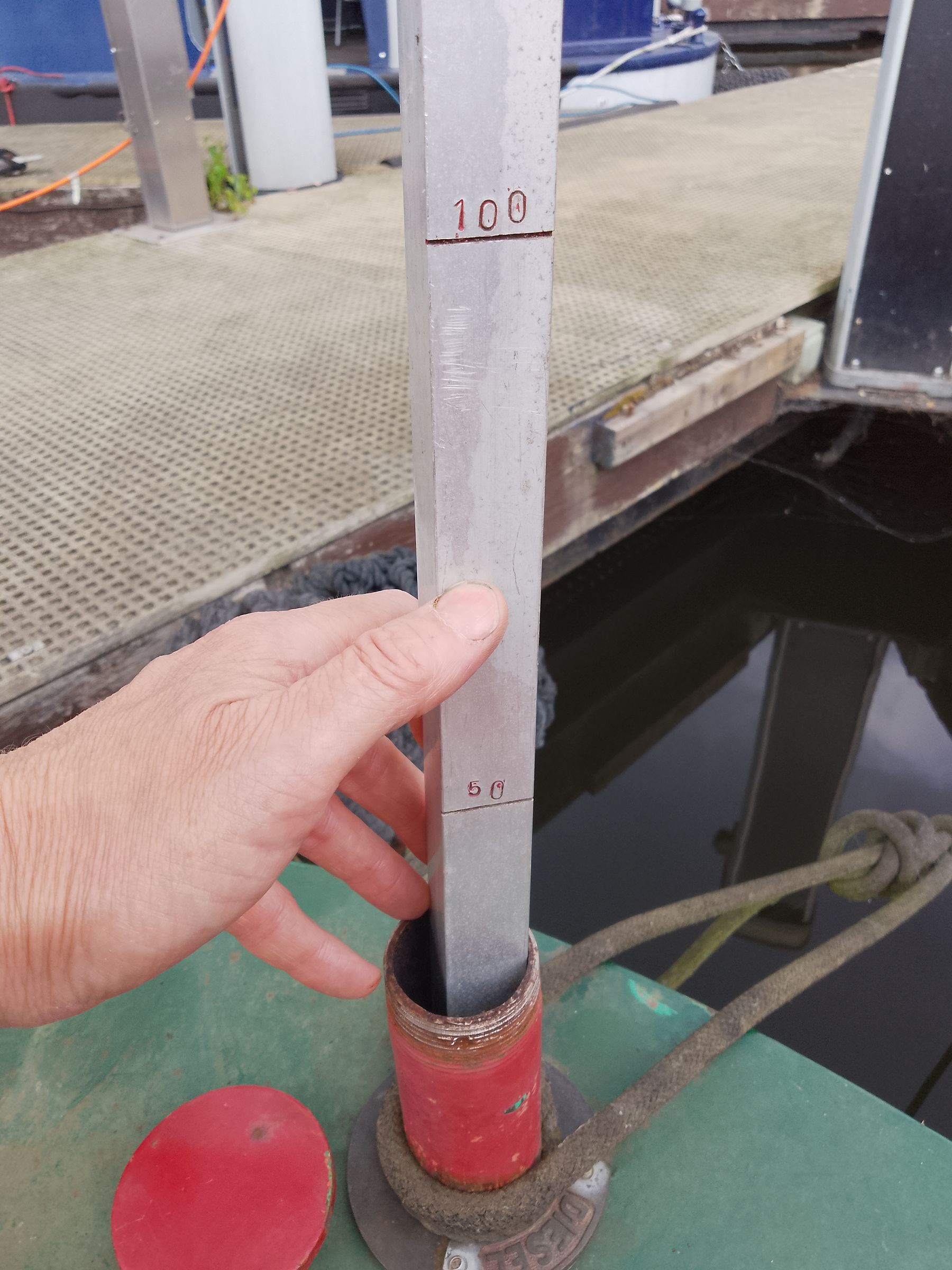

  15. 1 hour ago, Jen-in-Wellies said:
    I have mentioned this before, but it has been a while, so time for a repeat. My dip stick is calibrated from the top of the tank to the diesel surface, rather than from the bottom of the tank filler neck to the diesel surface. That way, the stick doesn't have to be dipped to the bottom to find the volume of diesel  in the tank.
    To use it, I slowly lower the stick in till I see it just touch the surface, then read the volume from the stick. In my case, this is the litres needed to fill up to the top. Subtract from 225l and that gives the volume in the tank. This way means only a tiny drip of diesel is on the tip of the stick. The rest remains dry. In this picture, the tank is nearly full. Perhaps 30l from the the top.
    Never thought of that before, it’s a great idea. Well it would be if you have a tank like yours. Our tank is under the engine with a long flexible and slightly curving filler pipe from gunnel to the tank. Which is why we have an electronic gauge!
