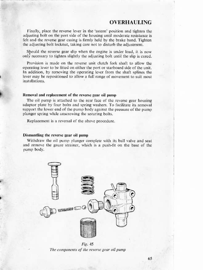

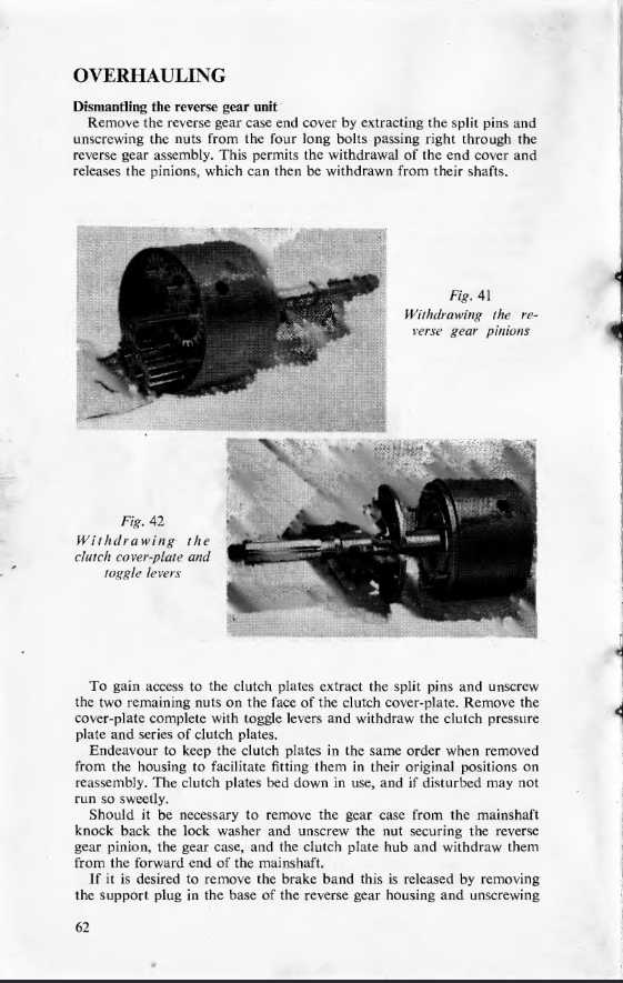

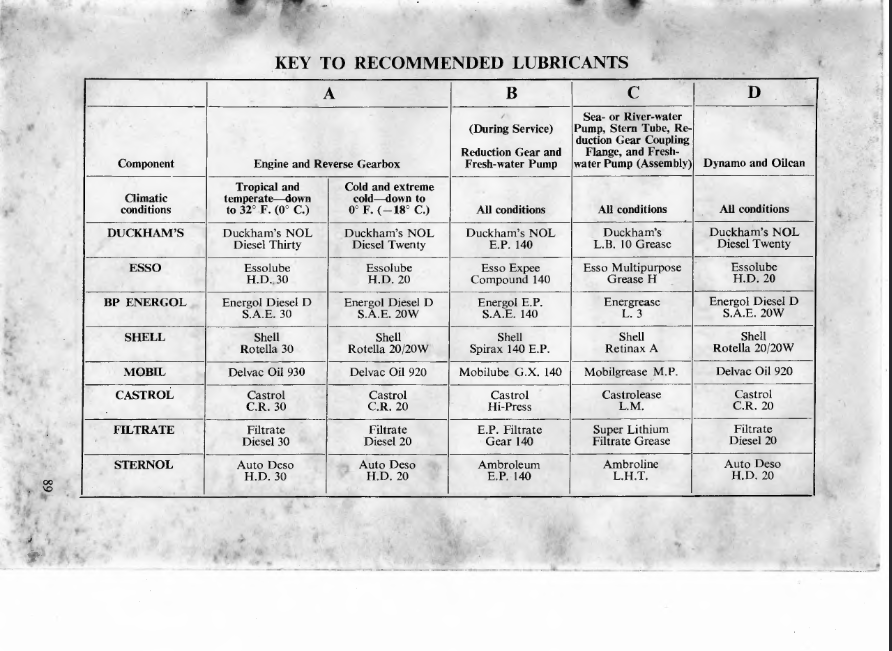

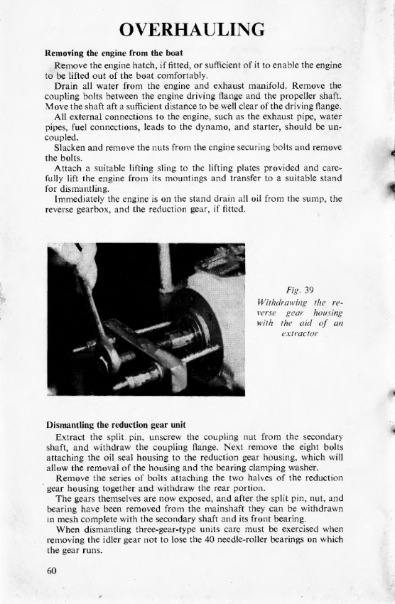

  4. Hi guys.. nice to see the info being used...
    heres all I could find in the book...
    its all abit random so check the page numbers to get it around the right way...
    important
     even though this is a cast iron box and seems "tough as" the casing is very thin in wall and vulnerable to breakage
    Great care must be used when tilting the gearbox onto its back, do not let the internal unit slid to the back of the box unrestrained or it will crack the housing and destroy the bearing housing !!
    and one more..

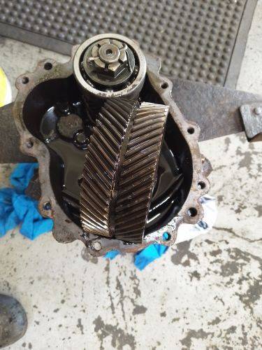

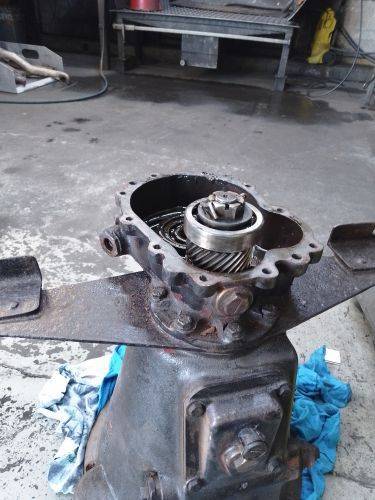

  5. 30 minutes ago, Tony Brooks said:
    It could be camera angle, but that oil seal looks very worn to me. I would expect it to have a V point where it runs on the shaft, and the shaft looks as if it might have a groove worn into it. If so, I understand that a bearing supplier may be able to supply a thin metal "shell" that fits over the groove. There is something about such things somewhere in the forum.
    yeah this is the spare that is here at home I dismantled it for a practise run... had to build a puller and stuff. I thought I might recon this plate then just exchange them on the boat... I'll have a search for that thanks Tony the pinion my be as bad or worser on the other engine and need it...

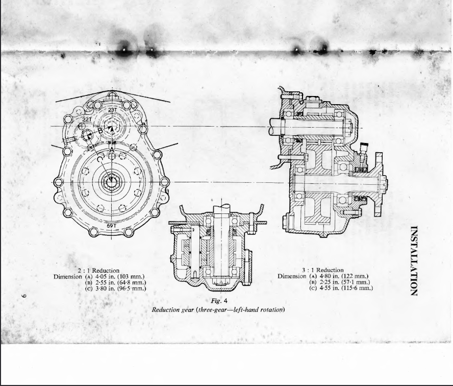

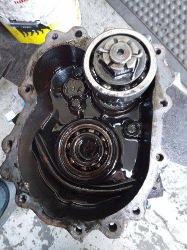

  6. 56 minutes ago, john.k said:
    Is that oil grooves to lube the planetary set?
    Yes.. the pump sits on a cam and pumps oil onto the planetary gear which then runs to the bottom of the box where its picked up by the pump again rather than spinning through oil.. looks like one of those endless threads on the inside of the pinion that carries the lube
    theres no cooling on the reverse box and I guess the oil passes to the end runs back down the box and a lot of the heat in the oil would be lost to the cast iron housing then pools in the bottom ready to go round again

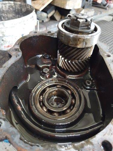

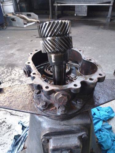

  7. finally got a puller sorted and slipped off the rear bearing, oil pump cam and adapter plate... big rubber seal on the back of the main bearing..
    I'm guessing the oil pump is pushing oil through the bearing seal and its pooling in the bottom of the bell housing and being picked up by the teeth on the fly wheel and spraying up top of the bell housing and running down the front at the join....

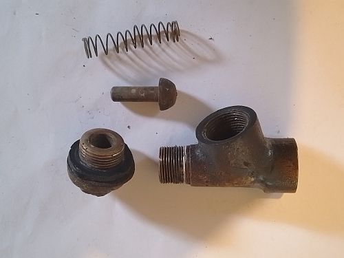

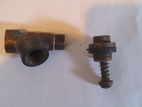

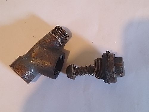

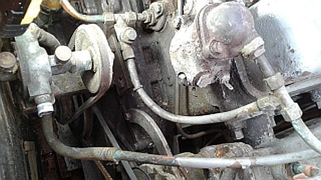

  12. You know how you come up with brilliant ideas that may or may not turn out to be so brilliant after all...
    When I set up my BMC marine engine i was worried using a closed cooling system might lead to cooling water trapped in the manifold boiling and causing a fuss, so as I had a few parts lying round and came up with this bright idea... just wondering what people think of the theory if boiling to steam is possible inside the manifold water jacket of the closed circuit cooling system or will the thermostat open before any problem...
