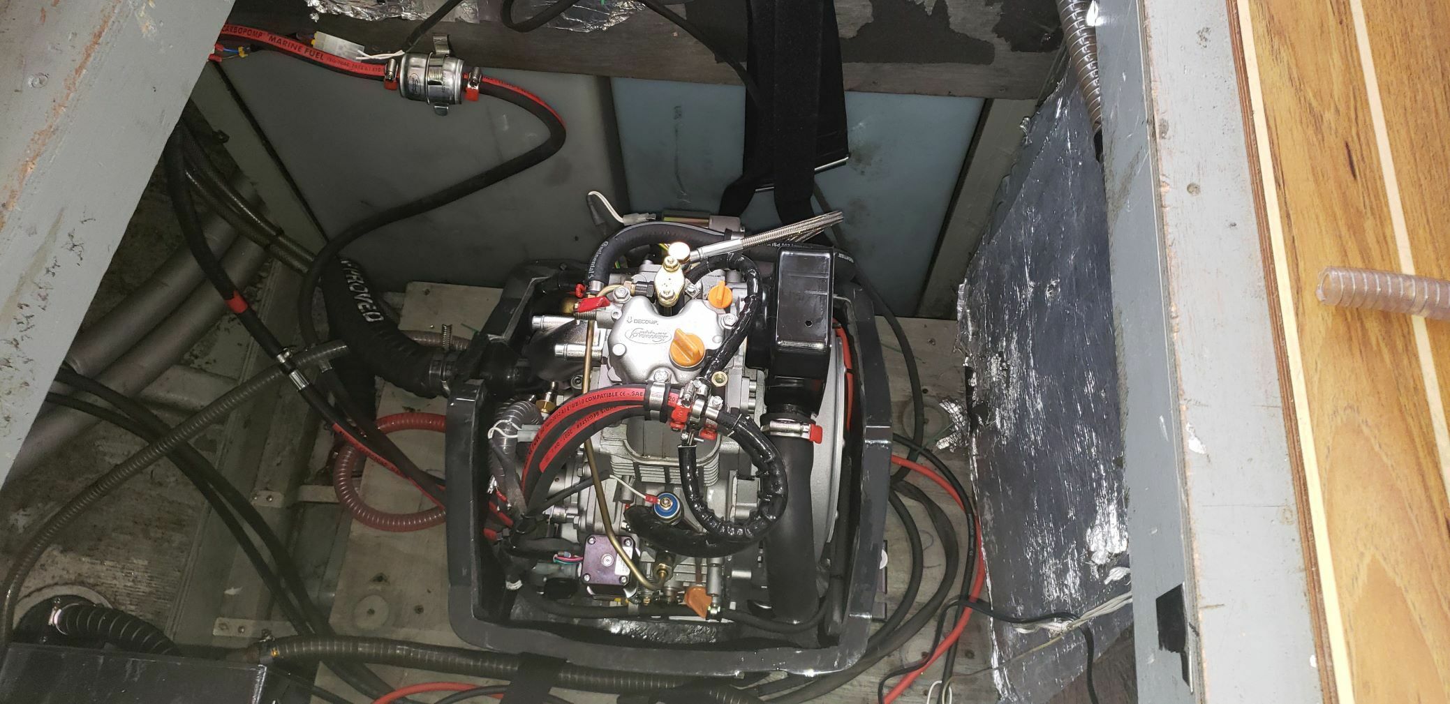

  5. Take a look at the Whisper Power Piccolo 5, it's a water cooled marine diesel, rated at 3.5kW continuous, into a resistive load, and 5kVA to allow it to start things like electric motors. I fitted one last September, it cost bout £4.5K for the basic generator, which was all I needed, because it replaced a Fischer Panda 5000i, so the exhaust system was already there. It's seems to be reasonably quiet, and delivers clean 240v 50Hz power that will run a laptop or TV without a problem. It's quiet small and relatively light. On my boat it is below the saloon and although you can definitely hear if running, but you can have a normal conversation, effectively sitting on top of it. The photo is it installed, but without the acoustic shell, which makes a huge difference to the noise. I run it for a couple of hours in the morning to charge the batteries, it's more efficient and quieter than running the main engine. One drawback for use in a canal, is the raw water pump, the impeller does not like silt in the water, it wears the impeller out quite quickly.
