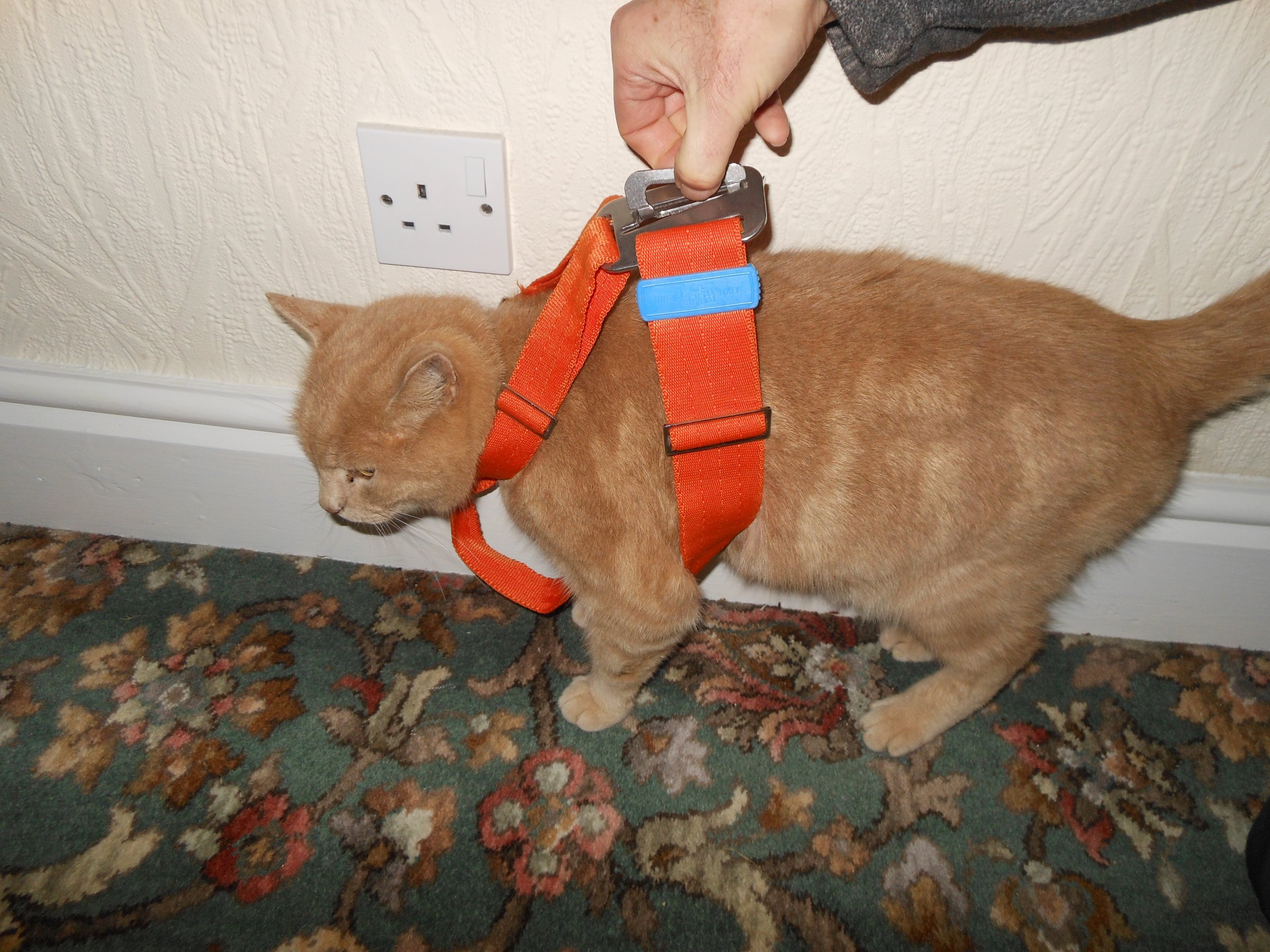

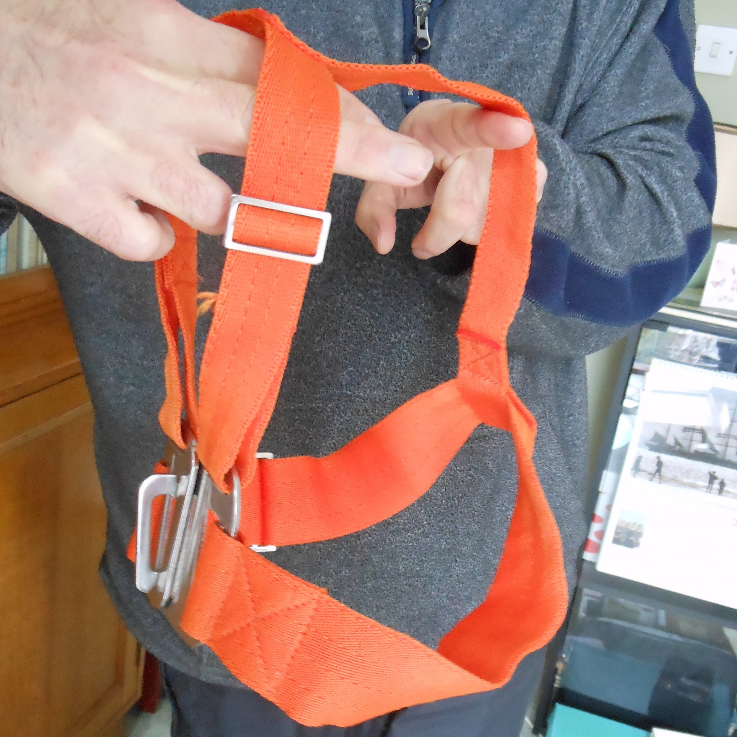

  1. But that doesn't satisfy my curiosity as to what it is! Sure, if it's a child harness it shouldn't be used. But the buckle is good and if it is a dog harness I very much doubt its integrity is so shot that it wouldn't hold a bull terrier daft enough to try to jump overboard to catch a duck.
  2. It would certainly fit on a small person that way, yes. I guess I was assuming that the clasp was only the right way up when the writing was the right way up (it says Italy on one piece) and the wider end of the buckle was at the top so that the clip to the line was not pinched. I could do more pics to illustrate but basically the clips that came with it were nice strong ones that fitted through the wide and of the buckle but not through the narrow end.
  3. I really don't see how a child would fit into it... If you put the clasp at the front and the front straps at full extension over the shoulders, there would be a great long loose loop down the child's back.
  4. I bought this at a charity fund-raising stall at a canal festival some time ago. It had a standard clip-on safely line securing it - single clip on the harness clasp - two lines (to two clips) for fastening to a running line, maybe. It's a Trem harness so it can't have been cheap when it was new! After fiddling with it for ages I've come to the conclusion it must be for a dog! Can anyone confirm that that's what it is? Or tell me what it really is... :-) As I haven't got a dog I'll probably donate it to the next canal-related charity stall I see - but it would be good to be able to put a label on it saying what it is! :-) The second photo shows how I think it would be fitted, though my cat is the wrong size and shape (and way too grumpy) to model it very well!
